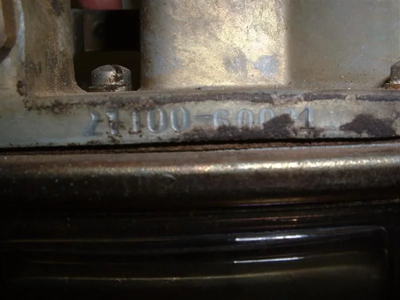

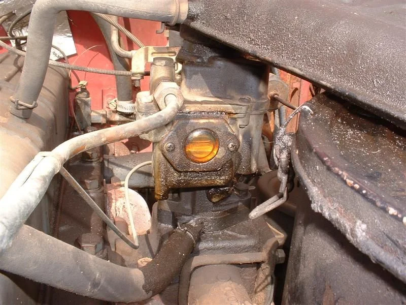

I am going to be rebuilding the carburetor and in doing a search for a part number, it would appear I am supposed to have a large window carb???? Am I reading the date correctly 1 G 15 (1971, July, 15th?)

What the heck is that LOL

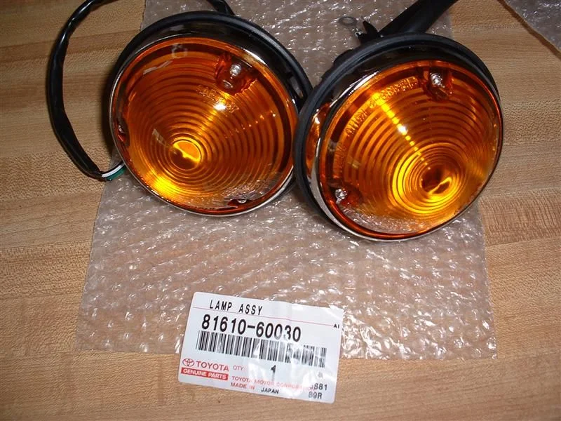

I have several parts on order and working on getting the correct carburetor for the truck. In the meantime I removed the blinker and 4wd dash indicator lights, cleaned, polished and reinstalled them. The dash cleaned up pretty well, I removed the old ash tray and glove box panel and replaced them with parts from my 63 FJ40. (First pic is a before shot)

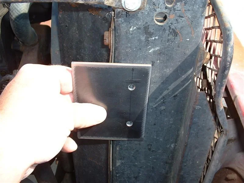

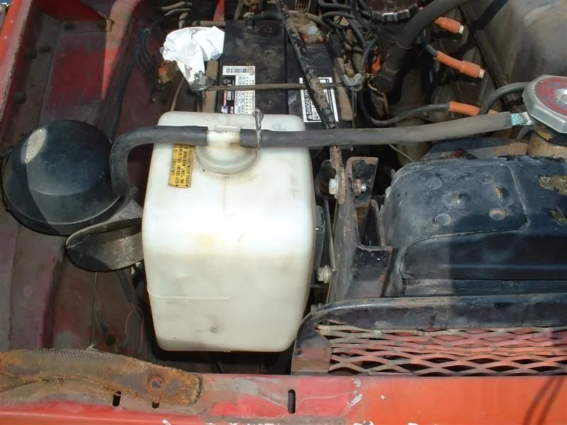

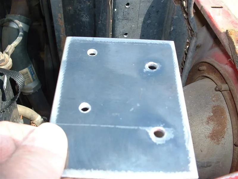

I am following Dom's lead and installed an FJ60 radiator overflow bottle. I fabbed up a simple bracket to mount the bottle on the radiator core support. I used .120 sheet metal 3" wide 4" high, drilled 2 holes to mount it on the core support then drilled and tapped 2 additional holes to mount the bracket from the bottle to the plate I made. This looks a lot nicer and cleaner than what was there before, and it is all Toyota, well except for the metal bracket I made.
