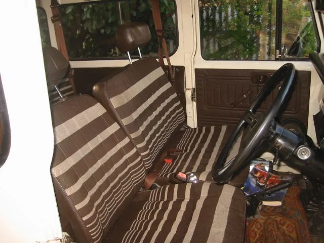

60/40 seats with headrests
G'day Kevin,
Didn't want to hijack Jason's thread. Here are what the 60/40 with headrests look like. These are from an LX, but they also make them in grey vinyl. jsaltlick had a set out of a troopy, but he may have sold them.

That looks like it'll work. They're LC, thin enough, have headrests and will take 3 sets of belts. I assume I could find them in LHD also. Is the driver seat fairly comfy? My old 81 mini P/U had seats from a Honda Civic SI. Sport buckets with lots of side bolstering made for lots of support - very comfy. I'd sure like to be able to squeeze a third body in when I had to, but I also want driver comfort as a priority in a DD. I need to do some seat research to see if I can find other Toyota seat options - I beleive Toy seats will have the best chance of fitting the limited dimensions of the cab (plus they are Toyota ). My dear old mother had a Tercel 4wd wagon years ago - that thing had comfy buckets...
Obviously I haven't come to a firm decision yet .
Crazy thought - how about the 60 part of the 60/40 and a single bucket fot the driver

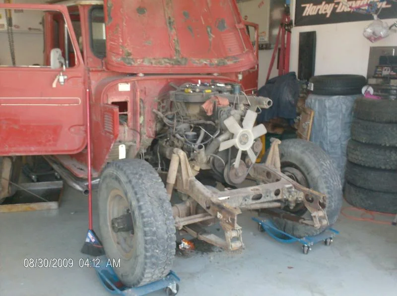

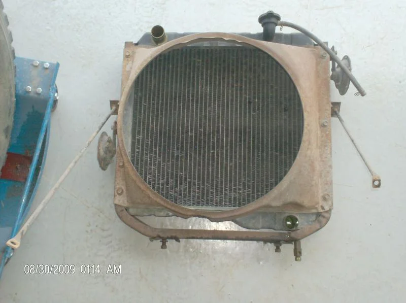

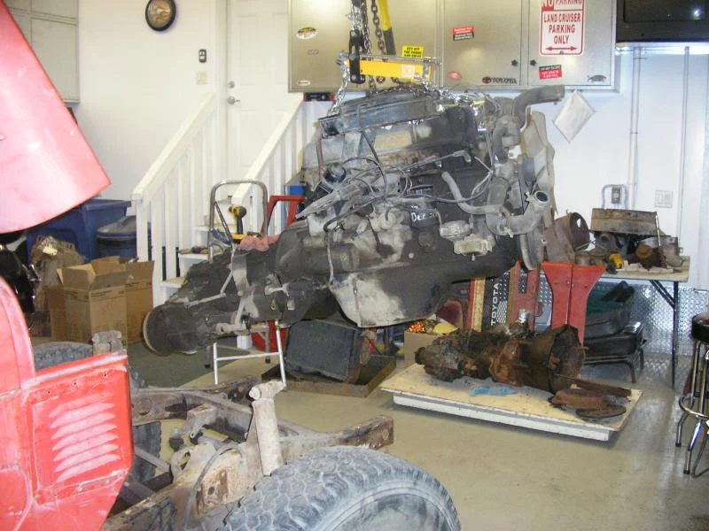

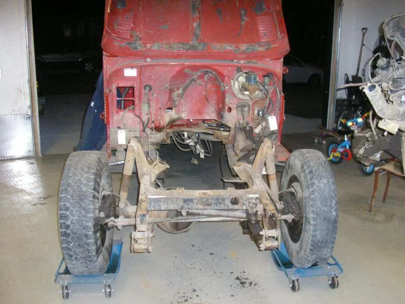

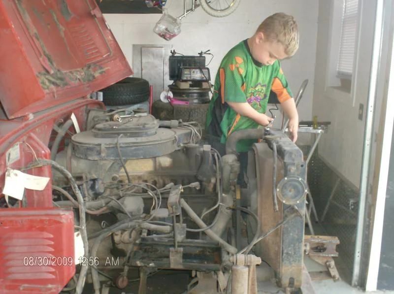

So I figured I had ignored my 45 long enough. I got bored on Saturday and started cleaning the garage and found myself starting a chronological "to do" list for the 45. Next thing I new I had removed the front clip in preparation of dry fitting the new fenders I will be getting in a couple of weeks. I want to fit the front clip nice and straight so I can finish fabbing the front brush guards and tie them into the bumper and sliders.
I took my time and did the bag and tag for all bolts and parts removed. Also tagged every wire that was disconnected. This 2F/4spd will be going into my brothers '71 40 so I had to separate the stuff I was keeping from stuff forwarding to him. Anything that got in the way was photographed in situ, removed, bagged/boxed for future refurbishing cause it all has to come off for body blast and painting.
This is just before I shut'er-down Saturday evening.

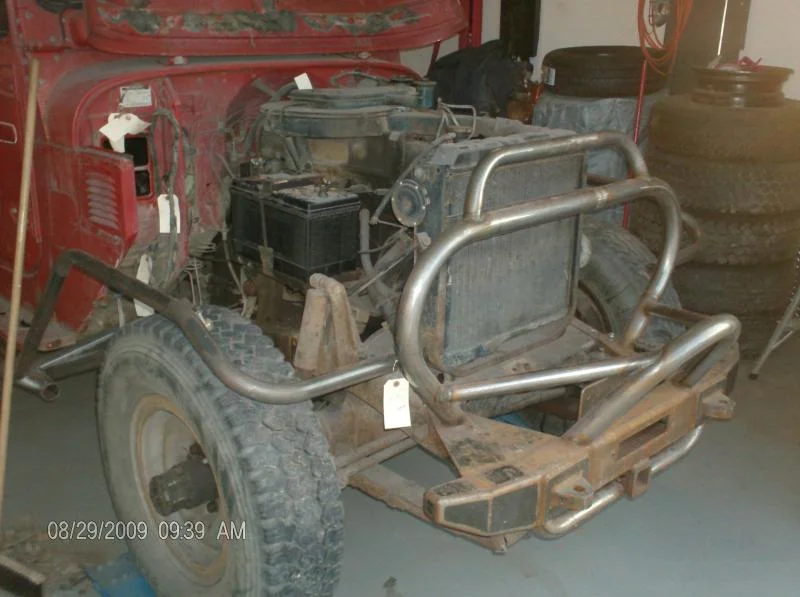

Here are some more shots from Sunday
My chief mechanic took care of the rad starting at the top hose

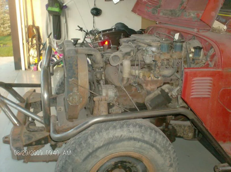

I can't use anything off this engine with my 3B so everything gas related was left connected to the motor (coil, e-brake cable, rad hoses, air filter housing, heater hoses etc.) In this shot only gravity is keeping the drive train in.

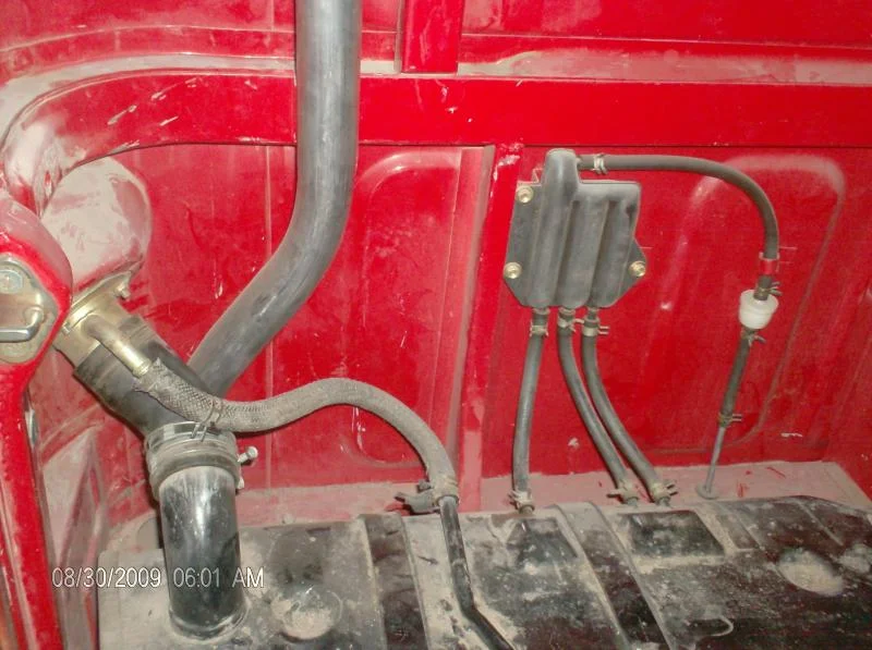

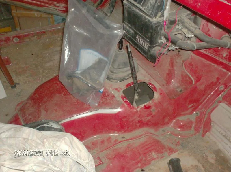

A few more
To remove the tranny it helps to remove the tranny hump. To remove the tranny hump you have to remove the heater and the fuel tank as well as the go pedal. Oh well, its all got to go anyway.

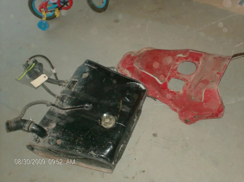

Drained just under 5 gallons from the tank through the plug under the cab. A bit of a PITA cause the second you crack the seal you get gas... fast. So as its dribbling out you try to remove the plug right? well the gas runs down the wrench you stuck between the catch funnel and the underside of the cab, soaks your glove, runs down your arm... anyway after cleaning up the mess I still wanted more than a trickle so I wrapped a rag around the wrench to stop the fuel there. I don't get why that plug has to have like an inch of thread on it - it was leaking fuel after a half turn from tight.

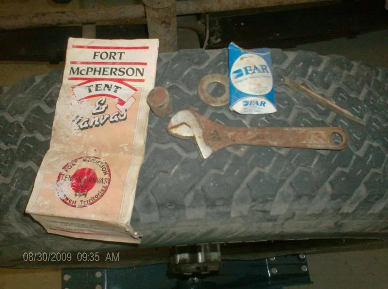

The last time I refurbished a Toyota I found a nice 6" diving knife. This time I got a 6" adjustable wrench, a new tooth pic, ear plugs and a flyer for Fort Mcpherson Tent and Canvas

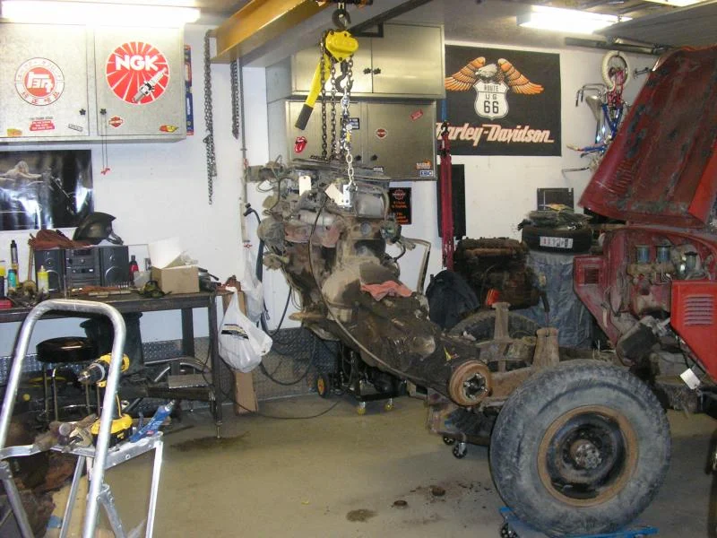

Pulled the 2F out tonight. I have a 4 wheel engine dolly that I hope to be able to set the 2F/4spd/t-case on once I assemble the dolly. That way I can roll it around as needed. For now she's just hanging from the ceiling. The chassis rolls around much easier without that lump of iron in it.

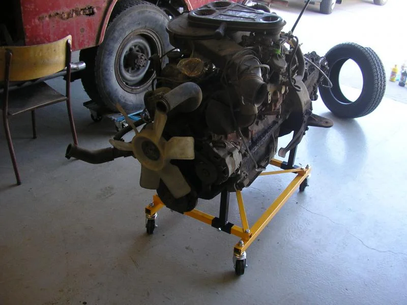

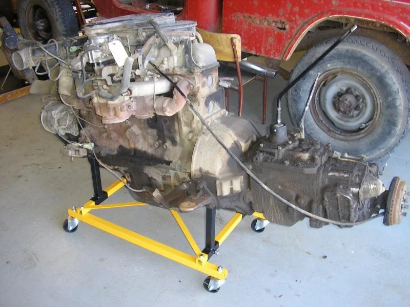

Got the 2F off the chain hoist and onto a 4 wheel dolly for storage. Thats all I did today on the 45

Hey man, looks like you've taken over the whole garage. What did you do, buy a bunch of taxi vouchers for your wife so she doesn't have to get into a cold car in the winter?
I need to get down and look at that thing again. Are you home all weekend?

And its her Rav4 too! Actually when I pivot the bed against the wall the Rav fits in.
Looks like I'll be home all day tomorrow but Monday I want to run up to work to do some welding.

I really like that cradle! How does it hook up to the engine? Gravity or bolted?
Mikesta is offline   Reply With Quote
Old 09-06-09, 09:11 AM   #210 (permalink)
Site Addict
Awl_TEQ's Avatar
Join Date: Aug 2008
Location: Calgary Alberta
Posts: 1,156
Gravity - its pretty secure, doesn't wobble when you shake it. Its just 4 risers adjustable in width but not height. $39 at Princess Auto (our Harbor Freight). Its thinner wall tube than I would have made it from but for a single use tool it'll do fine.
