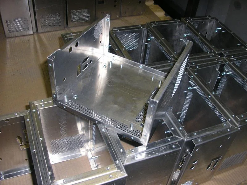

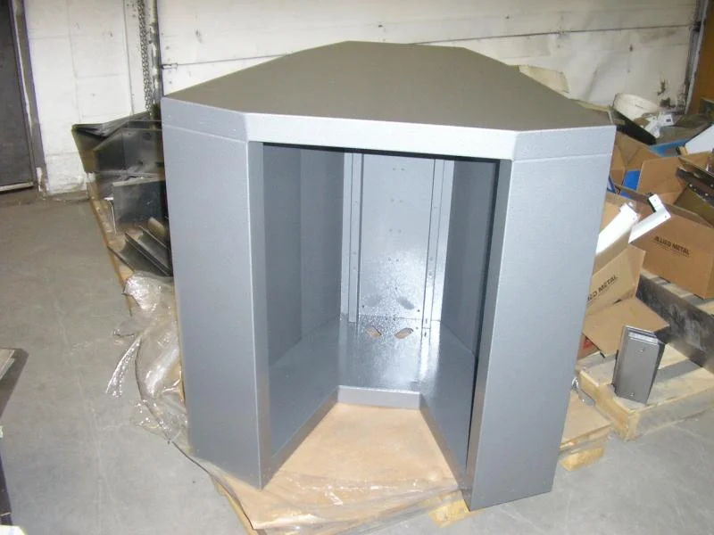

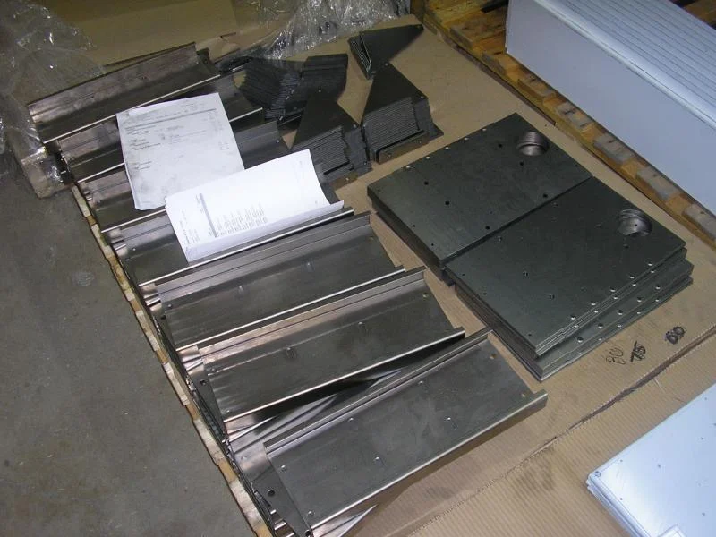

Took some pics at work

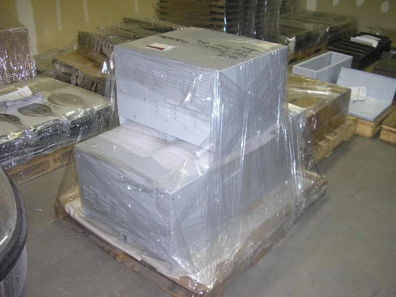

These are steel enclosures for electric motors and A bank of capacitors - I don't know what the application is..
These end up being steam heater cabinet parts for hazardous location application

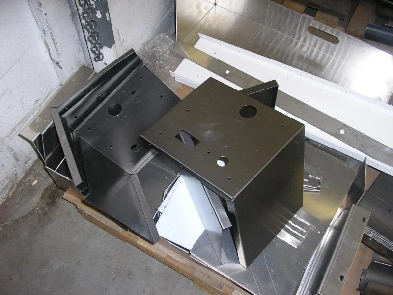

These are parts of an air conditioner system for P&H strip mine shovels - all stainless

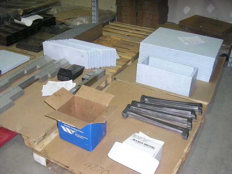

Lots of cool stuff. We often don't really know what the end application is but it doesn't matter. We don't normally design the parts ourselves, we just build whatever our customers draw up, though we often tweak the design to keep the cost to our customers reasonable. Engineers and designers often don't know how things are manufactured and therefore don't know the limitations. The only real limitation is cost. You can make anything if you have enough money for the tooling required.

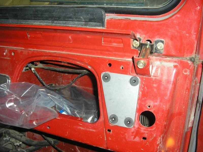

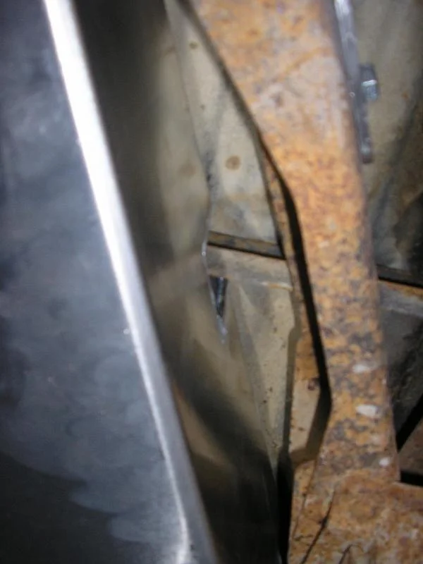

A couple of shots of my puttering with the roll cage. This is a 1/4" plate with counter sunk bolts on the outside and another 1/4" plate of the same shape on the inside with nuts welded to it. Eventually the outer plate will be the anchor point for the A pillar tube and the inner one will mount the tube that runs down to the floor. The drivers side mount required the relocation of the headlight switch - I'll likely put it where the choke is as I won't need to choke the 3B . The passenger side required a trimming of the glove box wall which I will finish out and clean up while doing the tub bodywork. The large holes are for the side window defrost vents which I had to miss. Also, I will be running a tube across the dash to connect the two A pillars. This will require removing the dash pad permanently and replacing it with my own custom dash pad that opens up for storage.

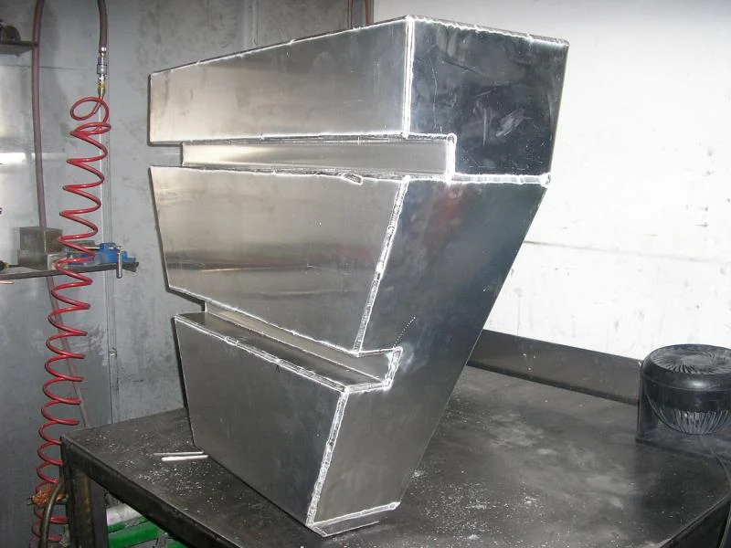

A blast from the past

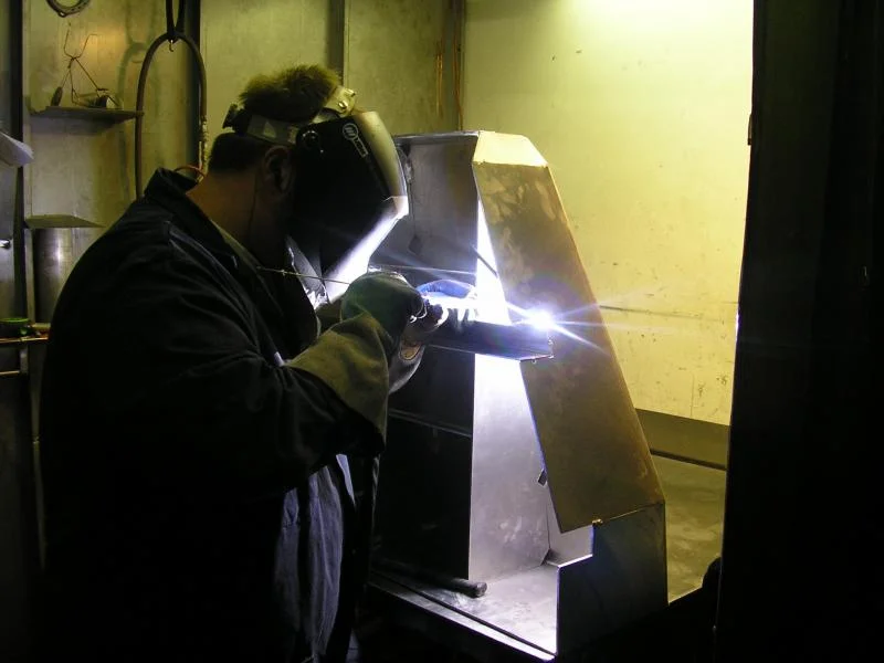

I haven't touched this tank in about 8 weeks but I had some time after work today and my welder was willing to stay and weld it up.

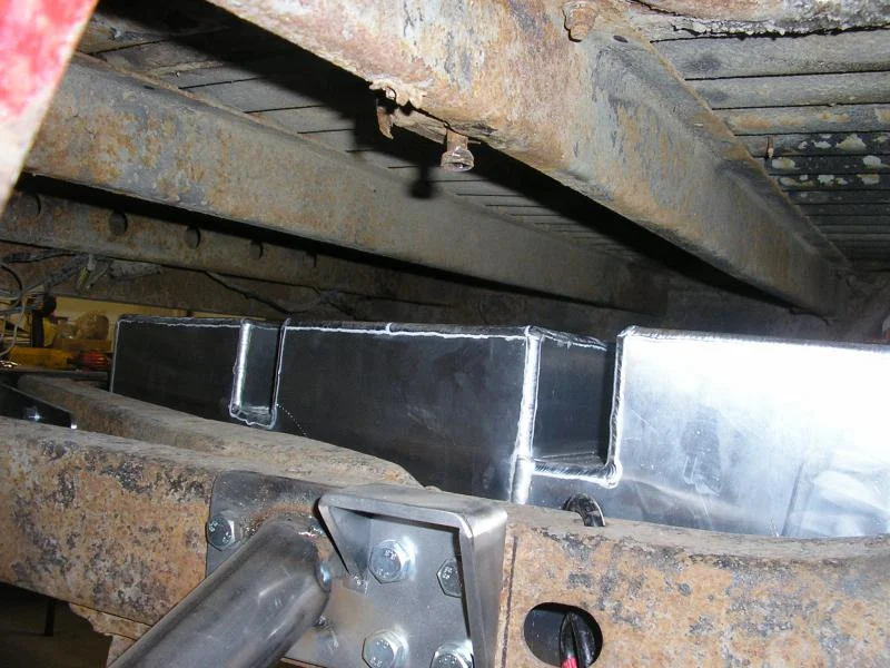

I tacked in the antislosh devise. My very first melting of aluminum
These are not my welds. My welder Shawn ran these beads on the inside of all the seams. The tank is made from one piece with a top added. That makes no welded seams along the bottom edge.
Ready for the top

Shawn just bought an old VW bug he is going to rally race and needs bunch of sheet metal work so he's trading his skills for mine.

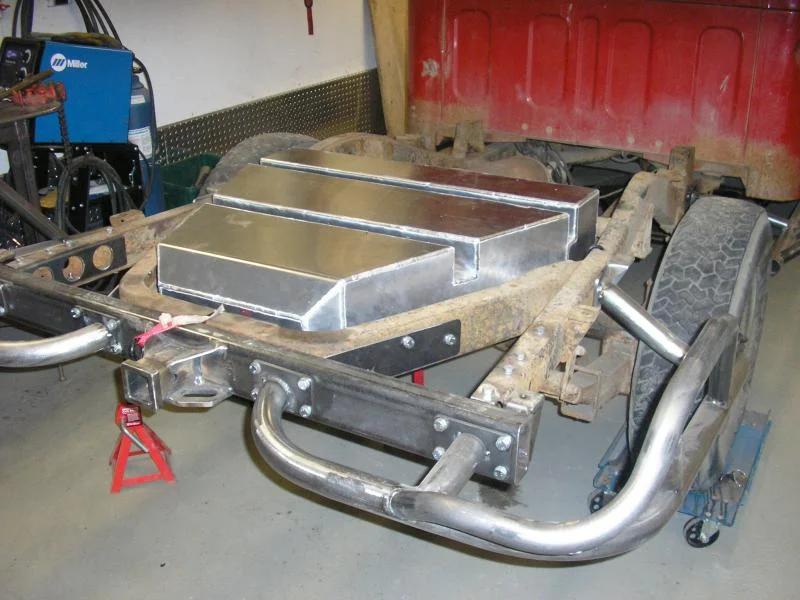

Tank is done - at least until I make the mounting brackets, filler, drain, draw, sending unit...

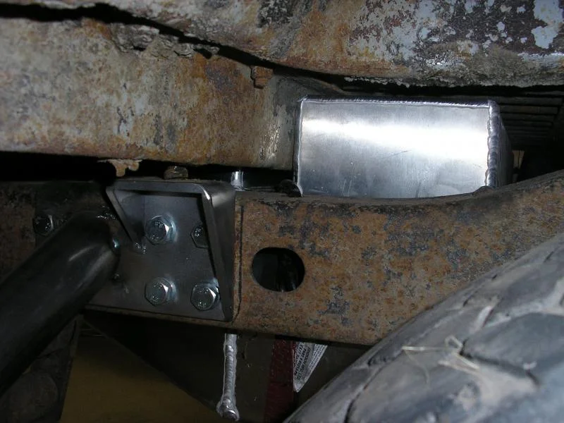

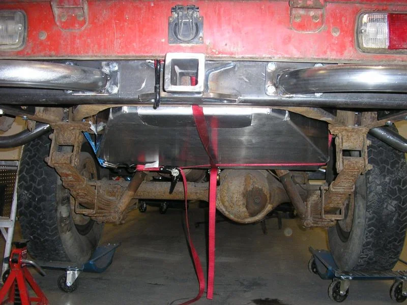

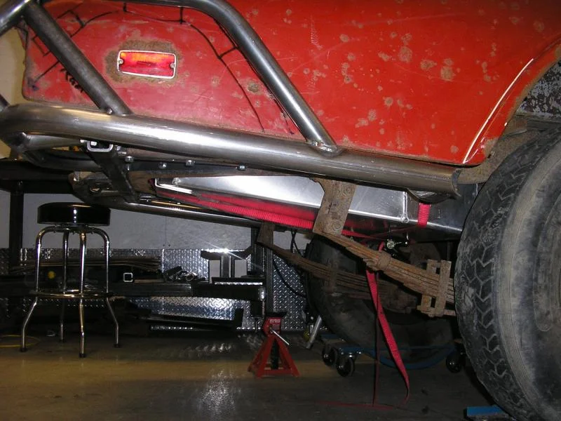

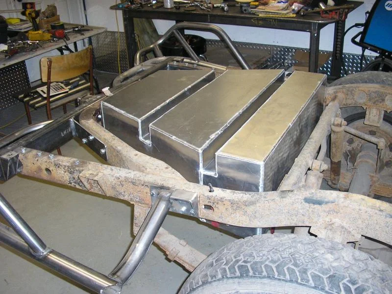

I'm working on mounting the tank - or at least making sure it fits .

Last one - side shot.
I could have made it hang down more maybe...

Kevin,

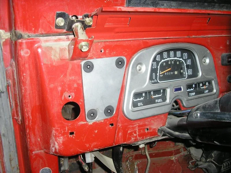

Judging by the location of the roll cage, I guess you are no longer putting a factory tach in there?
Also, are you worried about the tank hitting the bed rails when the frame flexes? It looks great, and I am damned impressed with your fitment- but that is all I would worry about. I want to have you make one for Patches... Then I would have three tanks...I think I would have to have a fuel tanker licence to drive her.
Cheers,
Josh

The tach wil go in there somewhere, I think .
I have an overhead console in the plans but hopefully I can find a spot for it in the dash. The overhead console is for pyro, boost, air system pressure, oil temp, radio, DVD/GPS, extra gear switches, rocket launcher etc. It will be part of the cage and all wires will be hidden so the roof/ rear wall comes off easy.
The tank is at least 3/4" from the frame all the way around and I will lower it till it clears the bed by a safe margin. It's just strapped in for now to get it off the floor and out of the way.
I'm at work programming bed parts... here's the front wall of the LWB bed.

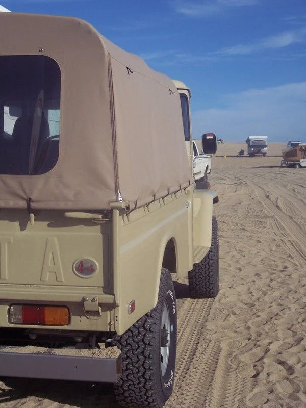

Wow came across this thread and really dig your build.
I built that FJ45 years ago, turbo diesel, five speed, disc brakes all around...
Local boat top company made the rear top and the customer wanted the roof same colour like the early FJ45s came from the factory.
Thanks Radd
Love the top on that unit. I'll have to hit the coast and visit my bro in Victoria for a maiden voyage next summer. That'll make him green, especially with his 71 40 sitting in a local hangar with one flat tire. My liitle guy wants to see that steam locomotive in Duncan, I think that's where it was. Couldn't stop there last year on the way to Tofino.

Join Date: Mar 2006
Posts: 695
WOW that is ONE VERY slick gas tank..... careful, your going to have people asking you to make them one soon.....

Quote:
That's already happened. In fact it happened as soon as he started talking about an aux. tank.

24 - when I get done with the bed reproduction I'l be back on my cage and that aux tank we were talking about.

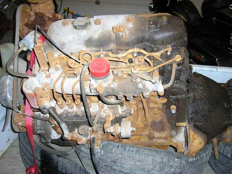

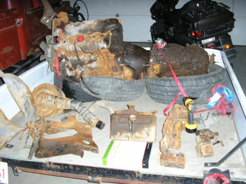

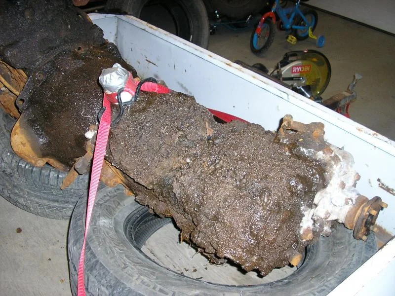

This just in...
whats left of an 83 BJ42
3B core for rebuild
err... well lubed? 5spd and split case

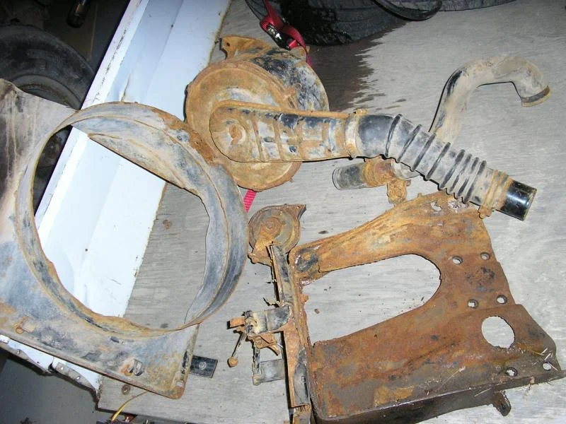

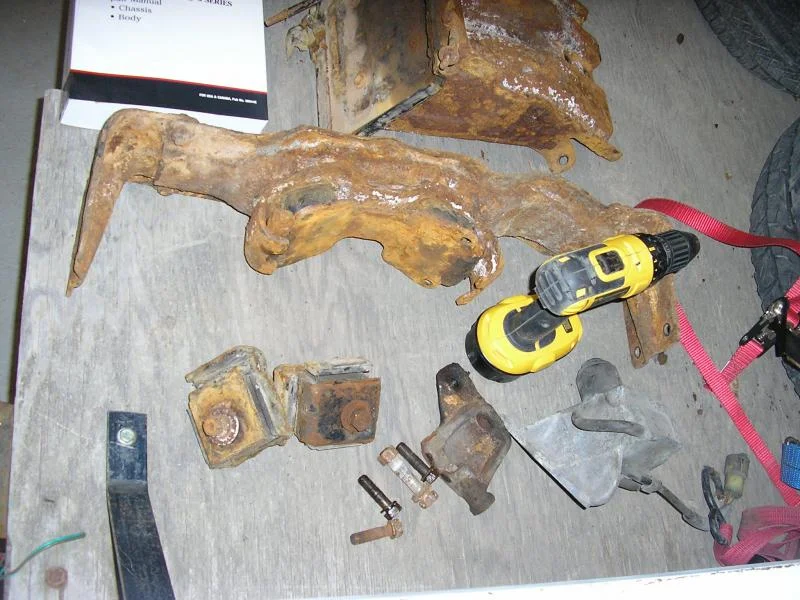

top to bottom - manual, one battery bracket/tray, tranny crossmember, decent motor mounts, alternator mount, 12V EDIC motor
Air cleaner assy, fan shroud, second battery bracket/tray
power steering pump

I did get one part I don't need to clean

Jesus Kevin, what do you people do to those Cruisers up there; pack them in salt?!

Potash actually. I was a little hesitant to post pics for fear of being ridiculed as a sucker but I know the supplier personally and have no worries I'll get my monies worth out of it. This one was underground. She's pretty rough but for the price I figured what the hell, I'm gonna zero time the motor anyway... My supplier has several more (some in much better shape, not all from underground) and has guaranteed a complete motor one way or another for the money I have already paid. I'm really just looking for a good block from this and we'll see what else is salvagable. The H55f has the forward? shifter location and should fit nice. Split case transfer box is cool too. I've got all the mounting brackets and crossmember - I just have to mount them and this drive train will slip right in. I'm gonna wash it down and mount everything before stripping the truck to the frame for coatings/ bodywork/ drive train rebuild etc.
But first - the bed project needs to come to completion...
