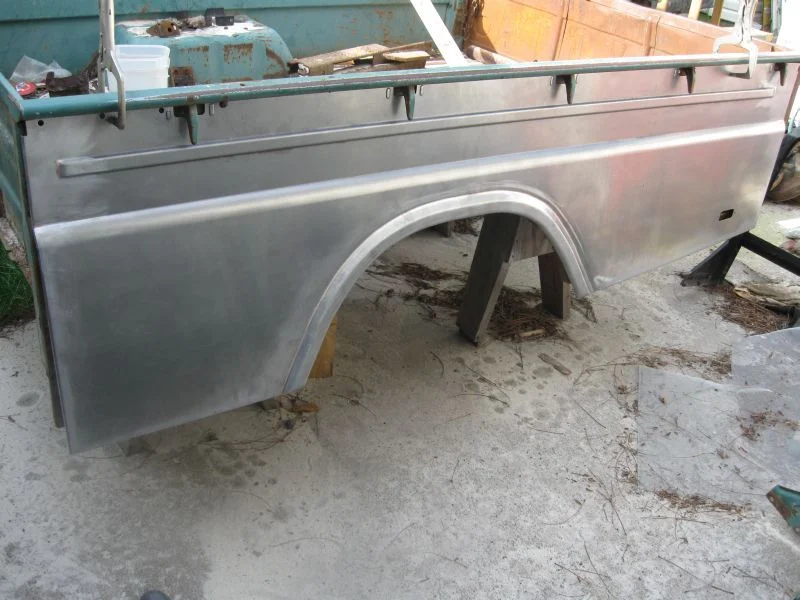

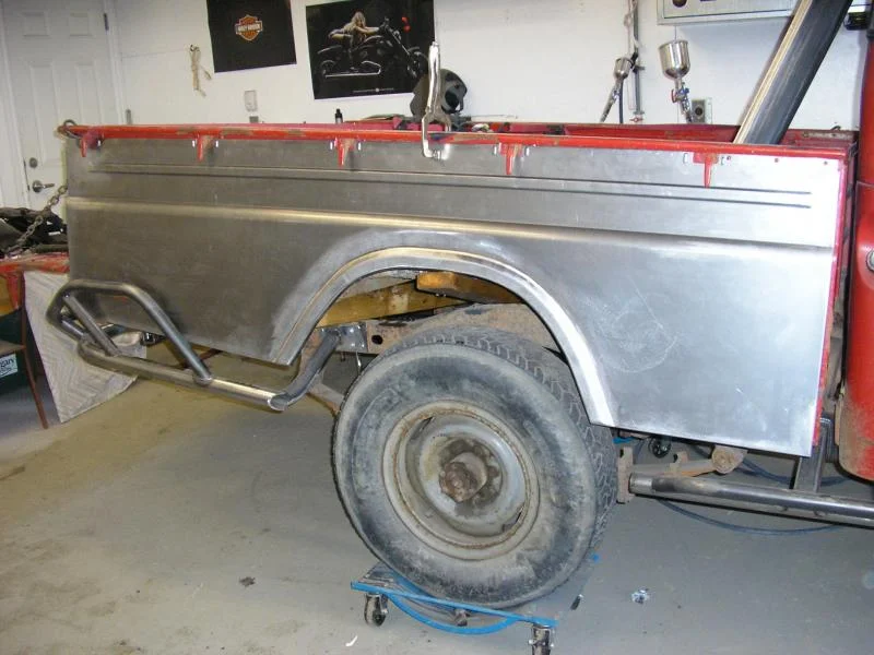

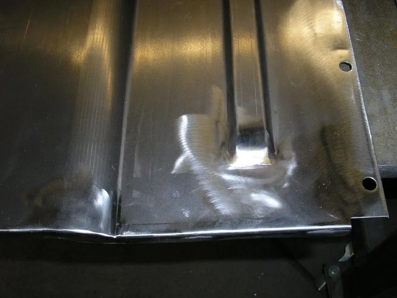

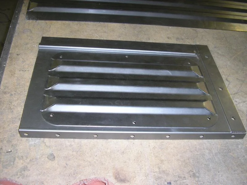

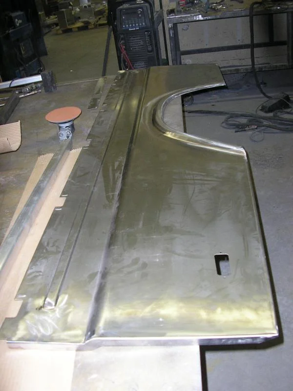

Some pictures of a side panel after grinding and sanding the welds down. Those of you who end up using some of these will just need to spread a thin layer of filler over the arch area and at the ends to fill my sanding marks and any misc little low spots etc. I'm not a body man but I would have no problem making this straight to the eye when finished and sitting in the sun.

That's nice! I can't belive how fast you came up with a final product. Very nice work. I'm sure you are making a lot of folks very happy. I know I'm happy just watching

Quote:
Originally Posted by Awl_TEQ View Post
Did you fill that with something? How did you get rid of the weld marks?

I used silicone bronze TIG welding rod. The rod is called Everdure locally here. It melts at a lower temp and allows you to put less heat into the parent material. Less heat means less warp. It is also a bit softer than steel and easier to sand and grind away leaving it smooth. The steel just barely melts and mixes with the Everdure so there is some penetration to the welds to hold sturdy after sanding off the bead. This application is purely cosmetic and should hold up good to vibration and road shock, espeacially when you take the rest of the bed structure into account.
Everdure.... Hmmmm. I will see if we get something like that over here as well. .

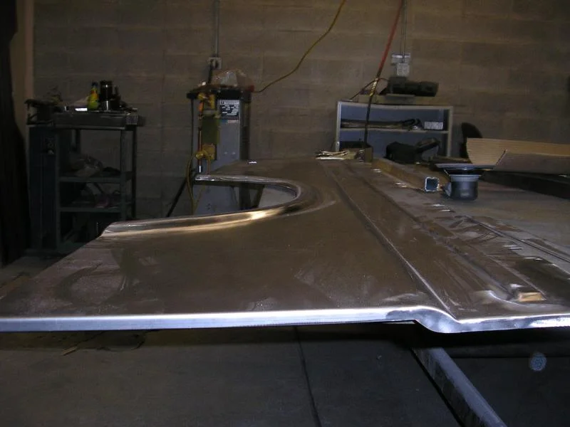

Some teaser shots

more...

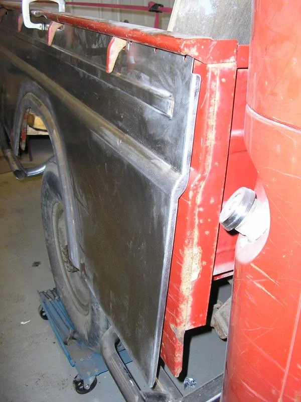

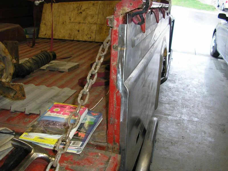

I ordered a set of these box sides as soon as Kevin said he was going to make them.Today we met and the new sides are here.
Kevin is a craftsman.These panels are well built and look great.Great quality! I copied the pics above with some of my own on the drivers side and it looks like it will be an excellent fit.
You can see that my sides have issues but that problem is solved. My biggest challenge will be making the rest of the truck look this good.
Thanks again Kevin.

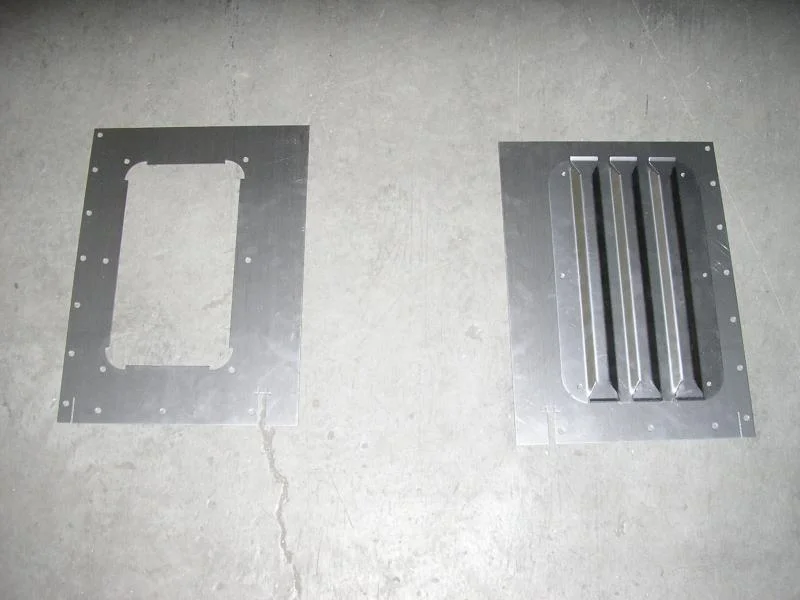

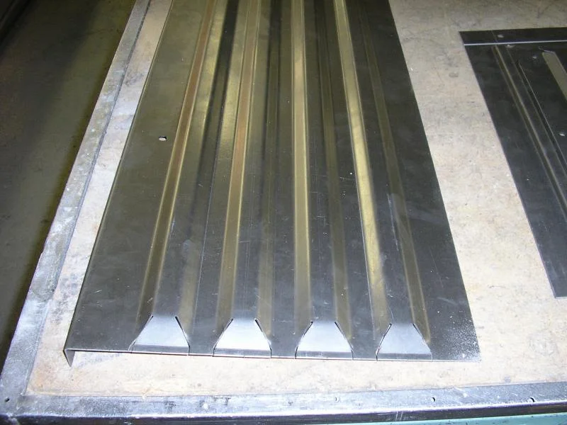

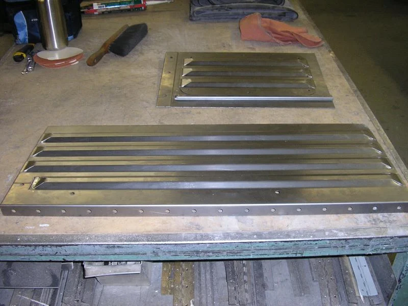

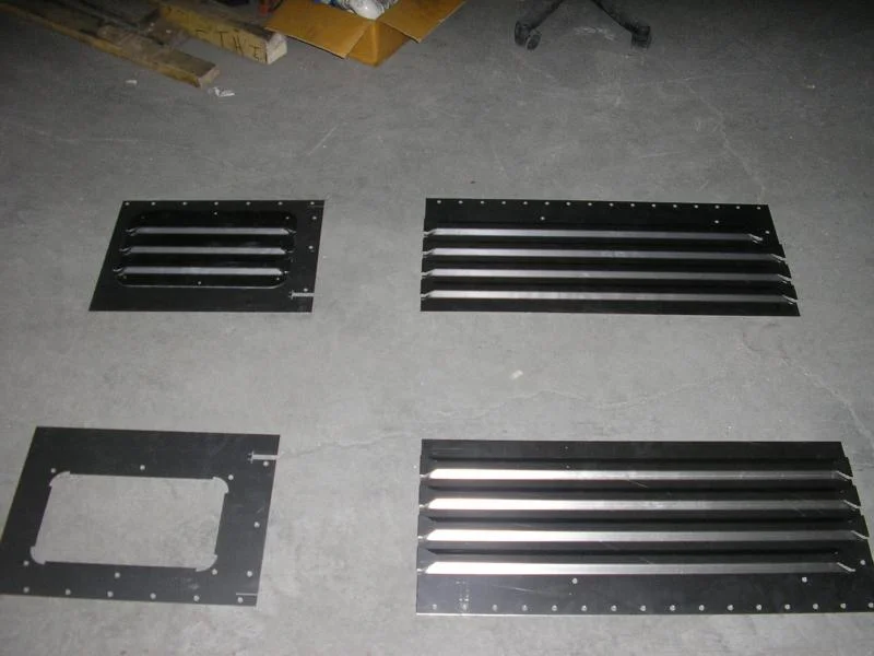

Progress
They are not done yet but here are the front and rear corner sections of floor. The string of holes down the outside edges will be a flange bent down. The holes are pre-drilled for welding as a spot weld (plug weld, rosette weld) to the side panels.

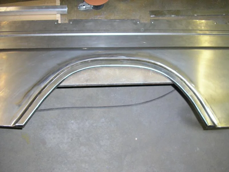

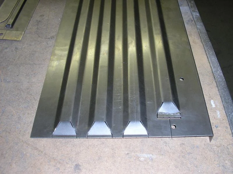

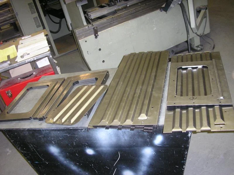

In the foreground is the right rear corner section of floor. Its not welded yet but otherwise done. The string of holes is to plug weld to the side panels.
This is the tailgate end
This is the end of the panel that abuts the wheel hump. To reduce the warpage from welding all of the slits the full length I shortened the part by 2.5" and will weld a strip on that includes the three holes to bolt through the wheel hump and crossmember underneath.

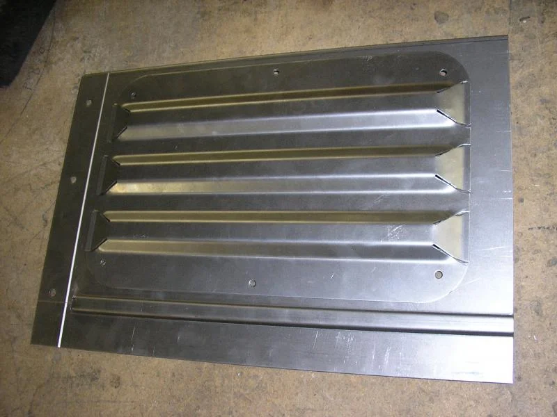

This then would be the front left corner floor section and cover. It is also not welded yet. There will be flanges added in the corners of the cutout and the rib end will be welded and buffed. I will also add captured nuts to bolt down the cover. The three holes are for the front end of the wheel hump and crossmember underneath.

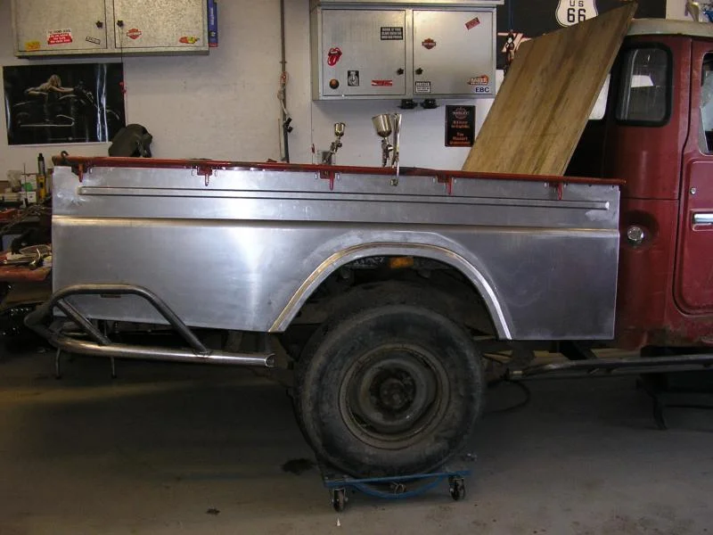

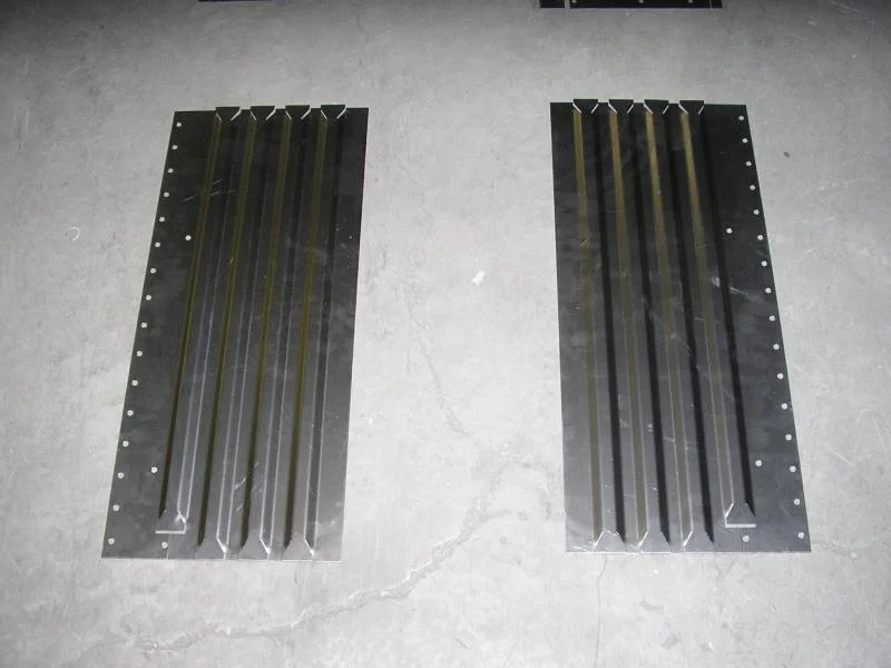

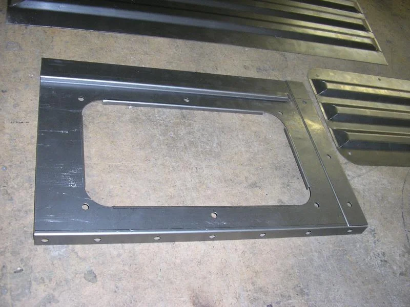

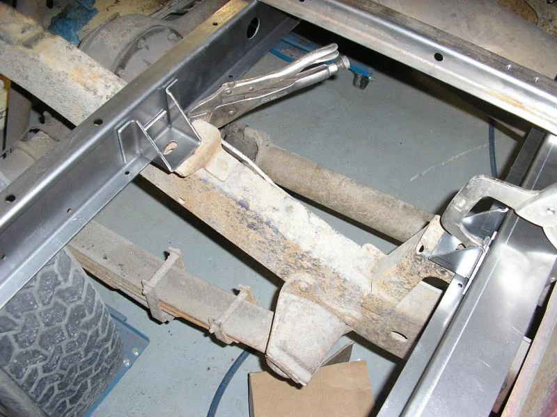

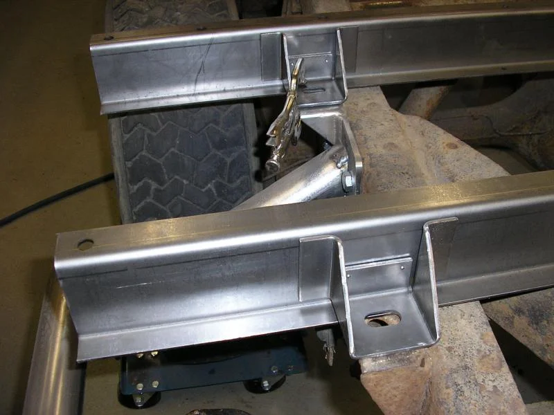

I made a couple of sets - lefts and rights obviously
Took a set of cross-members home to test fit and double check. Here are the frame mounting brackets I mentioned a while back.
