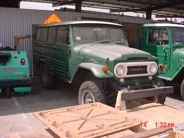

Hey guys,
I haven't worked on my '65 45LV or been around here for a couple years due to my wife getting and remaining very sick, but I've recently started to work on the wagon again so I'll start posting up pics of any progress. I broke silence last week by showing up in the FJ25 section to let some old friends over there know I'm still alive, and figured I'd post here as well.
If there are some here that are new and not familiar with me or my LV, I bought it from Marv specter back in 2004, and immediately started to convert it to the looks of a FJ35LV. The 35V and LV were the only vehicles of the entire 30 series of 1960, with a total production of 60 vehicles. All I've got to go from is 2 existing FJ35 photos and a sales brochure. Here's a couple pics of a real 35, my LV as I bought it, and how it looks today.
Gene

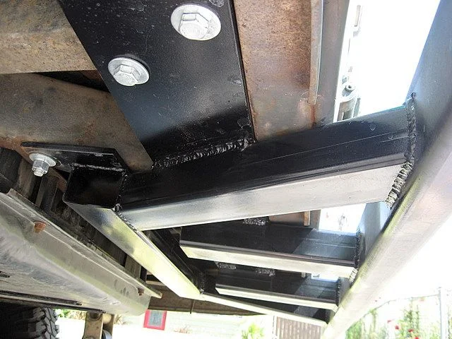

I bought the steel tube already but I could use some pics for design. Most here are a lot more experienced in the design/fabrication dept so I'm up for any suggestions. I fabbed a rear bumper for the LV a short time ago from a pic I snapped when Georg brought "Orange" to the 45Run in 2004. I took one look at it and knew I wasn't gonna come up with a better design on my own. My wagon got slammed before I owned it and the impact tore the rear bumper off the vehicle. I feel sorry for the person who drives into me now.

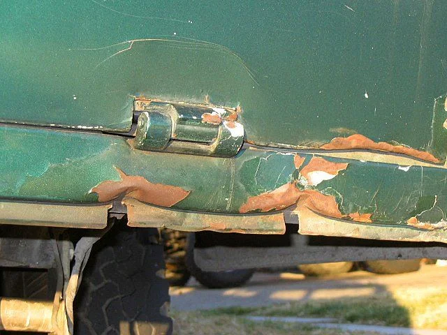

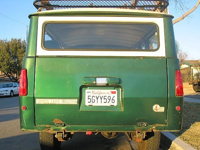

Starting to work on the tailgate.

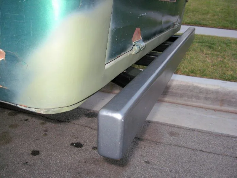

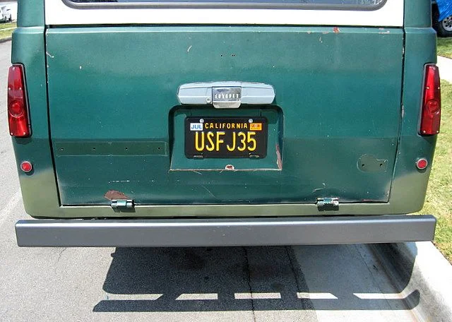

Outstanding bumper--understated and beefy!
May I ask, what size and gauge tubing you used?
Did you add some type of end caps?
Also noted your black CA license plate.
Is that something special you cooked up, as I cannot recall personalized CA plates back then.
Thx
Bear
Bear is online now   Reply With Quote
Old 04-20-08, 09:23 PM   #16
IH8MUD Regular
Land Cruiser Junky's Avatar
Join Date: May 2004
Posts: 461
Bumper is 2" X 4" X 63 1/2" 1/4" wall. I made and welded on 1/4" end caps.
Support tubing is 2" X 3" 1/8" wall and mounting plate is 3/8".
Again, this bumper was Georg & Co's design. If I remember correctly, he and the boys all got together on a weekend and fabbed and installed a ton of stuff for "Orange". All design credit goes to them.
Vintage 1960's California license plate . . . Yeah, you're right, they didn't make 'em in the 60's.
