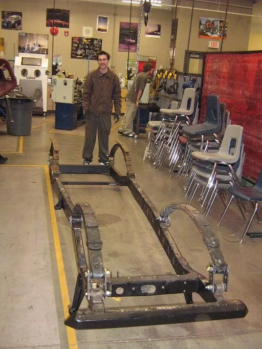

Frame:
I built the 45 frame last spring from a 40 series frame, similiar to Medusa's.
f150 rear springs, bj70 rears up front. About 103" WB
(frame pics posted tomorrow or the next day...they are at work)

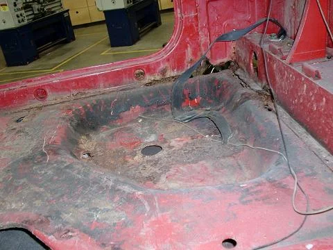

first set of pics!

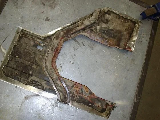

Posts: 360

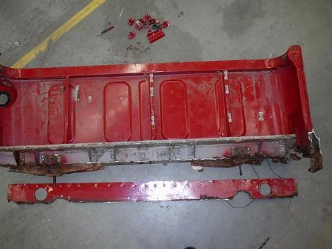

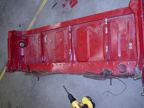

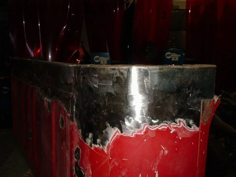

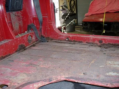

more inners

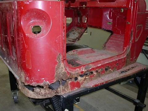

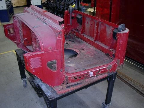

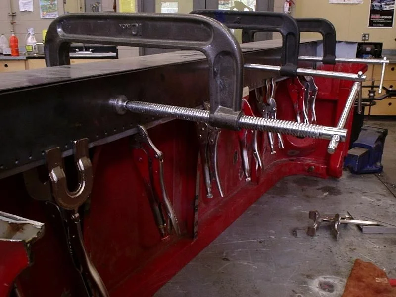

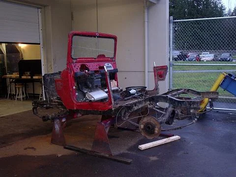

cut up cab...

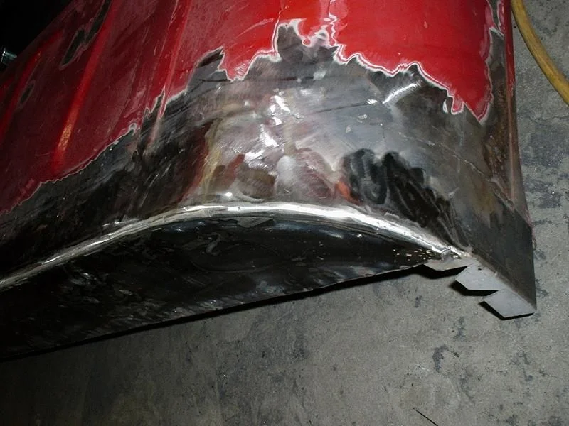

Old 04-03-08, 11:48 PM   #5 (permalink)
250+ Club
Join Date: Jan 2005
Location: Vancouver eh?
Posts: 360

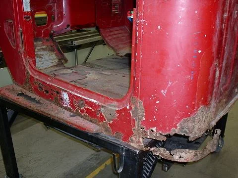

rear section started yesterday too.....

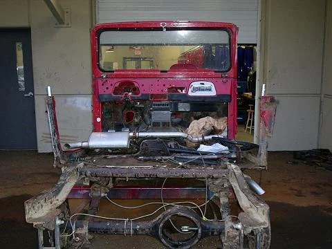

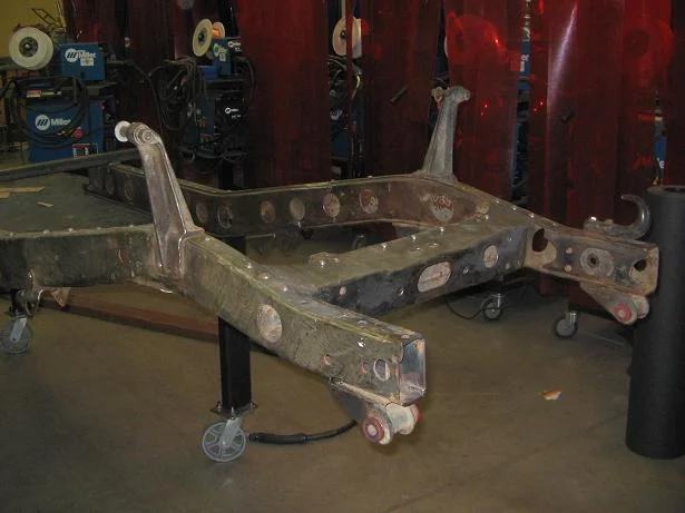

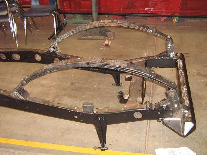

the start of the frame came from an abandon 40, but it will live on.......

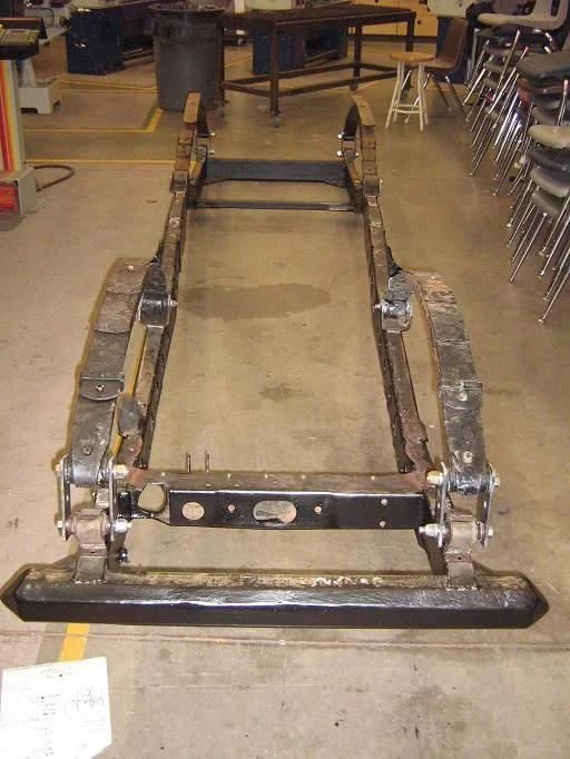

more.....

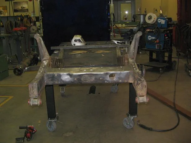

stripped, wire wheeled and cut behind the tcase cross member......

Old 04-07-08, 07:16 PM   #19 (permalink)
250+ Club
Join Date: Jan 2005
Posts: 360

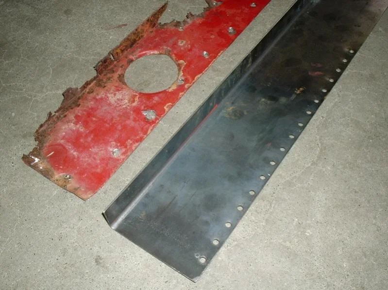

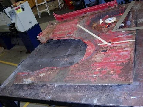

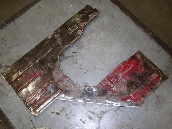

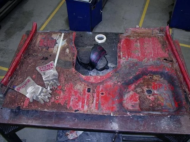

Floor almost finished. When I buy new rockers, I will cut new pieces.
Just need to patch a couple little holes.

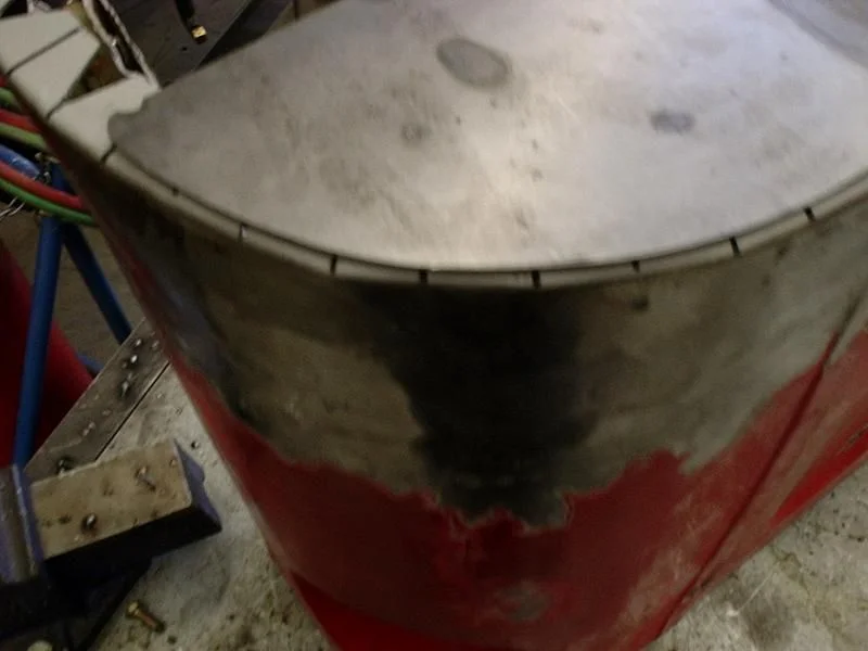

got some panels made and tacked in. My work has 8' a 60,000 lbs press brake. Was easy to whip these up.

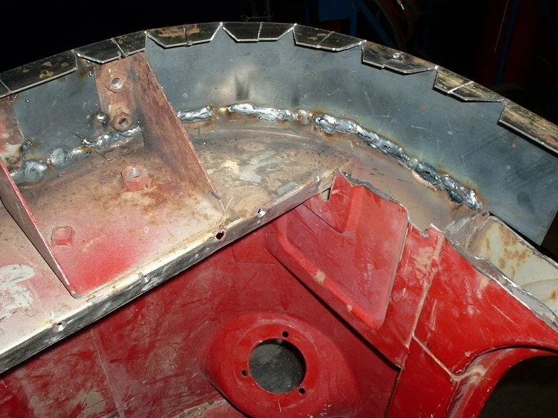

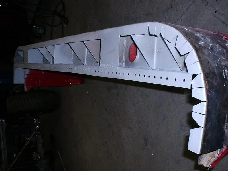

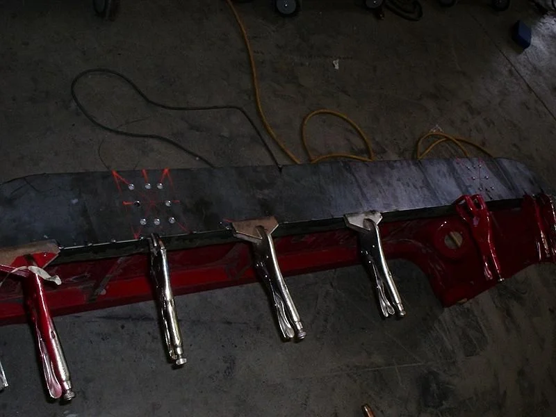

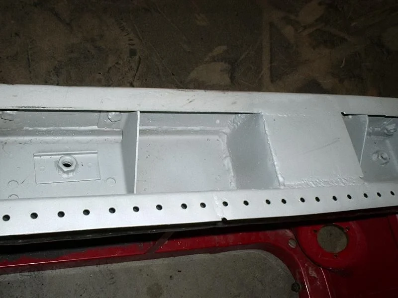

i painted the inside of the box section with SEM weldable primer. Clamped and ready to be welded!

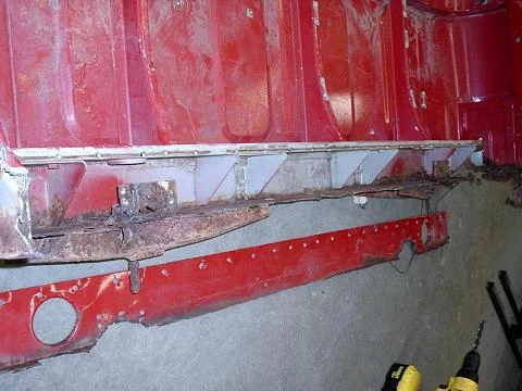

I finished welding the back cab section. Now I have to make the rear cab body mounts. I am trying to decide if I should make the original "X" style mounts or just run square ones. I may even make a hybrid of the both. I don't care if it looks original, but I do want strength and function.
I ordered the rockers with the factory lip for the doors. Then I can stitch in the floor and new cowl section. Yay!

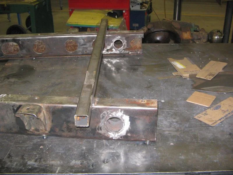

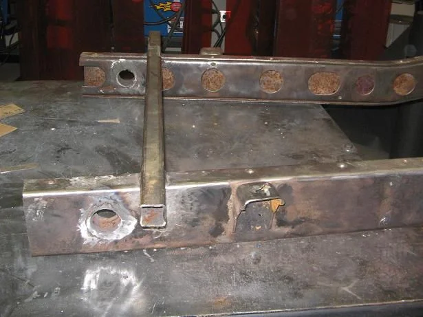

made the rear tub body mount "x's" today.
