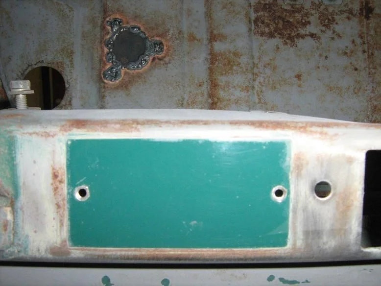

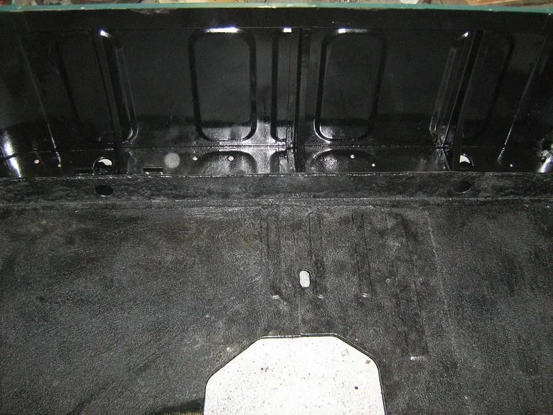

Here is the body ready to go. The firewall is painted with a paint product called Zero Rust. It is similiar to POR 15, but a little cheaper.

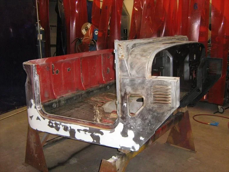

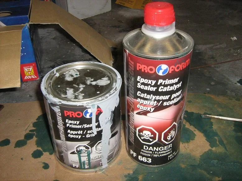

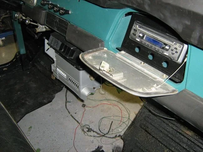

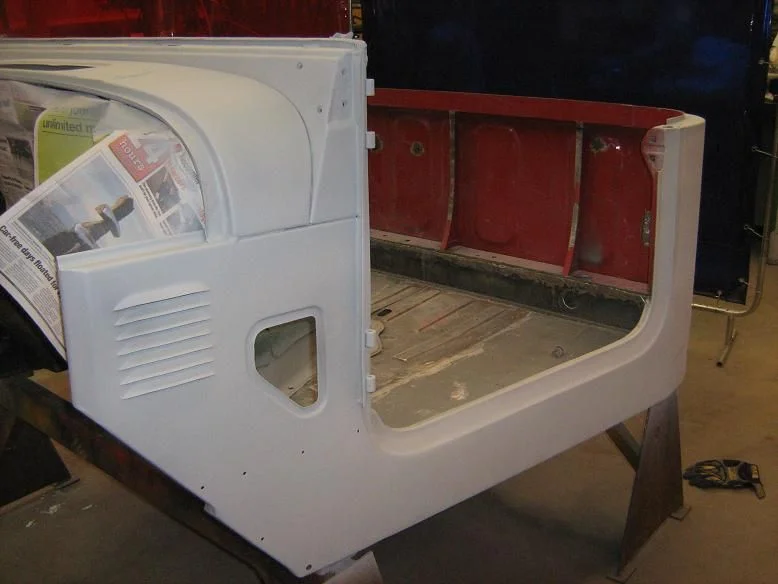

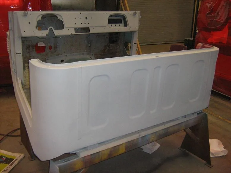

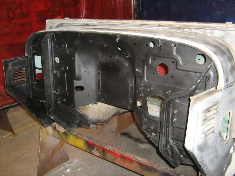

I used a two part epoxy primer to seal the body. I used a flap wheel with 120 grit to strip the paint, filler and rust off of the cab.
In the second pic you can see the hidden deck in the glove box. I am going with a dashman box so I don't need the space. That, and i have a factory blank out plate I really wanted to use.

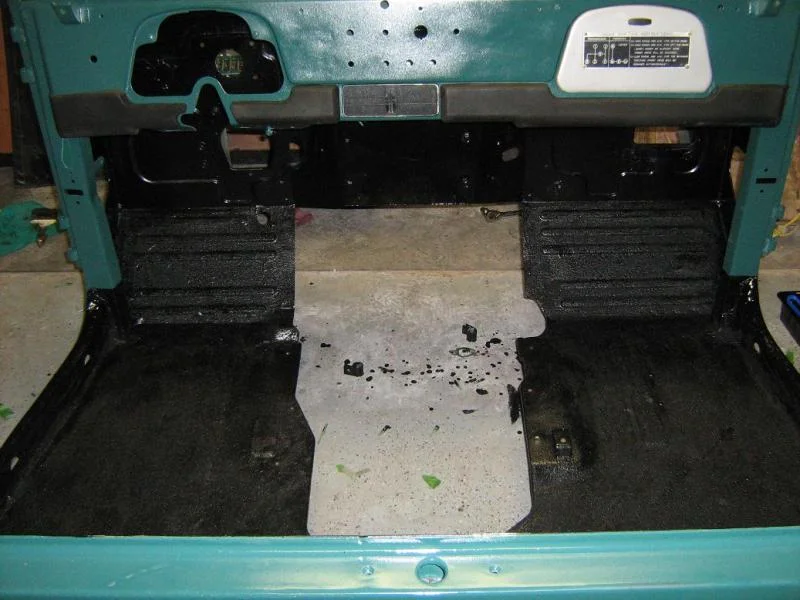

Posts: 360
I am going with the original color of the firewall. 621 rustic green. I was going nebula, but there may be too many others around

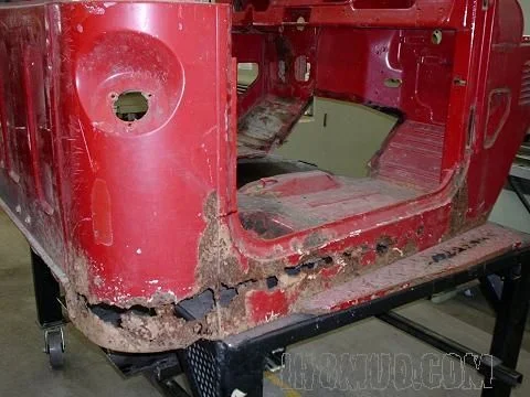

A proud reminder

Yeah - that was ugly. Really makes for satisfaction in a job well done when you look at the b4 and after shots.

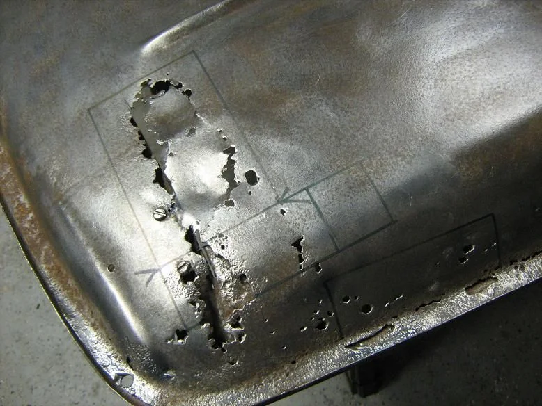

Just finished the second coat of epoxy primer.
I also seam sealed the cowl. I should have read buck's thread first. I am not very good at it.

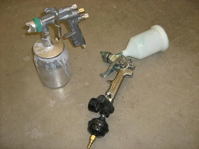

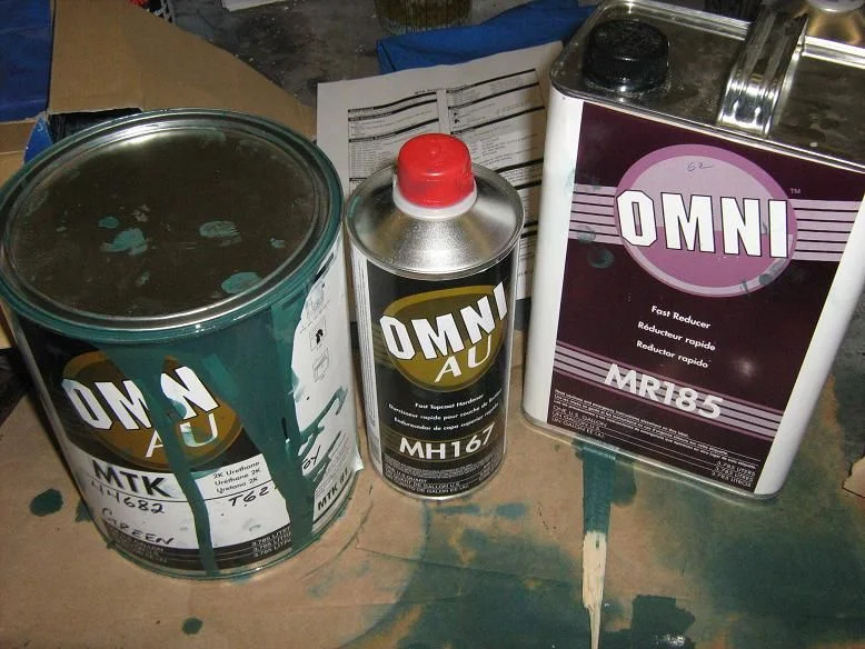

Ok, here are some details....

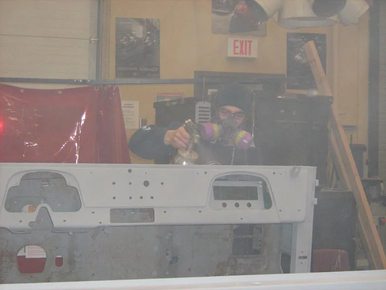

I used a siphon feed gun with a 1.7 tip for the primer.
I used a gravity feed gun with a 1.4 tip for the top coat.
Paint and Primer I was very happy with.

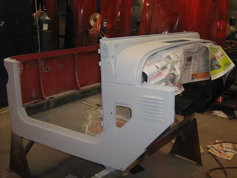

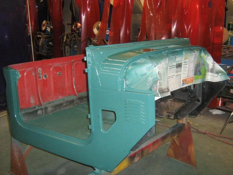

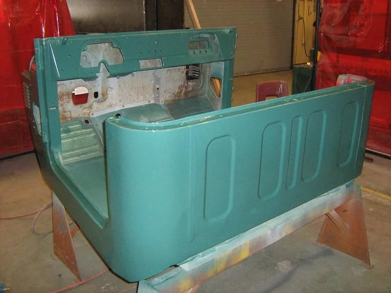

Here are a couple shots. I got about 3 solid coats of Urethane 621 Rustic Green and 2 coats of Epoxy primer.
I am not expecting this to be a trailer queen or show truck, which is why I decided to paint it myself. My money can be way better spent elsewhere. That, and I wanted to learn how regardless of the results.
I am fairly happy with the way things went. I had about 2 large drips that I sanded out with 600 grit and painted over again. There is very little evidence of my mistake.
Now I can going to start assembling just the cab and parts in my one car garage.

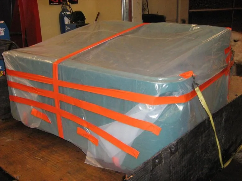

It should be an interesting trip trailering the tub home on the utility trailer tonight

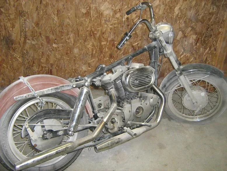

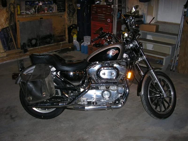

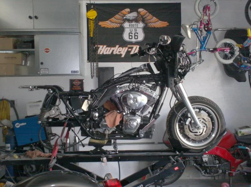

Looks like we worked in reverse. I am building the Harley next. I have too many projects on the go.

lol - yeah great mind think alike I guess. Heres my brothers sportster and my FLH.

I took apart the heater, rebuilt and painted it. I am going to install it in the next while.
I have finished painting the inside of the cab with POR 15. I then Herculined over it.

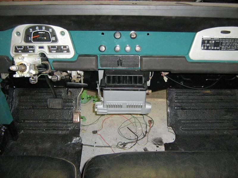

I have been busy over the last couple months finishing the dash and related wiring. I bought this thing as a bare tub so it has been interesting figuring out what goes where. Mud has been great for searching for pics!
This will be built from upwards of 15 dead 40's + 45's by the time I am done. (this is the only one I currently own )
I have rebuilt the heater and hooked up miscellaneous stuff. I am still missing a choke and the switch for the spot lights.
Here is a pic of the dashman box and other neat dash stuff.

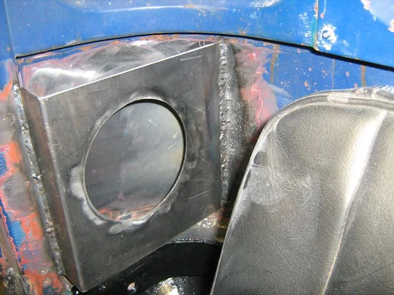

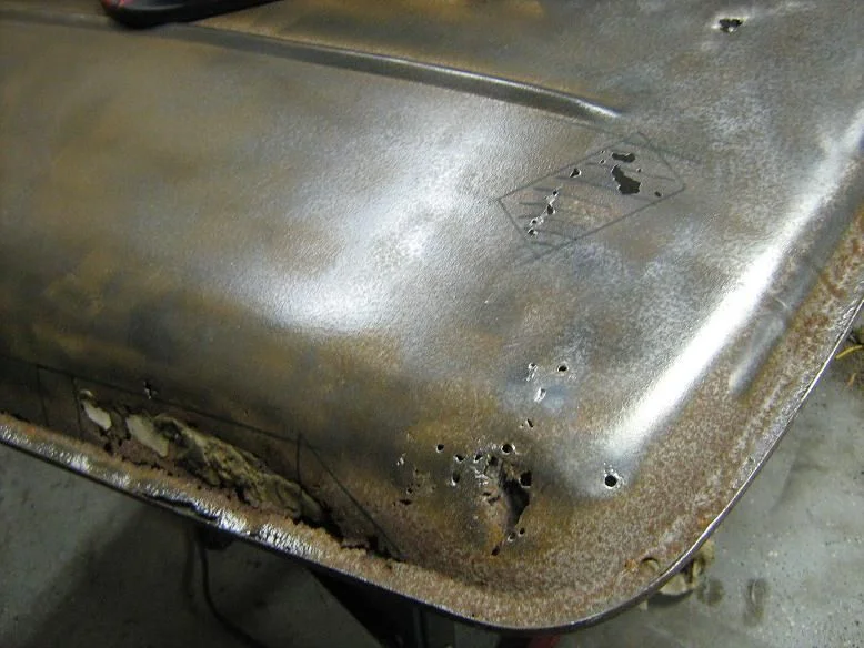

I have been doing a HUGE amount of work on the hard top rear piece. It was like swiss cheese! I have not even touched the roof yet.
Here are some speaker mounts I am working on.

Looking good, keep up the good work. Speaker boxes in the rear corners is a cool idea.
Funny that you decided on the Dashman box for your truck, too. I just ordered one from Mark Vickers on Friday.

Old 03-22-09, 12:44 PM   #89 (permalink)
250+ Club
Join Date: Jan 2005
Location: Vancouver eh?
Posts: 360
started filling the rear top with body filler. Now starting metalwork on cap.
dr_claw is offline   Reply With Quote
