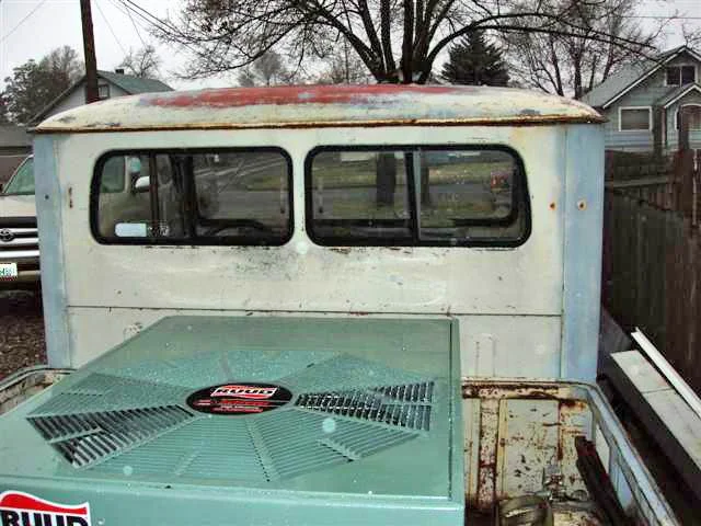

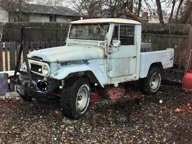

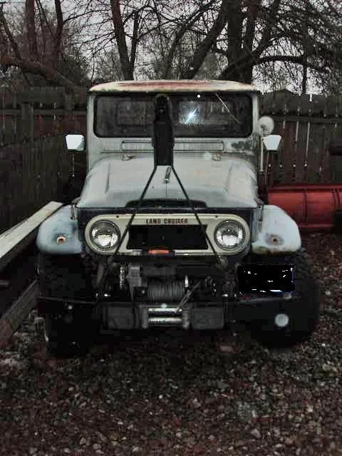

1963 SWB FJ45 fixed top- what is she worth? Am I crazy
Here are the photos. Please pick it apart. Have no merci so I know as much as possible what it will take to make it a driver. I know I will need to paint it and add a front disc conversion.

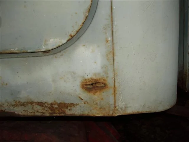

Here are some trouble spots. Floors have been patched with thick steel diamond plate. Rust in rocker on DS and rust on inner bed fender where the famous cross member rusts out. I have read from guys like Mark Algazy (sp?) that this is a huge PITA to fix.
Please let me know your opinions. Tailgate is not in photo but is very nice and not rusty. Truck was originally white.

Classic old alloy wheels and rare factory locking gas cap, nice if all the keys matched. The price is pretty good because it is complete and fairly solid, even though it has chevy stuff. I would buy it because that is the only way the perfect long bed will show up. Old Murph.
Good luck

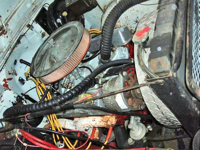

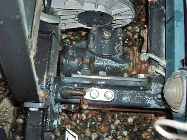

Not a bad swb for a NW rig. Here is what is going through my sick mind.
-Overall rust isn't bad
-Short block chevy can be yanked and sold on craigslist
-Winch can be yanked and sold on craigslist
-sell aluminum wheels and get stockers put back on
-Rocker panels, and floorboards are reproduced now (buy them with money made from craigslist sales
-Saginaw conversion is nice
I would take the bed off the frame and have it bead blasted to see what I'm dealing with. From there I would begin to patch and recreate what is needed for the bed. (hardest part of the project) You can get an aluminum bed from aqualu if it is too rusty
I would then find a newer 55 or 40 (76+) being parted and get both axles and bolt them up to have disc brakes.
Buy oem steel wheels from cruiserdan with new tires.
If you buy this and want to go stock with it. I will donate my running F drivetrain with floorshift transmission and transfer case out of my 40 that was hit by a tree to sweet'n the pot.
Aaron it depends on what you want the rig for? Are you going to wheel it? Want a bitchin daily driver? Stock drivetrain with upgrades? V8?
Just some quick thoughts..call me if you want to chat more in depth
ps. Just buy it for the friggin bezel!!!!

$5,000. would be more than I would spend, but I'm a cheap ass. It's definately buy what you find and if your not finding any....get the best you can.

wow.....its has the super rare optional bed mounted heat pump......amazing

What with that massive kind of cooling sitting in the bed, and a case on the floor, you can bet it's gonna be free ice-cold brewskis for everyone!!!!

I love the humor guys. I knew the AC unit would generate comments. I was just waiting. A redneck never changes just buys a different truck.
