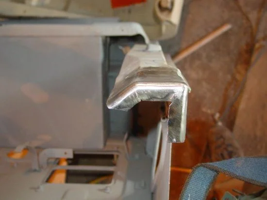

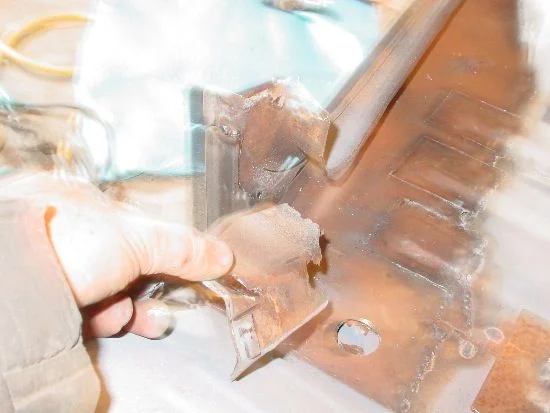

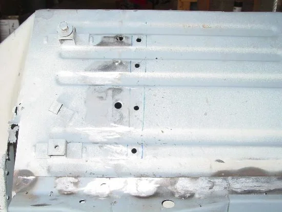

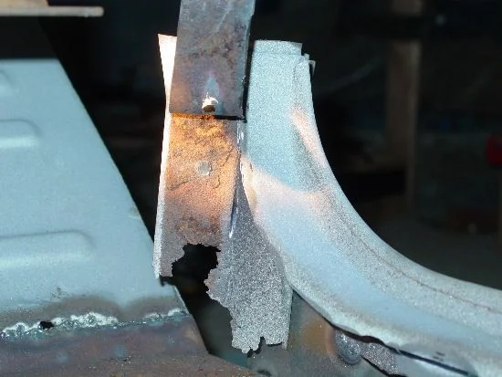

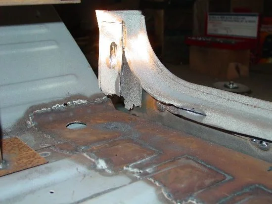

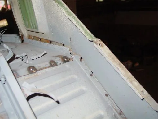

By the end of the day, I had both outer rockers tacked in place and was feeling pretty exhausted. I hope to have the LHD firewall into place tomorrow, along with the inner rockers (which will be a pain to fit into place) and fingers are crossed that this will come out the way I am intending. There are a lot of unknowns as far as the effects of shrinkage and possible warping that make me a little nervous about the result. You can see the end of the rocker where it joins to the door post at the front wanting to twist a little outwards in the photo below, and i don't think it is a significant issue at this point.

Beautiful indeed. You are flying through that bodywork.
What kind of primer are you using there? Rattle can, or something more elaborate?

Ah yes the primer...so far I've been using rattle can Pro Form etching primer and primer surfacer. For the sheet metal, this is more or less just to protect bare metal from rust - it's convenient and quick. My plan is to use PPG 2-part epoxy primer on alll of the sheet metal when I'm done with the patching work.
Then I'll do the underside of the cab and fenders, cab footwell, and the underside of the bonnet with spray-on bed liner, either SEM or PPG brand. The Stutz gun for spraying bed liner/undercoat is only about $30, so this seems worth doing myself, though I was considering having it Line-X'ed at one point.

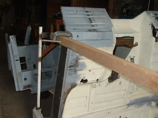

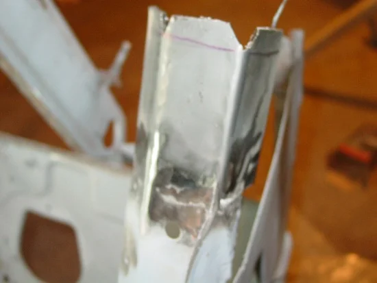

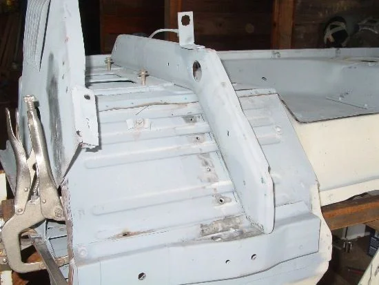

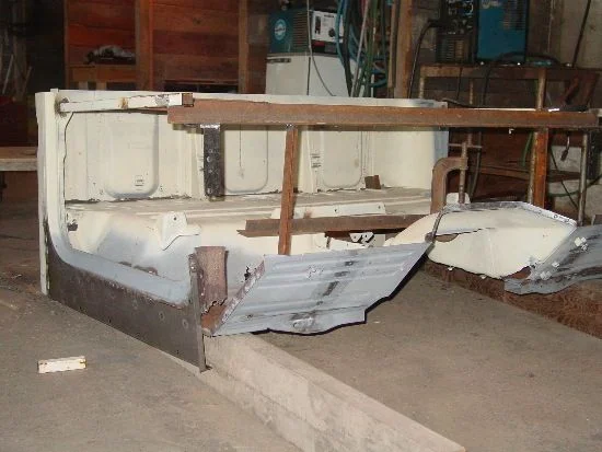

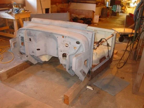

A long day on the truck today, and made some good progress. Started with the inner rocker on the passenger side, which was not the most fun piece of cut out.

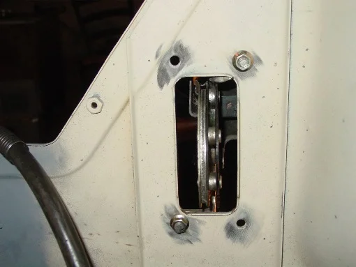

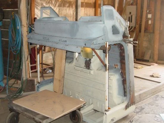

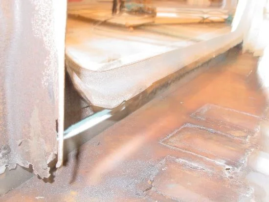

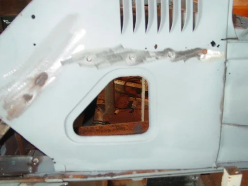

It took a while to hack out the remnant of the firewall door pillar, then, after tacking the inner rocker in place, I decided to take a look at how the LHD firewall would fit. I was getting nervous about metal warp at that point. As you can see, the firewall stiffeners are not in identical alignment for LHD/RHD firewalls

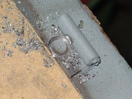

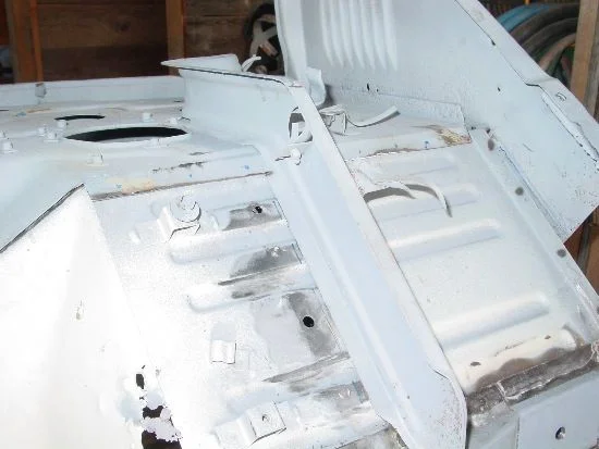

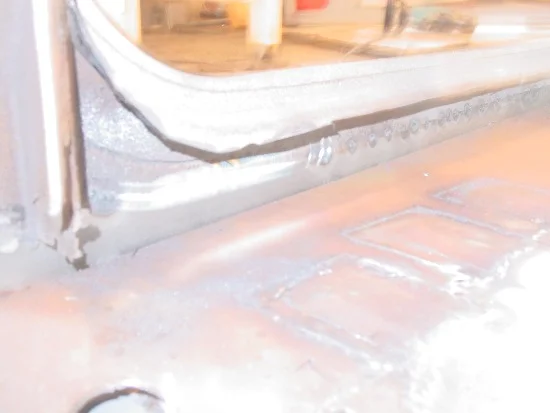

I marked the location of the stiffeners, removed the firewall and drilled some holes for spot welds

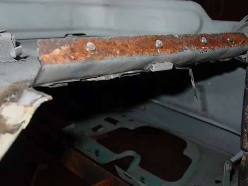

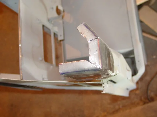

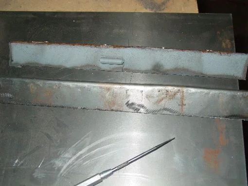

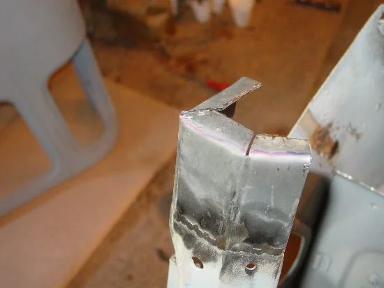

Then I chopped out the inner driver's side rocker, but chose not to tack it into place quite yet. I put the LHD firewall back on, and then used a little persuasion to adjust the outer passenger rocker panel into plane with the door pillar. Then I started fabricating the lower ends of the door pillars, doing the detail slightly differently than factory by bending little tabs onto the bottom which I will weld to the floor pan.

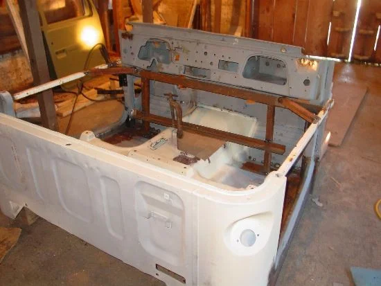

Welded up the ends of the door pillar lower sections, did a couple more trial fits of the firewall and made the necessary adjustments to get everything where it should be. The bolt holes from my jig lined up perfectly with the new firewall!

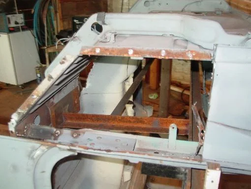

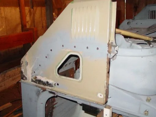

and at that point, the moment had come: I welded in the firewall and Henry James is now LHD
I have lots of welding still to do on the cab, not to mention the upper cab window and one of the doors, but it felt like a milestone in this project to finally have the cab converted.

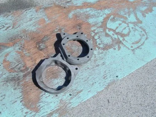

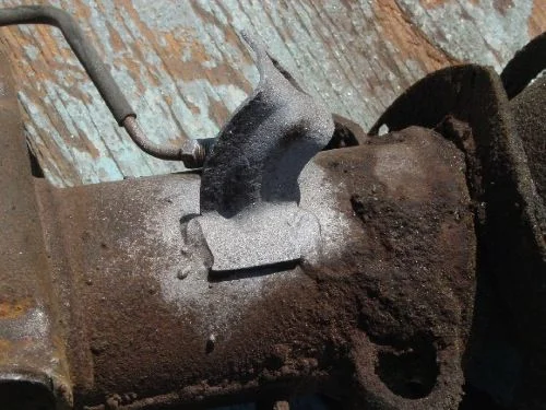

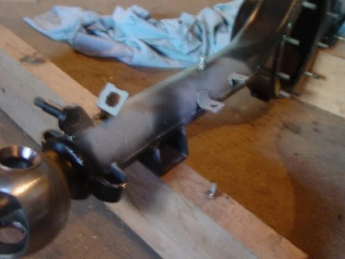

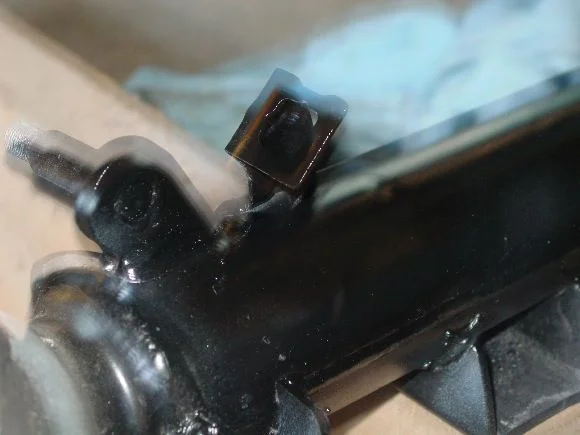

Started my work on the truck today by heading to the wrecking yard, where I obtained a set of mini-truck knuckles, aisin hub selectors, a 60 series steering column, and a pile of nuts and bolts, plugs, and a couple of electrical parts.
Got back to the truck and set about slicing the knuckles apart for the last 1" to produce a ring with the disc brake tabs. Then I ground them somewhat flat along the cut line and media blasted them.
Then I went to see how they might fit to the axle flanges, and it was a bit discouraging. The backside of the flange has a raised lip on it that is larger than the diameter of the knuckle section, so I would have to get them machined, and I know already that the diameter of that inner raised lip is 4.75" and that it sticks out from the back of the flange about 3/16ths. The bolt circles are different in diameter as well, and after machining a rebate into the knuckle section, there wouldn't be much meat left. Back to the drawing board...

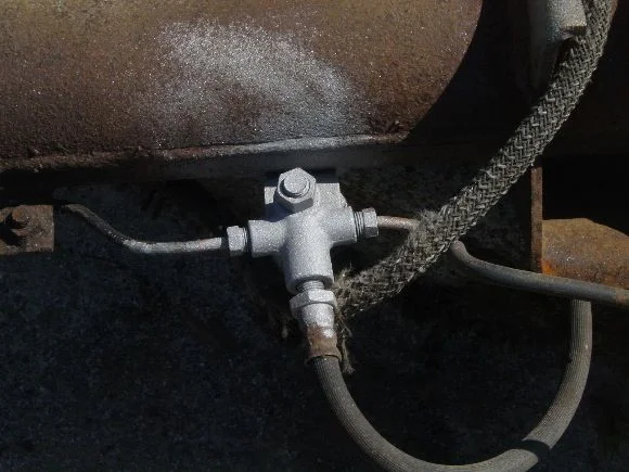

While i had the blaster going, i cleaned off the brake line mounts on an 60 series front axle I had, and then chopped them off. Then I cut the mounts for the lines off my 47 front axle and welded the 60 series bits into place.

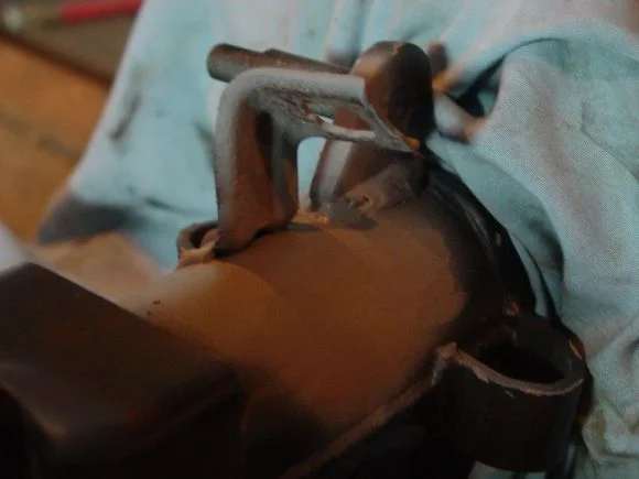

After welding, then it was etching primer followed by brake caliper paint.

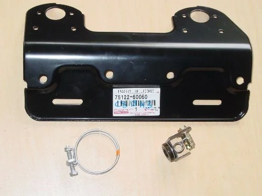

Got a few goodies in the mail from Australia today:
-a 75 series license plate mounting bracket. The lamps that CCOT sells fit perfectly.
-a hose clamp for the connection of lower rad hose to water pump
-a glow pug controller. This little doohickey is the ultra-primitive glow system that Toyota used up until Feb/82, when they switched to a glow plug timer. It's simply a coil with a little mesh screen in front of it. It mounts to the dash to the left of the the instrument cluster. I haven't seen one in operation before, but I assume it glows cherry red after current is run through it for a spell. The glow cycle for my truck is 15~30 seconds, and I plan to use a manual push button switch instead (or possible as well as) of an ignition-operated glow start.

back to the project...first a little work on the side cowl panels. The ones on the new firewall were not in the best of shape, and the floor pan section that attaches to the panel was in poor shape too.
After I removed it, I went and welded a couple of nuts onto the e-brake mounting plate
__________________
My 1982 HJ47 rebuild: http://forum.ih8mud.com/fj45-owners-...come-here.html
Henry James the 47th is offline   Reply With Quote

The side cowl off the old RHD firewall has the extra plate welded to the inside of it to connect to the heater blower - it's like a flange that the blower mounts against. While my heater blower now relocates over to the other side, I chose to not remove this flange from the cowl panel as I am scheming up a way of routing my air filter inlet to it (more on that later).
Here I'm just checking the fit of the panel off the old firewall in place on the new one.
__________________

Next I started on repairing the rotten floor section adjacent to the side panel. I chopped it out, bent up a section of 16 g. and cut it to the same configuration. The bend on the flange is a bout 110˚.
When i removed the old section, I noticed that the inner side had the spring mount for the vent door spot-welded to it. I was lucky in my choice of cut line that I didn't slice it right in half
Drilled out the spot weld and mounted the hinge onto the patch repair section
