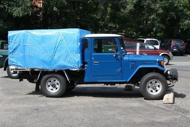

Hello - I am at a stop over visiting an old friend in MN I have not seen for 12 years... Here is a photo of the truck wrapped in blue.
Wow that looks awesome.
How's it running?
More safe miles ahead sir!

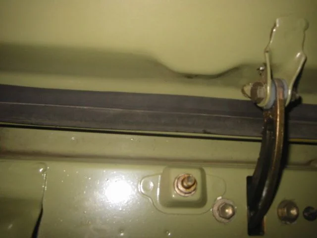

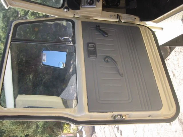

Other than the rubber for the actual vent itself, I've always used the factory window felt and sweepers for the non-vent window doors, and trimmed them to fit the vent window doors. I put vent windows into my US Spec 83 FJ40, and I used all US-spec felt, etc (again, except for the vent window seal itself). I will try to attach a photo of that, but I don't think I can post any more pictures as I don't have a star (not sure what that means exactly, but Fj73 said it, and I reckon he is right).
I have sent a few vent window assemblies to mates in the States,and they have all put them into older doors (75-80- with the pop-in window felt at the bottom, rather than the clip-in rubber sweeper of the 81-84 doors), using the factory felt, etc. It is certainly easier than converting a RHD to a LHD!
Are your present doors from a post-81 40 series? I believe that is when the doors got the little bump in the front which engages the pin switch for the door light.

Well, I THOUGHT I had a set of 1982 doors, but like so many things on my truck, they turned out to be from other, earlier vehicles. I bought the correct weatherstrip for the doors, then found when I had finished all the work on the doors and went to put the them back together that the weatherstrip wouldn't fit (this is the earlier metal/felt units, not the later type with the rubber wiper strip. The earlier ones had little holes on the inside of the door window opening, using clips just like the weatherstrip between apron and cowl. The later type of weathersrip fits with stouter clips into rectangular holes on the door. These little details did not become obvious until later.
When my finances recover over the next few months, will be on the look out for a straight and rust free set of the later type of door. Maybe i will go for the non-USA type with vent windows, as i have found the kick vents to be a wonderful thing indeed, so more of the same would be great!
Could you take a picture of the bump-out on the door for the door swtich? I retrofitted the switch mount onto the door pillars and didn't realize that there was something on the inside of the door as well.
Thanks for all the information!
By the way, what sort of mirrors are you running there? They look a bit like a 60 series mirror.

Good description of the old v new sweeper. What I have found is that the post-81 sweepers keep the windows a bit quieter, and they keep water from getting into the door itself (the vent windows also keep the window from rattling when it is not rolled all of the way up). You don't need to get non-us doors, though, as you will find that the US-spec doors have the holes in them to install vent windows.
All you need to do to put the vent windows in your doors is to shorten that metal and felt sweeper on the inside and outside (on the post-81 doors, the inside felt is the same; it is only the outter sweeper that is different).
I'm attaching a photo of the 'bump' for the pin switch, but I cannot guarantee that it will attach, as I don;t have a 'star'. I also have a set of 84 doors in my shed here in Australia, but shipping them would be too expensive.
The mirors, I'm a bit embarrased to say, are J**p Dangler mirrors. They fit really well, don't require holes to be drilled anywhere where they can be seen once the factory mirror is put back on, and they don't vibrate. I also have them on Patches (my troopie).
