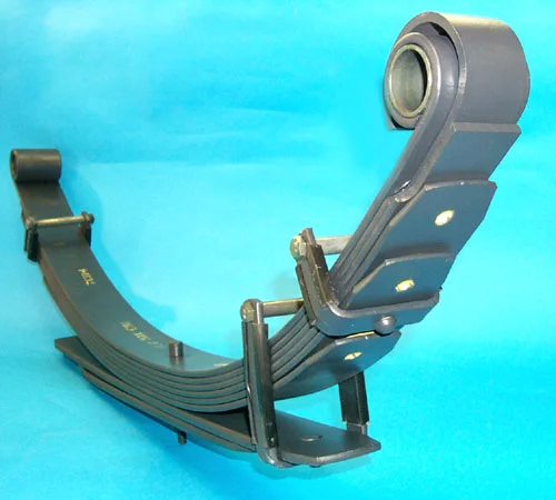

I would give Alcan a look as well. Good flex, good ride and completely customizable. You can pick whatever lift you want...stock to 5" and whatever weight rating you want. If you were gonna haul a bunch, or for a winch etc...longer springs whatever you want.
I had them on my 55 and they were awesome...great ride. You are looking around ~$200 a spring.

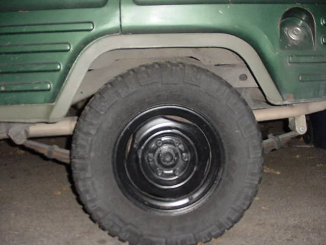

Stock Toyota springs from SOR. Put Toyota 1 tons (10 leaf) in the rear. Marv suggested I remove a couple leafs for a smoother ride, but I left all ten and even with the wagon empty the ride is great. Pack for 5 days of camping there's no sag. I'm not rock crawling, but they worked great for very rough cross country wheeling and they're DIRT CHEAP!
Here's a pic with 31s.

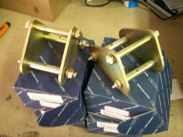

SOR anti inversion shackles
Does anyone know if these shackles would work with a set of OME springs? As for Alcan, I figure if i was going to spend that much, I may as well go with OME, as they have done the calcs. for weight and all. I would have no idea what to say about weight etc. I am worried that if I piece a system together, it might end up uneven from front to rear?

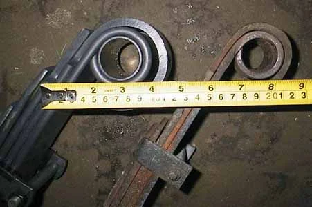

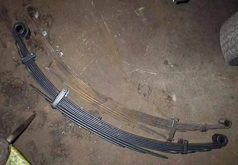

Here are some comparison pics complements of Koji. I see a big difference and value for money spent.
