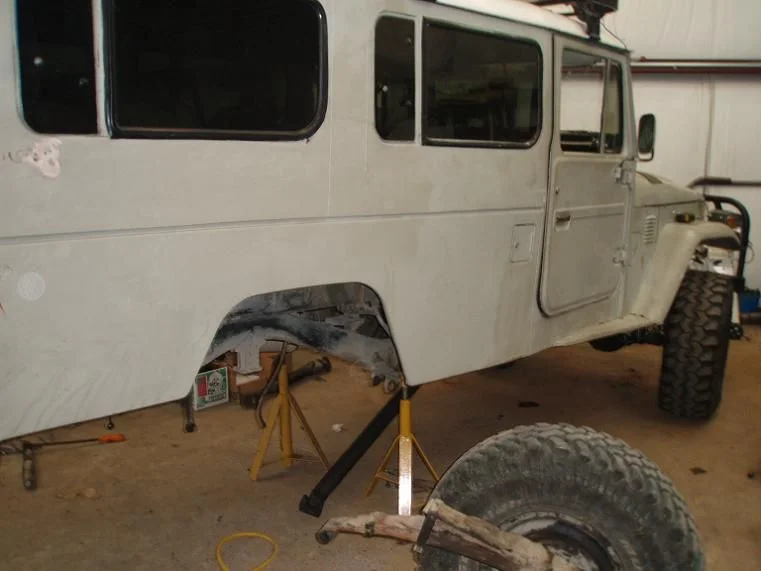

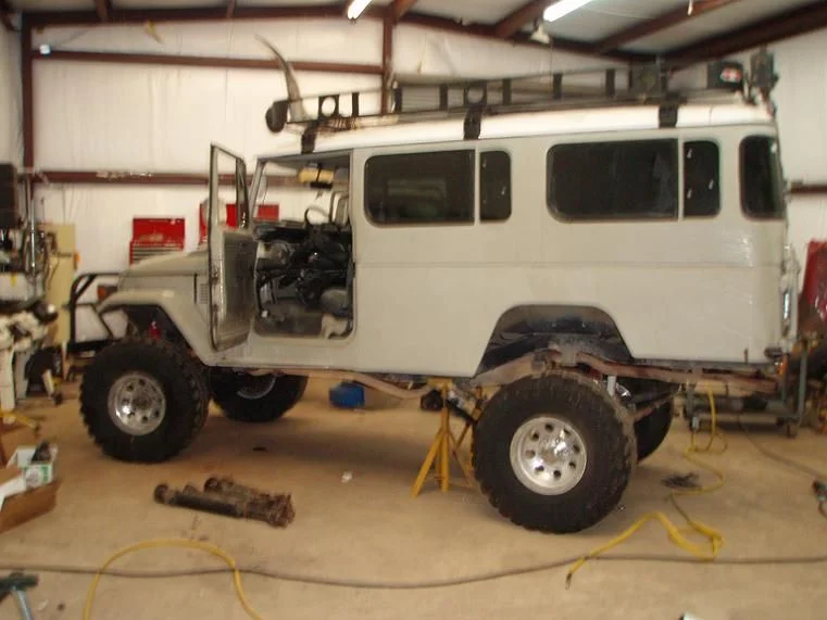

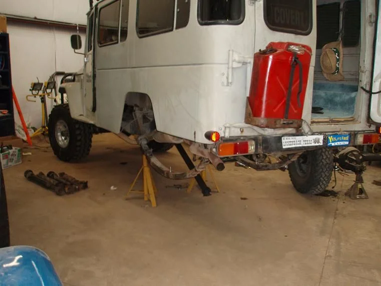

i finally pulled the trigger. swapping the soa setup from the 40 to the troopy. a few pics of the work so far. the front is finished and the rear is halfway done.

that looks great. I am watching this closely to see how it compares to the pics of you on your Man quest. how it turns out will greatly affect how i lift my lv.are you going to switch back to the steel wheels?

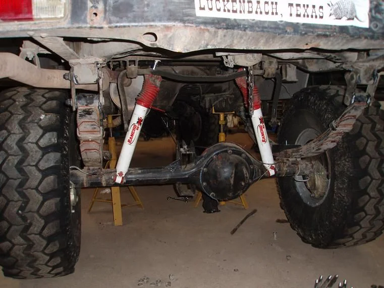

soa means Spring Over Axle. this is achieved by welding perches on top of the axle and bolting the springs on the top instead of the bottom. there are many threads that cover this. it gives you around five inches of lift(this varies) and better flex.
the tires i have are 35x12.50, so they are not much more narrow than yours. a fender flare would difinitely help flying mud and debris, but it is not required here in mississippi. i do not believe these tires would anymore satisfy your cops than ones you have now.

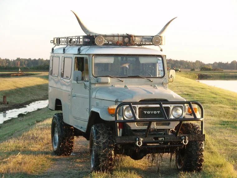

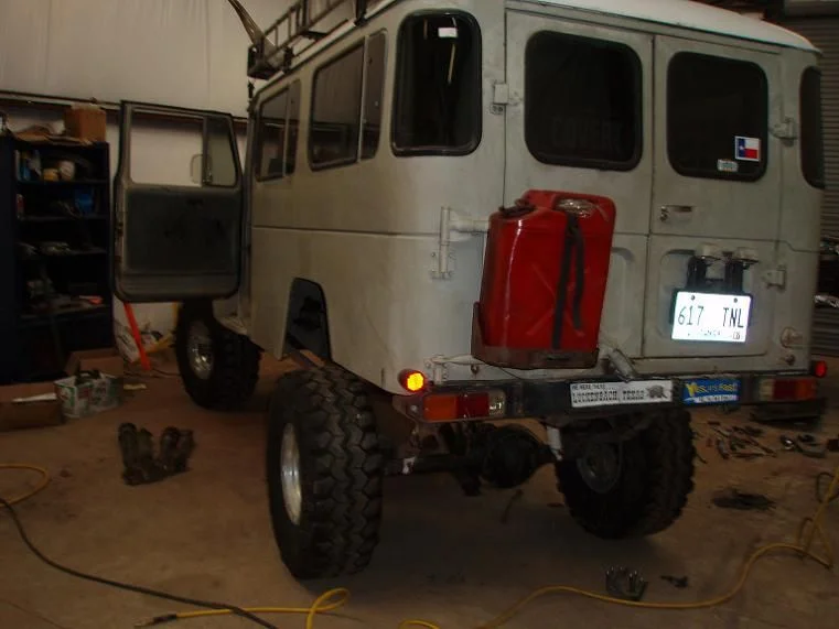

this is gonna be one big heffer.

granted, it's still sitting on jackstands. i've got to get some u-bolts and hook up a brake line and a driveshaft and i should be ready for that test drive.

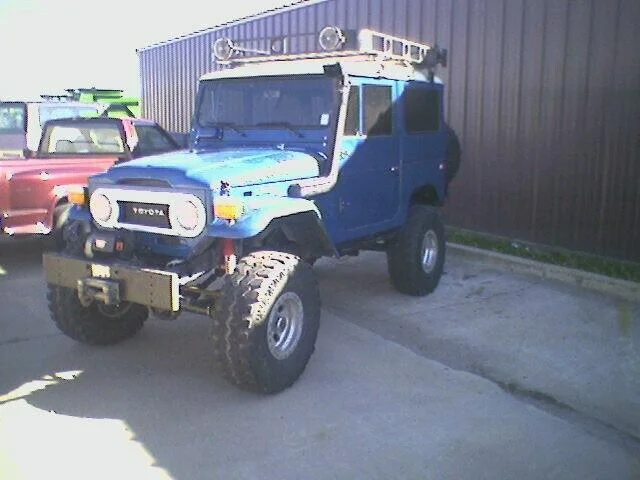

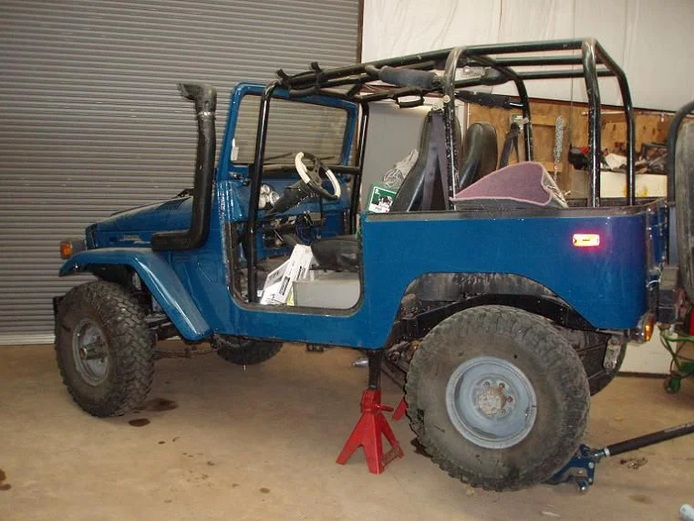

my 40 is the one that suffers for this.

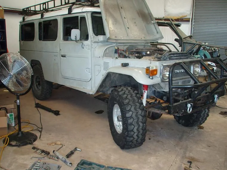

finished today. everything but the torque arm. rides nice.

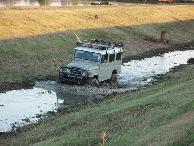

the drum master works good so far. i read somewhere to remove the limiting diaphram thingy where the brake lines screw into the master cylinder. i did that and they work like they should.
not rice dykes. these pics are on a catfish farm where my buddy works.

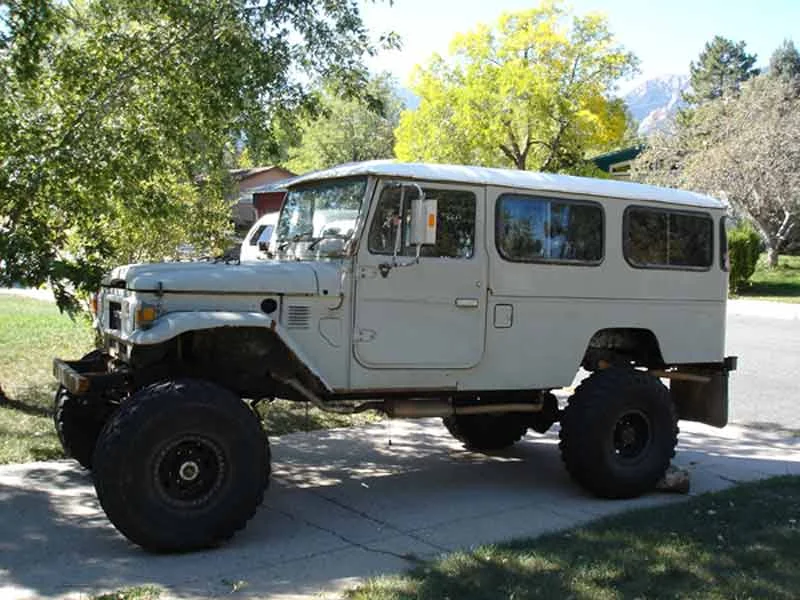

Heck yeah!!! Here is a pic of mine on 37's
I love those horns!
