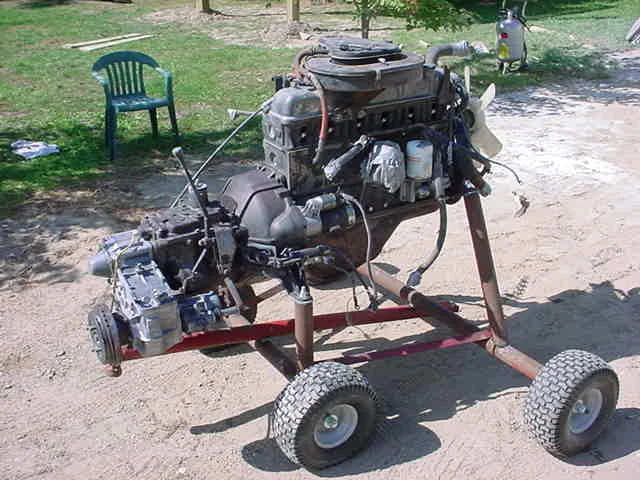

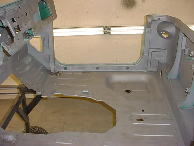

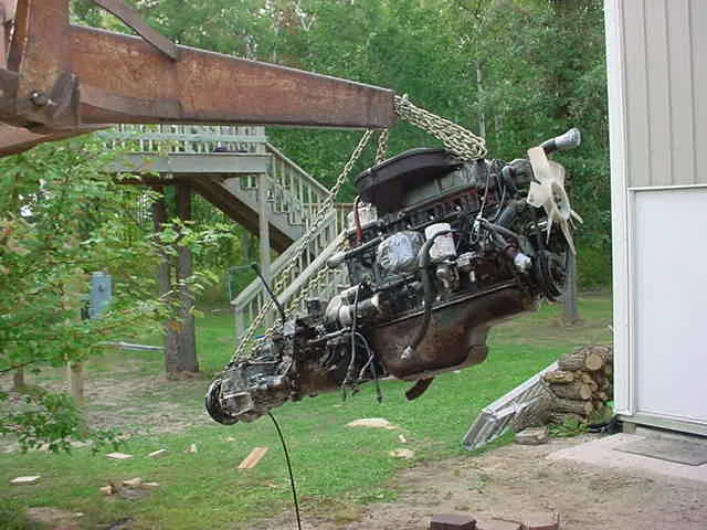

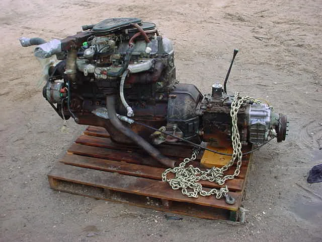

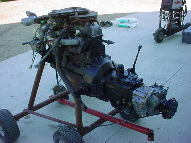

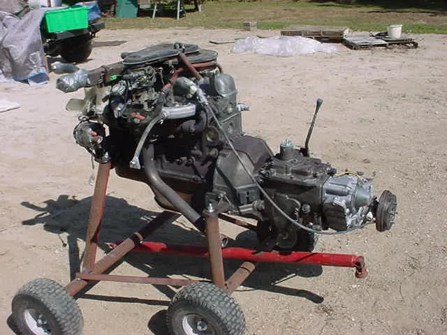

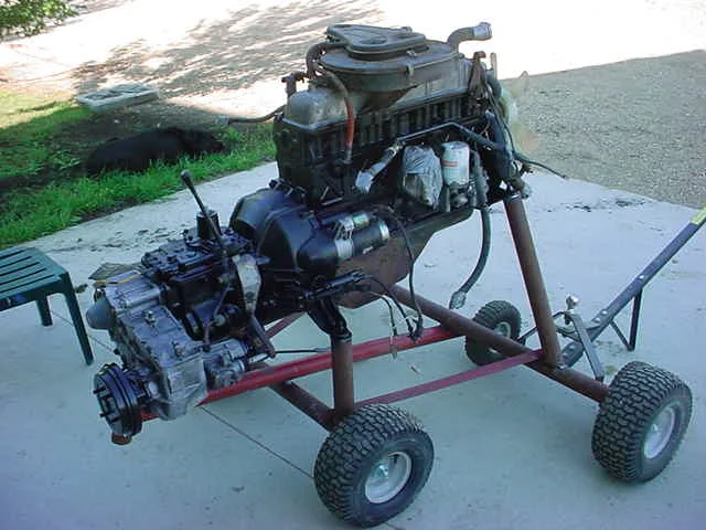

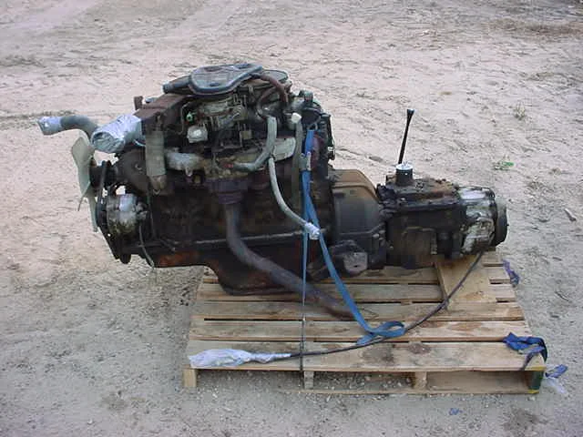

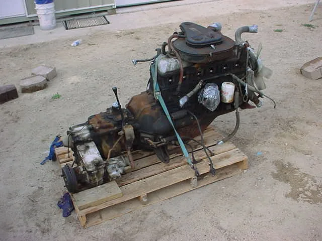

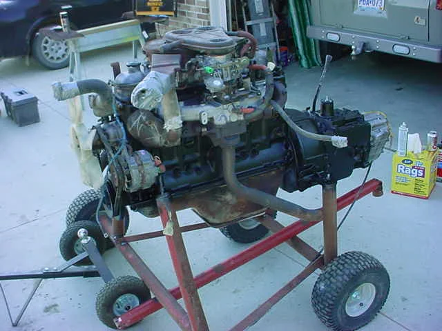

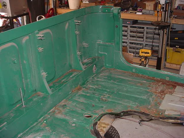

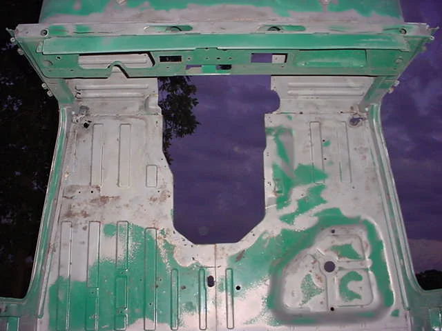

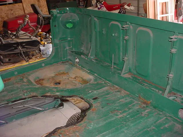

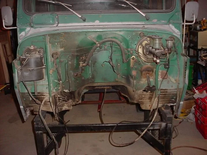

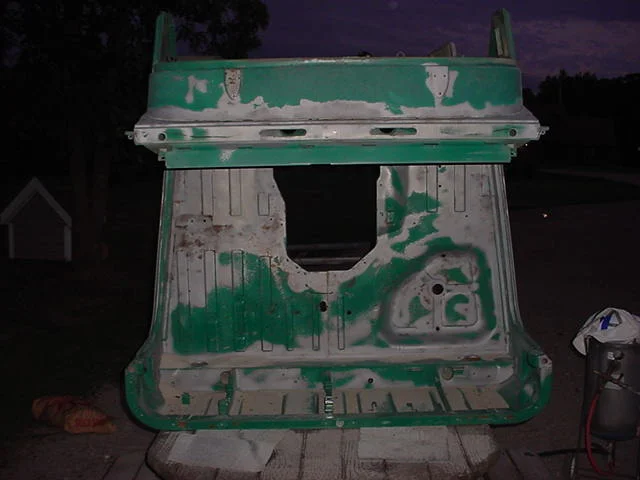

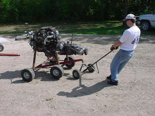

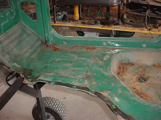

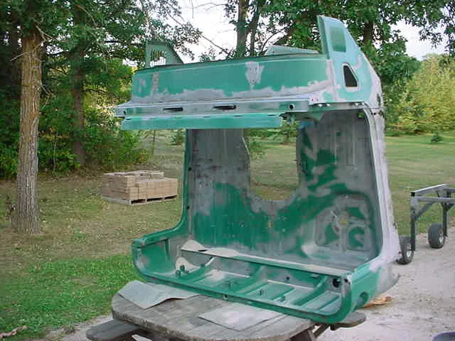

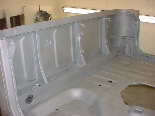

Got a few hours in on the lpb Saturday and Sunday. Wife had me doing a lot, but managed to sneak in about 4 hours total over 2 days.
Saturday evening I spent a good couple hours degreasing and presure washing the motor. I lifted the motor up with the tractor and made sure I got underneath also. Took about 6 to 7 times degreasing and presure washing, but got most everything off.
Sunday I decided to make a stand for it. Figured I was going to be pulling the oil pan anyway for blasting, along with the air cleaner, valve cover and other misc. parts. And it might be a little bit before I round up a frame.....so I ran to the store and picked up 4 more used lawn mower tires we had and some scrap New Holland round bailer tubing we had laying out back. Took a little over an hour and it is somewhat crude, but fabbed up a stand for it. Also used the end of one of the bailer tubes and made it so I could turn it with my trailer dolly.......my neighbor is demonstrating how that works.
I then poured out the remaining silica sand in my blaster and poured in the sodium bi-carbonate. For those of you that just tuned in...I am using sodium bi-carbonate because I am not taking apart the motor and do not feel comfortable spraying silica sand around a perfectly good motor. I still plan on pulling the above mentioned parts, but wanted to blast the block, tranny and T-case down to bare metal and shoot some fresh paint. And that is exactly what I did.......Took about 2 bags of sodium, you can't see it in the pics, but it did a pretty nice job. Cleaned any paint and surface rust off the block and tranny and clean the T-case up real nice. I then did a basic mask job and shot some black paint. Nothing fancy, just wanted it black and to look nice which I think it does.
I think it will look a lot better when i get that pan and other stuff off, blasted and into hi-gloss paint. At least now I can move it around if I need to and pull the pan and other stuff with ease. Just no reason to take apart an absolutely perfectly good running 2F
Matt

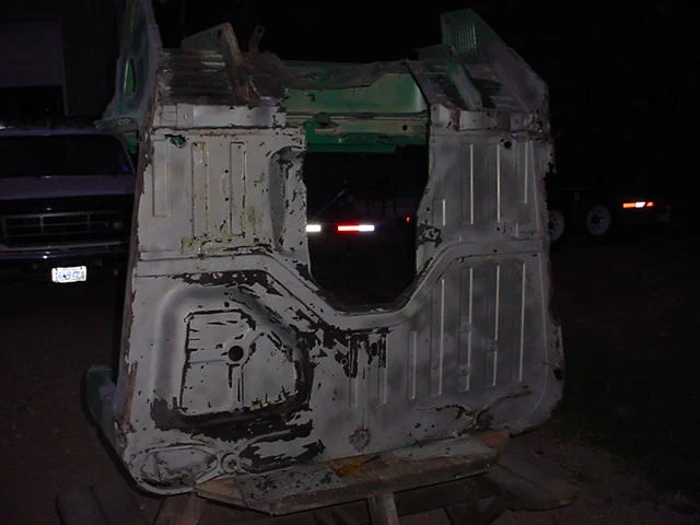

more

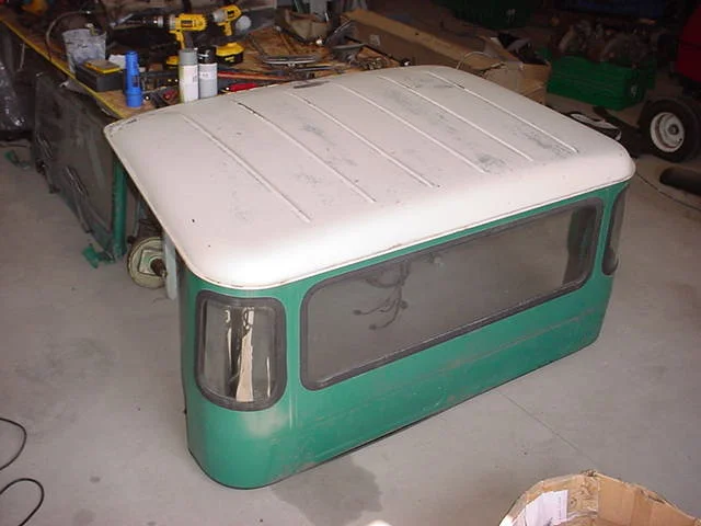

more 2

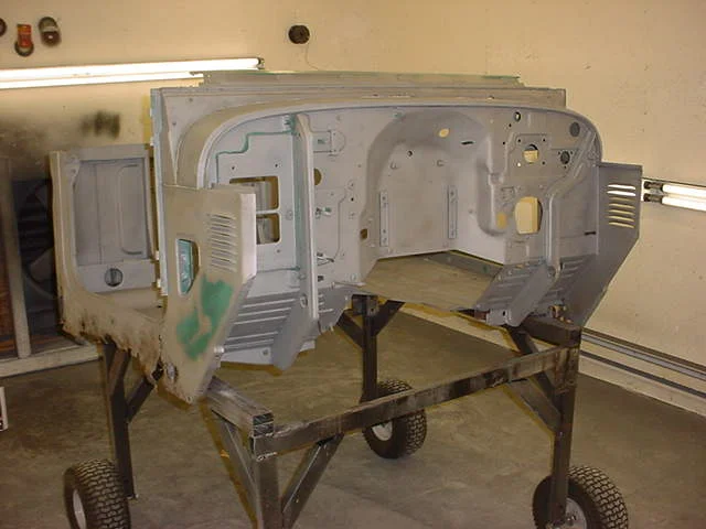

more 3

put a little seat on that baby and you've got the makings of a tractor

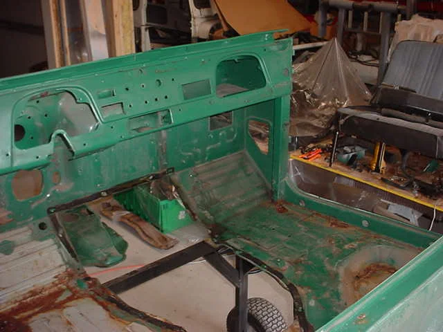

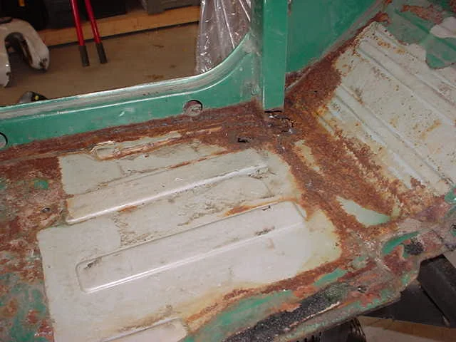

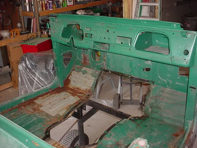

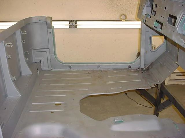

Nothing major to report, got a couple hours last night and a couple hours tonight...so obviously a total of 4 hours.
Last night I pretty much spent stripping the cab down to the base with nothing left. Not a lot of pics, but not really that exciting either. Everything pretty much came apart fast and easy as expected, it was real nice working at chest height with the cab up on that stand I made.
Took a few photos of the inside of the cab, still actually looks pretty good. Around the A pillar it looks pretty rusty and is a tad worse than I thought, but still really not that bad? I imagine it was a little worse on the drivers side when the snow melted and ran down in that corner.
Tonight I pulled the lower cab out and went after it with the sandblaster. I blasted the inside anywhere there was surface rust. It will all eventually get blasted, but wanted to blow out any surface rust and see where I stood. I tipped it up on the rear and started blasting on the bottom. I think that would go really good except for that undercoating crap on the bottom. I guess it's a good thing since I think that's what salvaged the majority on of the cab and floors on this thing. Just takes time to scrape all that stuff off
I have to work tomorrow evening so in the morning I'm going to start scraping more and blasting more....maybe I'll get it all blasted and then I can shoot some DP over the entire thing before I goto work on the sheet metal.
Matt

That's a lot cleaner than I expected. Great news. You'll have it back together in no time I'm sure.
Is that John Deere Green? Are you going to keep it the stock color?

Quote:
Yes, it is pretty clean. The drivers side A pillar area will take a few days since there are so many panels coming together in 1 area, but it really isn't that bad. I blasted and scrapped this morning for 3 hours, pretty much totally cleand and bare metal. I didn't take any pics, but I'll take some tomorrow night. Have to work all day tomorrow, but hoping to shoot some epoxy primer over the whole thing tomorrow night.
As far as the color.....I had in my mind that if I got a lpb I was going to paint it olive green/653, the same sh-t brown color as the one in that eddie bauer catalog last year, I love that color.
But since then this green color/681 has really grown on me? It's stock and it's different, I am really torn on what color to shoot it? Either one would be cool
Thanks, Matt

TLCA# 14759
Posts: 3,072

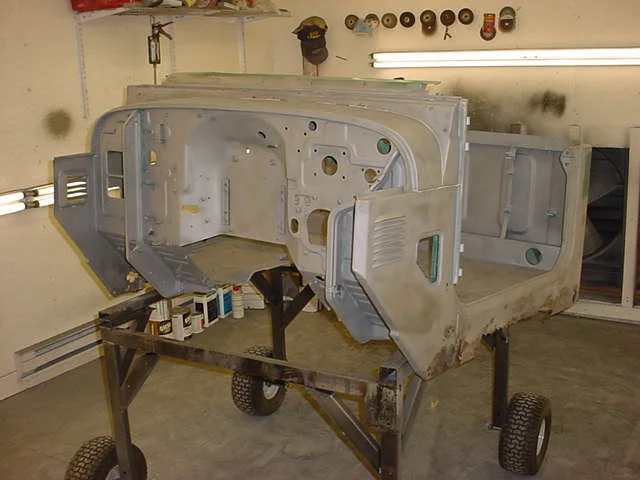

Nothing really done tonight...decide to goto a movie with the wife.

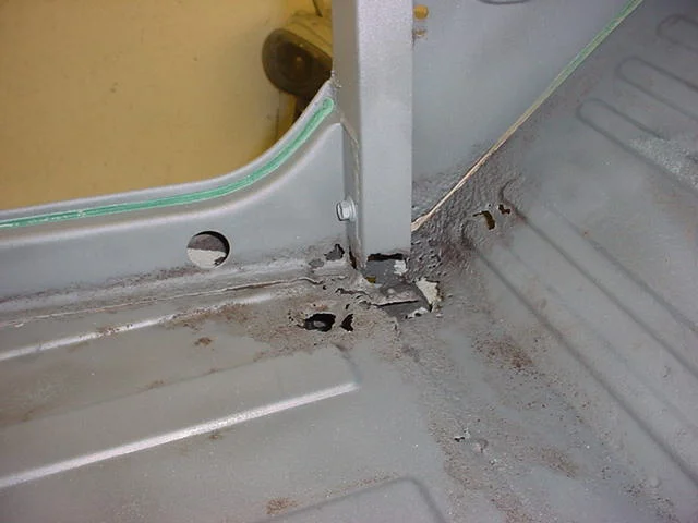

I did manage to get the body wheeled into the booth and tipped up on some saw horses. Didn't want to mix up primer and spray tonight since it was late, but it is ready for tomorrow. Little green here and there, plan on taking that off with the zip wheel, just didn't feel comfortable blasting those flat areas with the blaster.
Pics as promised of the sandblasted cab...few shots of the bad areas, although really not that hard to fix.
Matt
