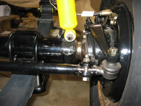

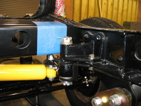

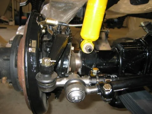

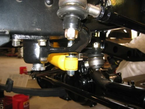

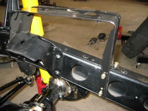

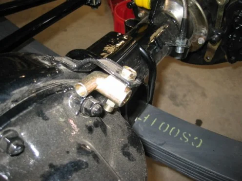

some pics
front end. let me know if you see anything that looks wrong. I think the washer on top is incorrect, looks too thick.

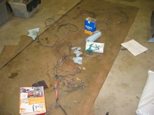

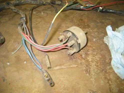

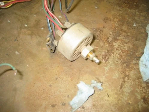

more 3
Need help with the wiring harness. It is in pretty good shape, but the diagrams I have do not match. Can anyone email me a wiring diagram for the 66LV specifically? mark@paverstone.com
The one I have is for an HJ45 and does not match?
Also, what is the switch shown in the pics? Wipers?

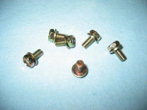

more 3

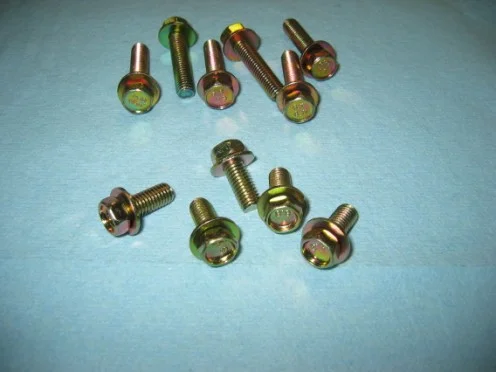

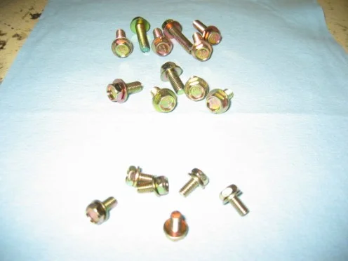

and last the JIS stuff I was waiting for.
