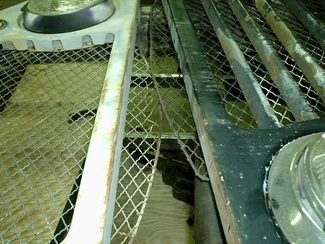

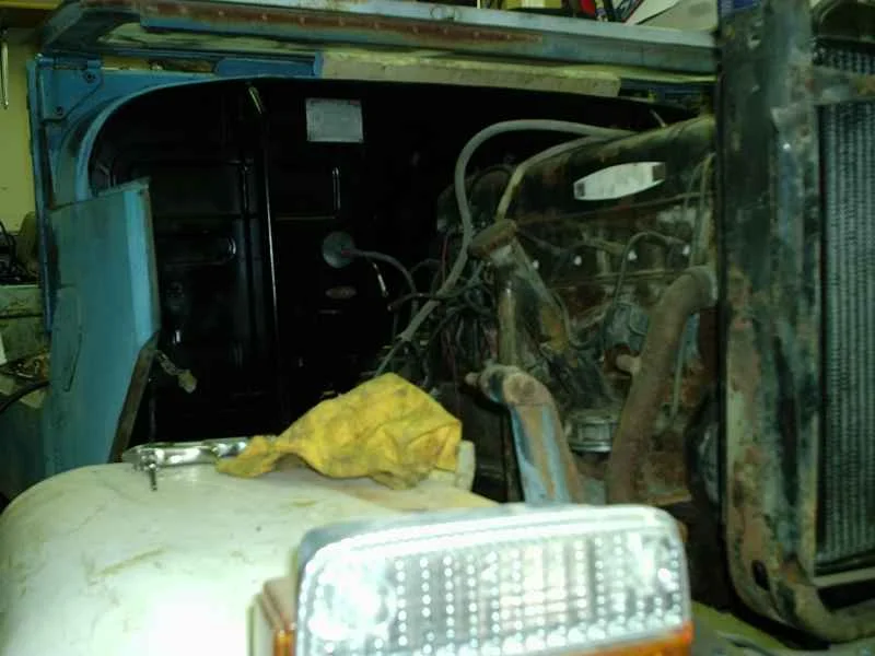

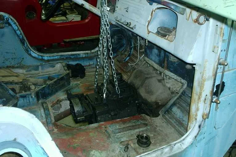

This is one of the two I got from Don, a '60 FST, he was going to blend the two together and make one, which is what I was kinda thinking of doing also, someday...then the Daughter marches in, points at it, and says:"I want that one"....through the mystical workings of Garage Politics "Two Speed" is the number one priority, room has been made, other distractions placed under tarps, now I'm focused like a freakin shark with a laser beam on my head....right....
All guesses are that this rig came from South America, probably because the VIN tag and tuneup data on the valve cover are in Spanish. The only oddities are the swingout tailgates with sidemount spare and side facing seats, and no holes in the dash for the tire pressure tag.
This is going to be a functional restoration, as 25 as possible but not pretty just yet...I forsee some designer teenage Krylon color scheme and carnge, good paint if She ever comes to her senses. I'll detune the 1 bbl and retard the timing, see if she catches on...
That be a tranny going in

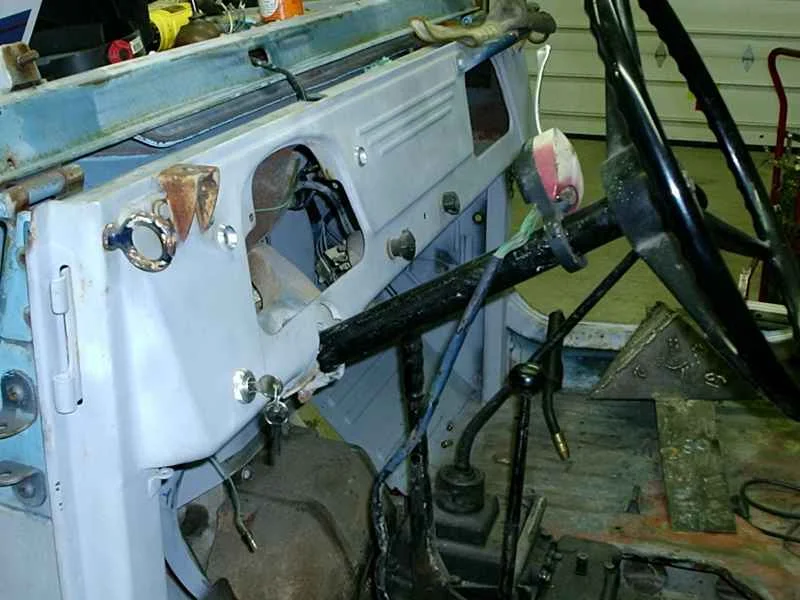

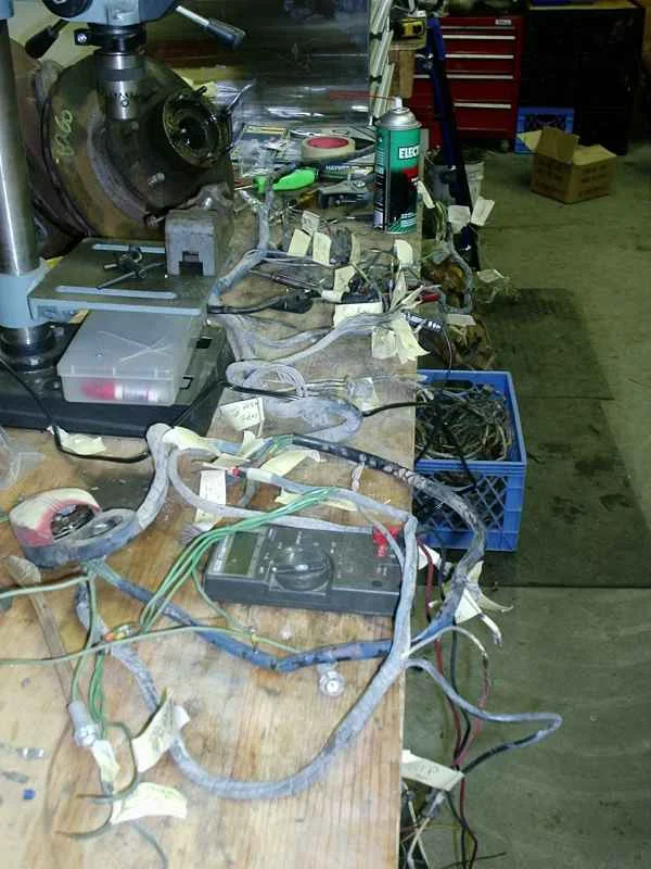

Cleaned up the dash, removed and repaired the wireing harness, filled holes

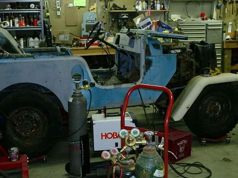

Welded up old heater hose holes on the firewall, then rattle can

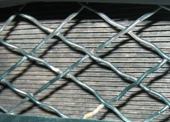

Right now I'm trying to get the windshield back in shape, removing broken wiper screws, repairing the broken stud on the right side ws hold "up" thingy, which bred three broken screws holding the thingy to the ws...so I might as well do the left side while I'm drilling and taping

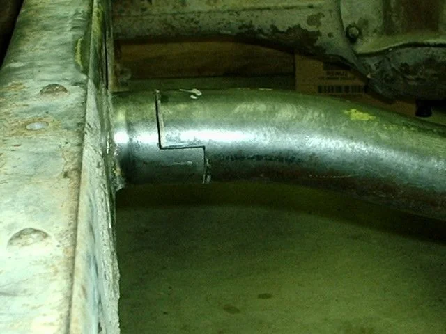

The body is coming off soon for rust repair and frame repair but I have a dilema: what should the orientation of the cross member behind the transmission be? It is missing, I have a 25 replacement, should I go stock and have it bow down or anticipate sometime in the future a later model trans and weld it in bow up? Will a FJ40 tcase even clear a centered bow (up), as the 40 cross member has a kinda offset bow to it? I plan on using the stock four speed for now, just hate to do this cross member twice...
Thoughts?

Thot. If you make the crossmember a bolt in, with pre-threaded plates welded to the framerails, you can bolt and unbolt different tubes as the need arises. I made a crossmember like this for the last 40 series that I put a 4 speed into.

That's what I was going to suggest too........... a removeable one with flanges that way you could change it later. Or just put in the original crossmember and do a SM420 with a minitruck case.

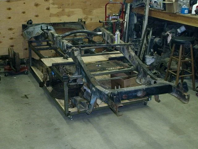

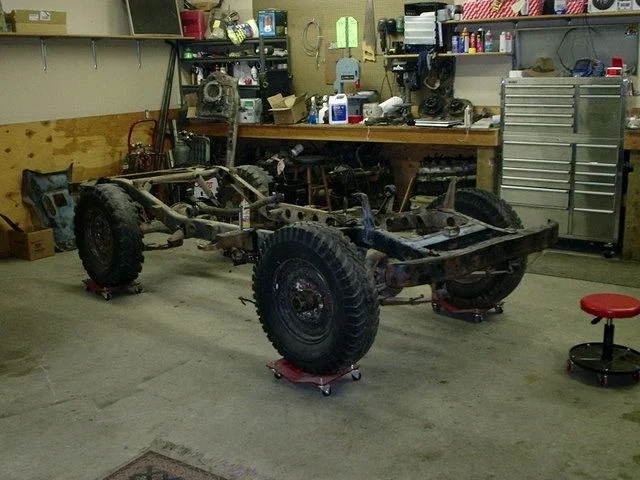

Tonight's progress, no suprises, getting it ready for the sandblaster...I've blasted frames before and I just don't want to do it anymore!

Project Two Speed's original color was grey...yes, a painted frame soon I hope, though I just got an estimate for blasting a frame, four springs and five wheels . I'll be buying a honkin big blaster and a ton of sand and still be coming out ahead
I chose the low road on the crossmember, let future generations worry about tranny choices!

The cross member and some of the underbody support sheetmetal was cut to make room for a later model four speed, and later suffered from some sort of drive shaft disconnect...the body is tore up pretty good underneath but repairable

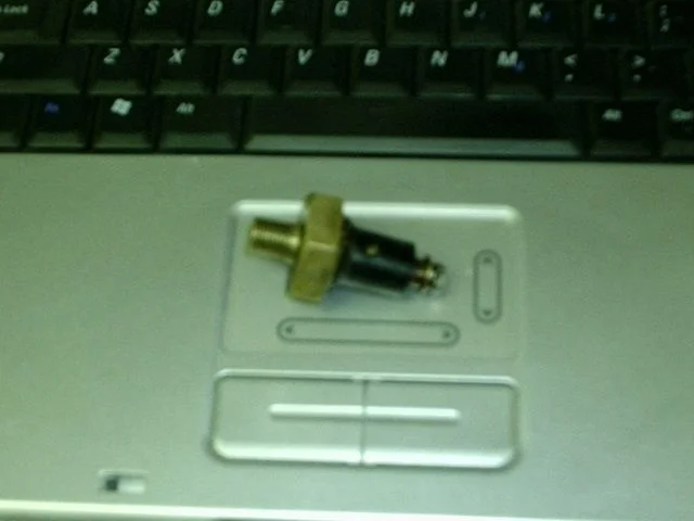

This is where Two Speed comes to a halt for a couple weeks...oh, and found this oil pressure switch in the frame rail!

Can't make out the switch, but if it's got a screw terminal it's probably the original switch for the light.

Yep, screw terminal...I was high-grading parts and taking decorations off of the wall when I noticed a difference in grill meshes, one has about double the crinkles per inch than the other, anybody else notice this?

The white one is a 1960 production year "model 1960", while the black one is a 1960 "model 1961"...though I do have a 1959 Model 1960 crinkle-ee one and a 1960 model 1960 uncrinkle-ee one....my guess is they can go either way, though I'm just now noticing the difference
OMG...we don't need crinkle cops, do we?

I'll check mine.......bets one whether the three are different?

One extra-crinkle and two crinkle light. With the extra-crinkle in the middle of the consecutive numbers.
