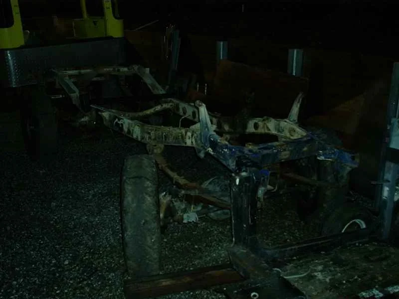

Everything is dissasembled now, the (temporary) sprung over frame has been pushed outside and has had a bath, It's amazing how good the 46 year old cream colored paint has held up. About 10 lbs. of mud and rocks are now removed from inside the frame channels. I'm doing the metal fabwork on the tub before it gets media blasted. 165 holes needed to be welded up or patched. So far about 100 are done. The large parts to fix are the 3 gauge holes in the dash, the radio cutout in the dash, the 5" dia. holes in the rear from resessed tail and stop lights, and the normal cruiser rust in the back channel. I had a local sheet metal shop brake me a new c-channel to replace the bad one, $4.67, Must be some profit for these aftermarket sheet metal parts. I hope to have the tub all welded this weekend. John Pardi

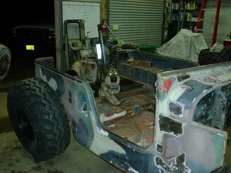

I conducted a suprise inspection of the Pardi garage last night, found him marking the wheel wells for slightly larger tires "while the sawsall is out"...Sadie the Merciless rides in expansive cargo area

Temporary spring over is still sprung

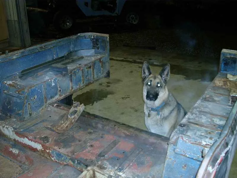

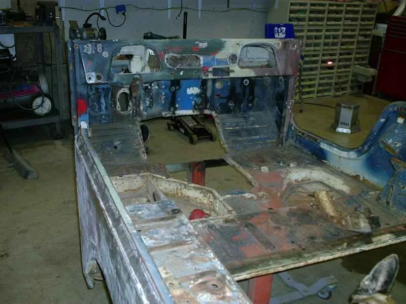

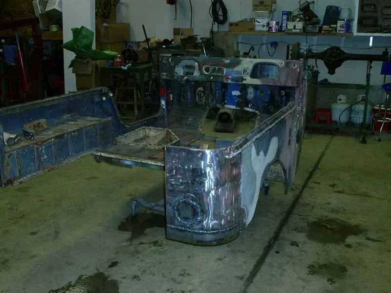

Lots of extra holes are filled....rust repairs underway...things are coming right along! John showed me a possible factory heater switch, I shoulda got a pic of that...impressive parts piles!

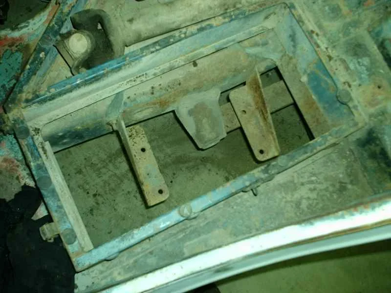

John- a pic of the battery tray brackets on the frame....

Are those two seperate brackets for the battery tray?

Those are the two brackets that bolt to the frame. There is a third piece that the battery rest on with the tie down. If I remember correctly the tie down runs across the battery the long way not the short way like the FJ40. I thing there was a good picture of the battery box in those pictures I emailed you a while back Mike.
