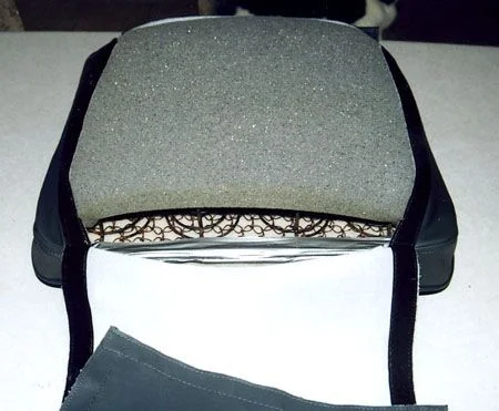

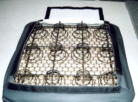

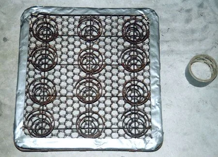

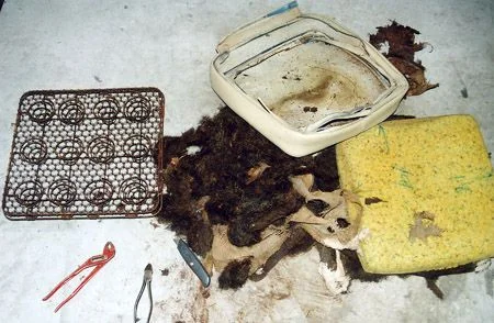

Contrary to SOR's recommendation that I seek professional help (a real upholsterer), I decided to tackle the FJ25 seat covers myself anyway. Here's how it went:

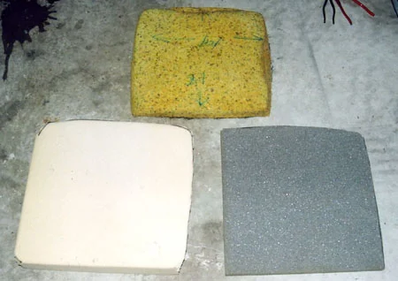

I bought 1 inch, 2 inch and 3 inch thick sections of seat foam from an auto upholstery shop for a total of $30.
(The drivers seat procedure is identical to the passenger seat.)
1. Stripped off the old covers. Yikes, it's scary inside of there!!
2. For the bottom part of the seat, I used the old cushion as a template to cut both a 1 inch and 3 inch pad.
3. After cleaning up the spring box and even though the edges were pretty smooth, I ran a strip of duct tape around the perimeter of both levels just to be sure.

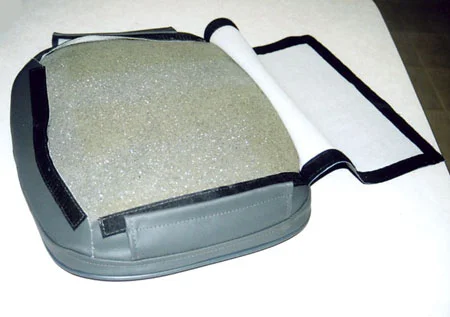

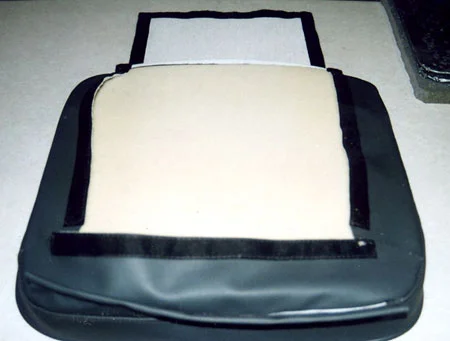

4. Inserted the 3 inch foam into the new bottom seat cover. (Center it until it's perfectly situated.)
5. Centered the spring box on top of the 3 inch foam.
6. Placed the 1 inch pad over the spring box. (It acts as a buffer between the springs and the bottom fabric.

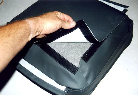

7. Start tuckin' and firmly (but carefully) start lining up the Velcro strips. It's going to seem like you're trying to put double size sheets on a king size bed, but with some compression on the springs and foam, it will come together nicely.
8. Flip it right side up, and here's how it looks.
9. The back cushion is a piece of cake. Just use the original cushion as a template to cut the 2 inch foam to size, stuff it on in there and seal it up.
(The supplied upholstery wires are for slipping into channels of the attachment flaps for reinforcement. Trim and round the wire ends as necessary.)

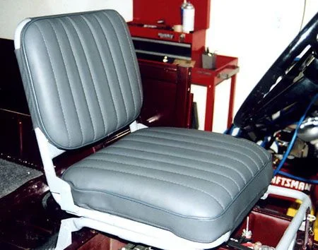

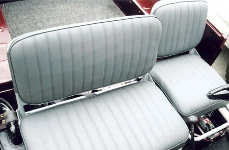

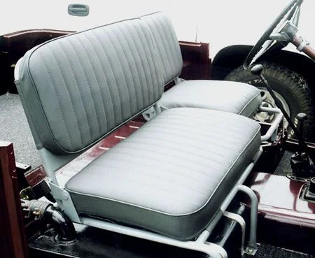

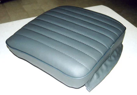

10. Re-attach your new cushions to the driver's seat frame, making sure the channel wire is up against the edge of the flaps before you insert your screws.
11. Do the same with the passenger seat cushions.
12. And, you're done!!
Total time for a first-time auto upholsterer to do both seats: 1 hour 25 minutes (including picture taking, a cold piece of leftover pizza and three cups of Starsbucks).
