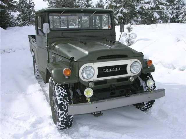

It's probably sacrilage to post an FJ45 pic on the FJ25 forum, but I thought I'd show off how these things look mounted....

Very nice.............now who has a line on a fog light switch.

Looks Great!!!

Dave, Those look great!
Did you use a 10mm carrage or a 7/16?

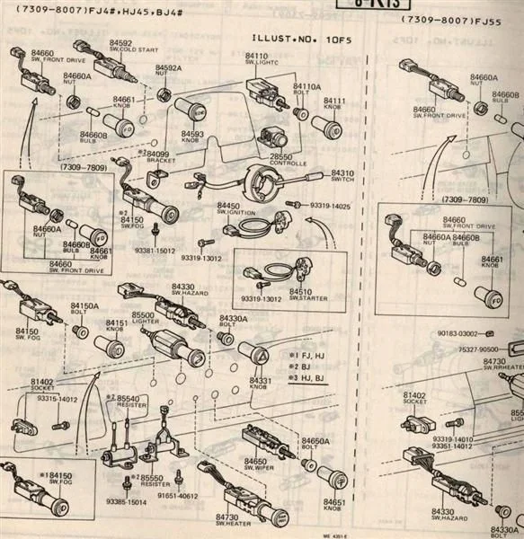

Could this be a fog light switch? Looks exactly like a regular light switch except it has 6 posts instead of five, three position, markings on the back SS RF LF and so on?

The proper carriage bolt from the figure is 90112-10007, but when I checked with CDan, it turns out those are no longer available. The shorter 90112-10004 carriage bolt is still available, however (goes into the bumper gussetts). As it turned out, those were long enough and worked just fine! The square hole in the Fog light bracket looks like it should be a 12mm, but the hole in the bumper is for an 10mm. Both of those bolts are 10mm, so that's what I used.

The FL switches I've seen (and the one Landpimp has) match later light switches (like my 1971) and had yellow paint instead of white, but otherwise looked the same from the outside. (See figure, left lower hand corner)
But it makes sense to me that the proper early switch would have a 6th terminal and have an extra setting for fog, combining two switches. Dunno!

my book says the nut is a 10x 1.25. so that's a 12mm plus the 7/16 carriage I have fit the bracket tight. Does the 8mm carriage square spin in the bracket?
