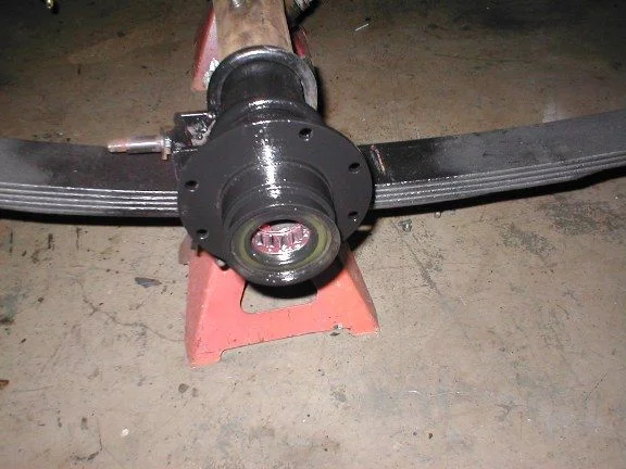

Wow, it really has been over two months since I did anything with this. Here's the rear after Mike cut the perches and welded up new ones with the pinion standing proud.

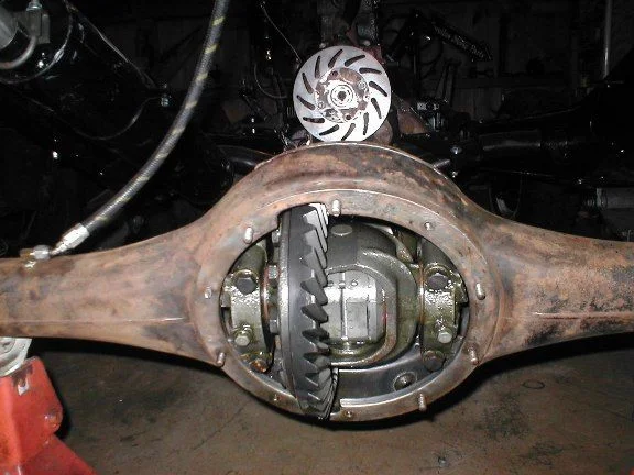

Transfer case disk brake from All-Pro, I'm going to have to redo the mounting bracket to make it work with the FJ25 parking brake lever.

Well, now the oil fill is too low.

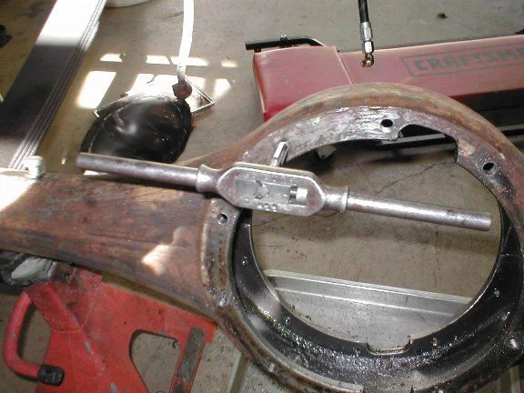

Anybody else would weld in a new half coupling and put a pipe plug in it. Too easy, I cut out the old cover and flipped it over.

I think the relatively common way of handling that is to cut a rectangle around the fill plug, flip it around, and weld it back in place.

There I go reinventing the wheel again. I figured the easiest would be to blast a hole in it, weld in a 3/4" half coupling and stick a pipe plug in it.

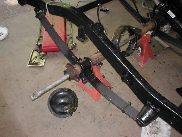

John sent me a "good as new" 10 spline third member from an early 40 with a lock-right installed. So I commenced to rebuilding the rear last weekend.
Here's how I remove the rear wheel bearings. There's probably a right way to do it. Good news here is that everything (rear wheel bearings, seals, c-clips) is the same as the early 40.

Not peculiar to the centered rear axle.....just early ones. The third is attached with 8mm studs not 10mm common to the later diff. The PO had just stuck the later diff with the big holes on the housing with the little studs, and I found the diff rotated on the studs (should have taken a picture). I doubt the misalignment was doing it any good. Anyhow, I drilled out the holes and retapped them 10mm x 1.25.

After fiddling around with the lock-right I finally figured out what I was doing wrong.............then I read the directions.
