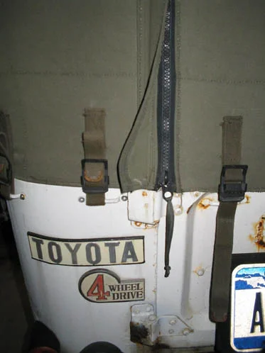

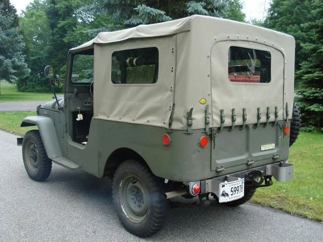

1st pic is my truck for a clear pic of the webbing....looped back in
2nd pic is FJnotCJ's truck oem canvas....looped back in
3rd pic is the copy of that top...made by badger coach works....mike fox's truck....not looped back in

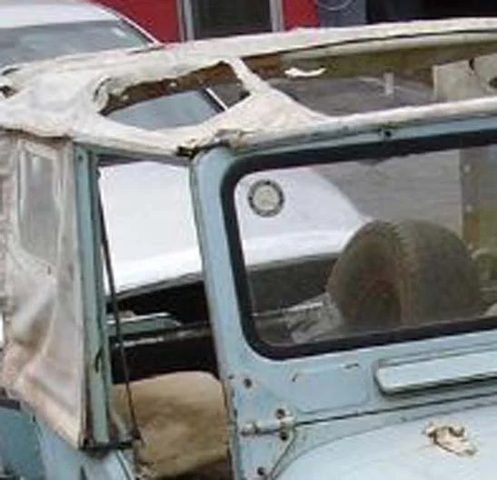

as for the windshield corners
1st pic snap, second also snap
3rd pic no snap
there is also the acorn nut whick was also oem....i dont have a pic of an oem top...but...do have a repro top pic

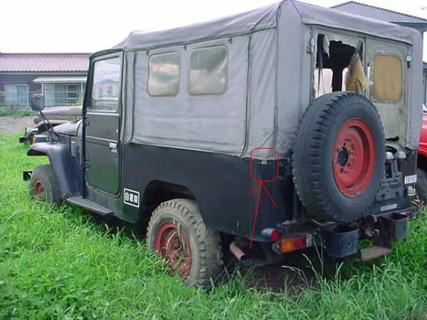

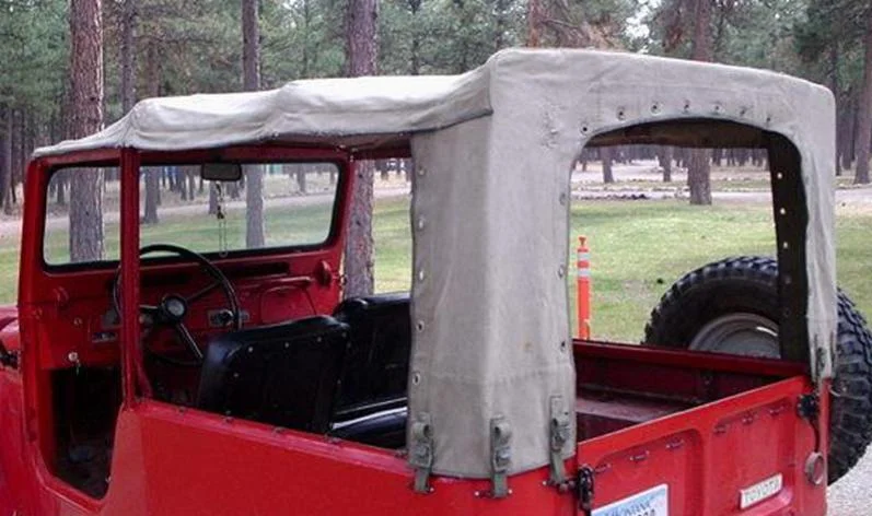

This is a 66 soft top I believe, dont know if If has a OEM top ether,
I noticed this top looks like had snaps and no straps,
note my 66 did not have any foot man loops on the corners

the straps on quite a few oem vinyl tops were located under the vinyl....not on the exterior of the vinyl.
but....i do not see any straps dangling under your making me question this one now...it could be one of those early kayline made replacement tops you would be able to buy thru toyota.
the 5 and 7 window was a much later versions than 66...66 should be a 3 window afaik
