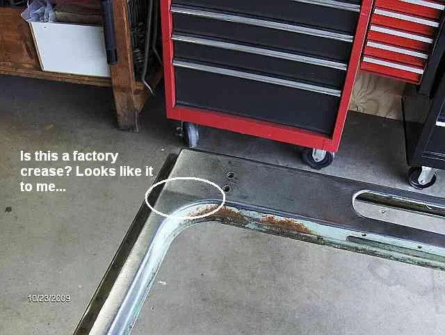

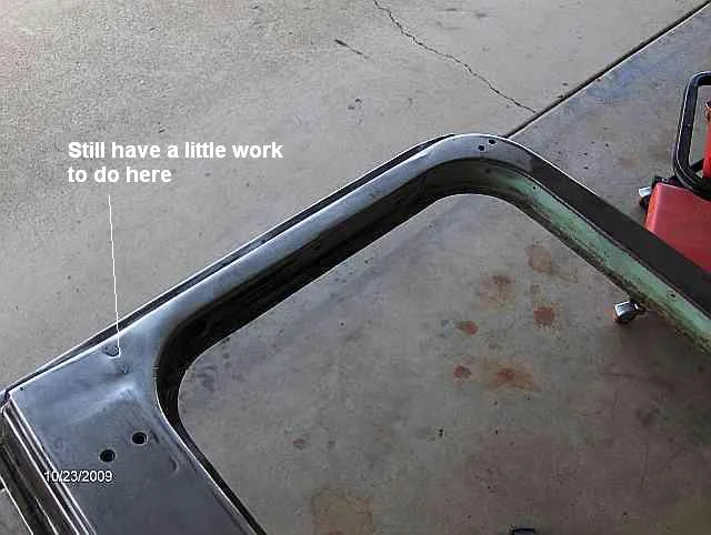

Hi all, Well I worked on the windshield frame again today. I think it went really well for a man of my talents! I pulled on the dent and got it to look pretty good. Still a little left to be done but I had a question before I go any further. First pic is of the dent after pulling it. I made a couple of pieces of steel to kind of fit the shape of the dented area . I drilled a hole in them and welded a nut to the back side. Then a drilled a matching hole in the dent. Inserted it into the W/S frame attached the bolt then whacked it with a slide hammer. Took a piece of brass attached it to a pry bar and held it up inside the frame and proceded to fill my hole with a wire feed welder.
Name:  WS frame a.JPG

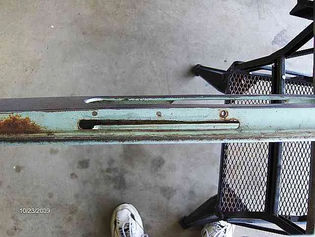

So before I finish this side of the frame I need to know Is the crease in the next photo factory. It kind of looks like it is but I want to be sure.
Name:  WS frame 4a.JPG

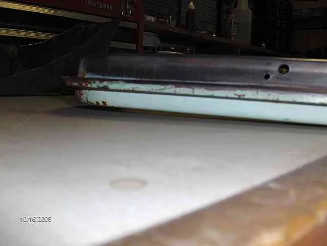

Then how about these holes. The one in the center looks like it was factory drilled but the other 2 look PO to me. Both vents look the same.

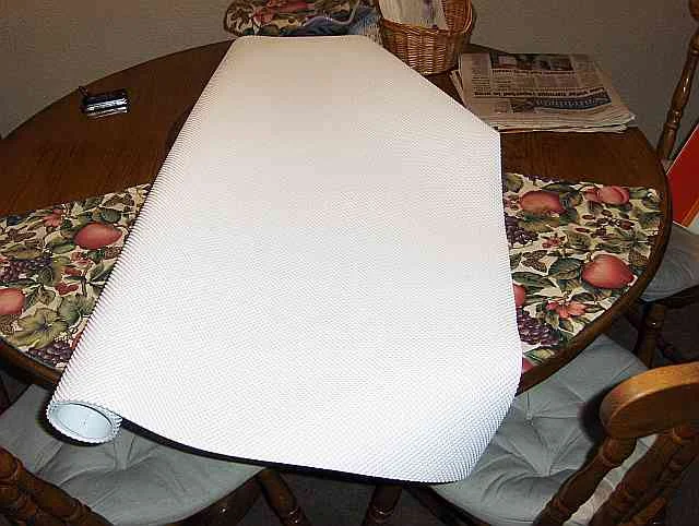

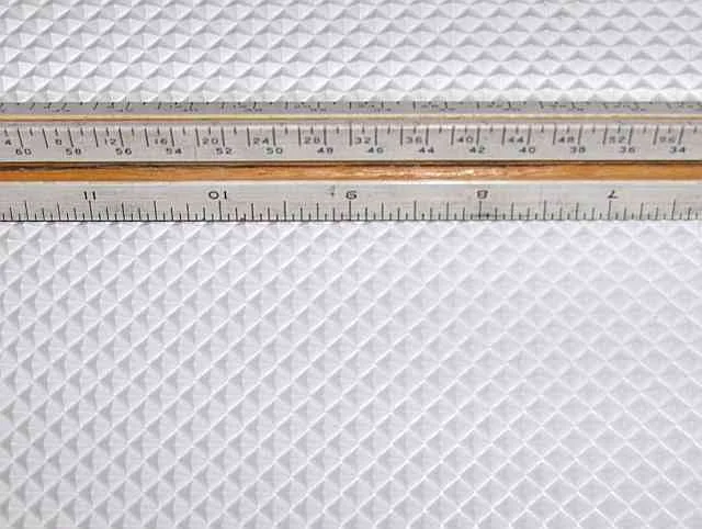

Pyramid Vinyl
Well I got my Pyramid Vinyl Monday so I thought I would add a pic or 2 to the thread. My next free time will be spent making a template to cut the vinyl so it fits correctly. Also I need to research the correct layout of the pattern. I think it's straight on the outer edge but i'm not positive.

I got a square yard and it cost me 36 or 38 $ I don't remember but that included shipping.
Still looking for some feed back on the holes by my windshield frame vents in the last photo in the previous post.

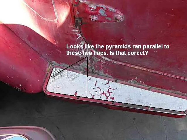

Pyramids are square to the outside edge. So you need to cut your material at an angle. I had a post or thread about it here somewhere.....

pyramids
I searched but didn't find much. I did find a decent photo that i shamelessly stole from 3jvj. The matt looks to have been installed the way I was thinking. I made my template today since it was raining. I may cut them out tomorrow. I think this is what you were describing Cruiser_Nerd. am I correct?

Hey...very cool! Did you buy the roll from that place in NY?
That is a lot of material! How many you figure you can get of it? I was thinking of buying 24" x yard, and I figured I'd have more than enough for a couple of sets, as I only need two...maybe three sets...always nice to have spares
Oh, and I believe that you are correct in the orientation of the pyramids, as this is how they were on my old short runners I got from John last year.

[QUOTE=My wife said no FJ!;4946444]Hey...very cool! Did you buy the roll from that place in NY?
That is a lot of material! How many you figure you can get of it? QUOTE]
Ya I got it from Canal rubber. I ordered it quite a while ago. They said they were out but it had been re-ordered already and they would ship it ASAP. I actually thought that they had lost my little order and ws going to call them again when it showed up.
Not sure how many I'll get from it. I'll post up something later. The sun is shining so that means I have lawns and gutters to do first. While I'm doing that I'm sure the list will grow if you know what I mean.

Rod,
Yep, what you have pictured is correct. Here's a thread from when I did it:
http://forum.ih8mud.com/fj25-owners-...skid-step.html
You have to cut on a 45* angle, so you get a lot less out of the raw material than you could otherwise.

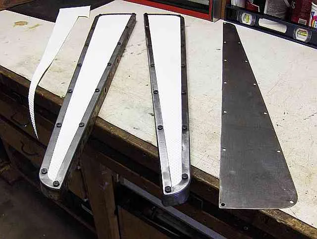

Well it's time for a small update. I cut some of the matt for the running boards and fitted them. One side turned out good and the other is off 1/2 pyramid from end to end. I'll use that as my daily driver and replace it with a correct cut if I meet someone I want to impress.

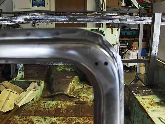

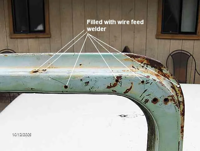

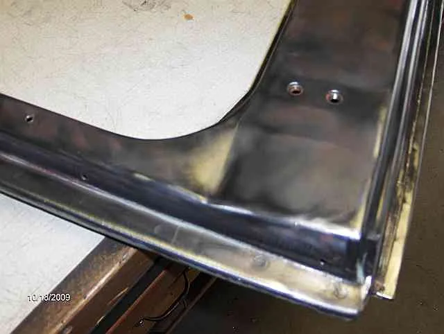

I've also completed the filling of some of the holes in the windshield frame. It went from this
to this
Hopefully the rest of the holes will come out as well as these did. I sure like the idea of them being filled with steel vs. some form of bondo.

Icantdive55 is offline   Reply With Quote
Old 11-20-09, 04:45 PM   #48 (permalink)

Posts: 1,185
nice
looking great man
Running boards look sweet!

Thanks Destin, I know the fasteners are not OE. I used them because they were easy to get my hands on and I wanted to check the fit. The correct Phillips head screws are in a bucket somewhere.
Rod

Now I understand why you needed so much mat...you have the long boards.
Looking good...and that frame looks like it never had those holes
