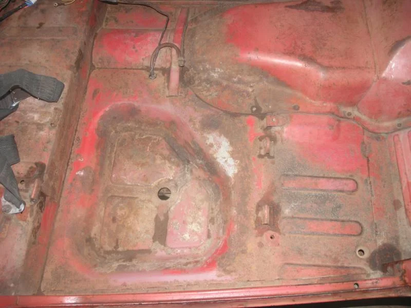

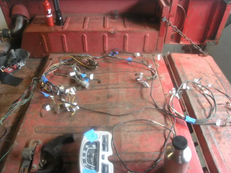

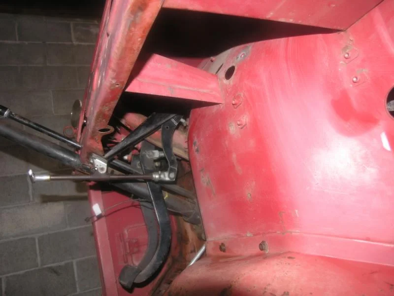

have the electrical harness out
Thanks for the tips on getting it out!

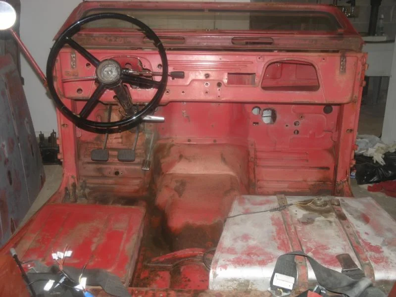

more photos

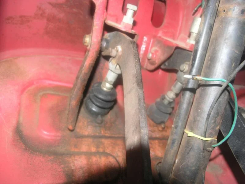

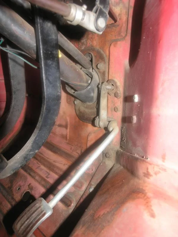

more stuff

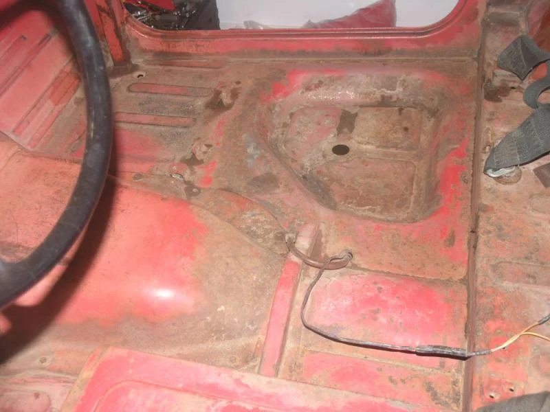

few more

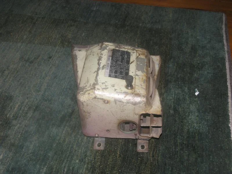

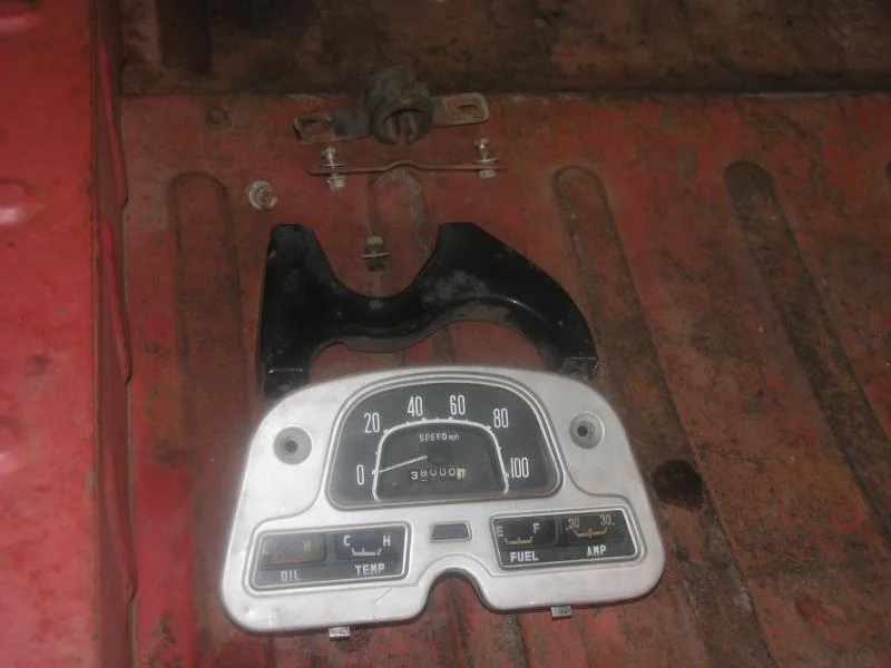

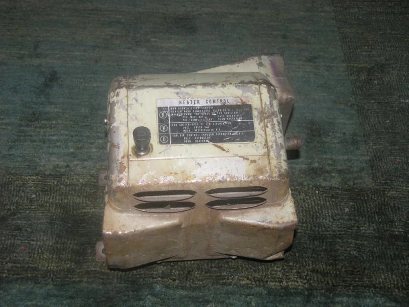

correct heater?
Would I paint it the same color as the body?

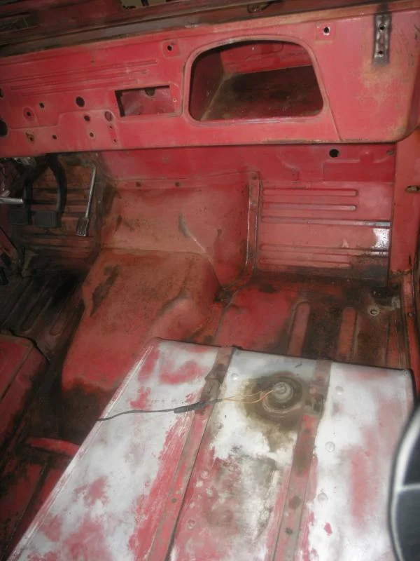

more photos

Sorry Destin, that heater is too new for your cruiser, that heater requires duct work to the firewall, a hole in the firewall, and a blower motor on the engine side of the firewall. I have only seen the aftermarket square box heaters on early FJ40's. John Pardi
pardion is offline   Reply With Quote

Ah bummer :(
Ah well the search is on

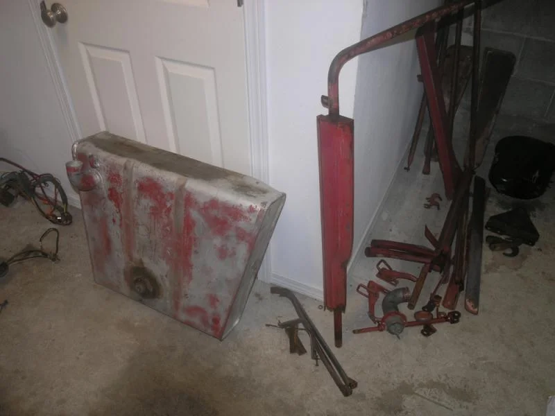

pulled the tank out today during my lunch break

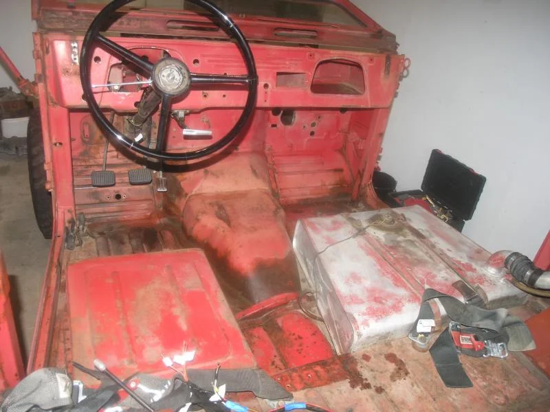

A few more shots

for what? Stock was no heater. IMHO you could clean that one up and either put it in the middle and move the fuse block or put it on the passenger side. even though originally that style had a fresh air vent you could use it as is. None of the dealer installed heaters had fresh air either.
But the aftermarket heaters had a built in blower. The factory heaters had the blower on the otherside of the firewall with a duct to connect the two. Unless you want to cut up the firewall you need to go aftermarket or find the early Nippon Denso.

someone PM'd me with a correct heater...
I will hit them up tomorrow
If I cannot find one it will be alright anyway.
I will be driving it mostly in the summer anyway

no defrost tho... I bet you could use that in the rainy nw...

This is another reason I think Toyota had some aftermarket heater kit available for the early FJ40s. Remember in the late fifties early sixties Toyota use the Land Cruiser to get a foot hold in the American Market. Sales were measured in hundreds not hundreds of thousands like today. I think Toyota saw a real need to have a heater available in the North American market and made it happen with a aftermarket kit. Somewhere during 1962 Toyota started installing defrost vents but the heater wasn't a factory option until the 1965 model. These defrost vents seem to be something that was quickly installed into the 40s to meet a demand. They weren't really thought out that well. Can't fold the windshield down without removing them.
I would really hope maybe we can get Shane to reproduce the Johnston label for this heater. I know I have at least three maybe four.

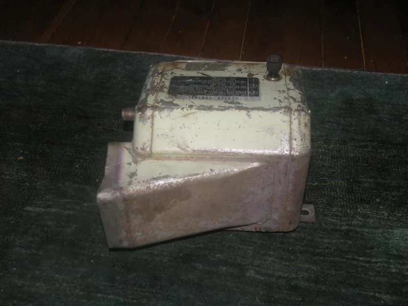

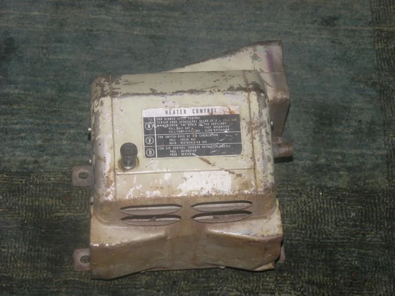

Here are some of Living In The Past's heaters.
One is from a 62 soft top tub. The other is from a 65 45LPB. Both are from the mid CA area. The third is a Denso heater that was in one of his FJ25s. Don't know the story on it. Not sure where it was installed. Attached Images

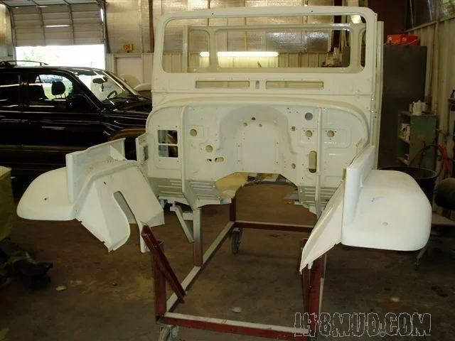

Is it bad to leave the windscreen on the tub when they spray the tub?
I have seen a few cats do it ( this photos is from a resto thread in the 45 sections , this is not my fj40 )

Quote:
I think so. There are way too many different surface angles and the interior of the frame to do it on the body. That said, whoever sprays it may want it on so that the finish blends between the body / hinges / frame. That means you'll have to completely cut in and spray the intricate parts of the frame, and mating surface on the tub, mount the frame and then overcoat it when mounted. A detail oriented bodyman already knows that though.

Quote:
Originally Posted by 3jvj View Post
Beautiful work. Super jealous. It will be years until I get to where you're at.
That last photo is not my rig, that was jsut to illustrate the painting with the windscreen on the tub
I almost have the tub ready to remove however
Thanks
