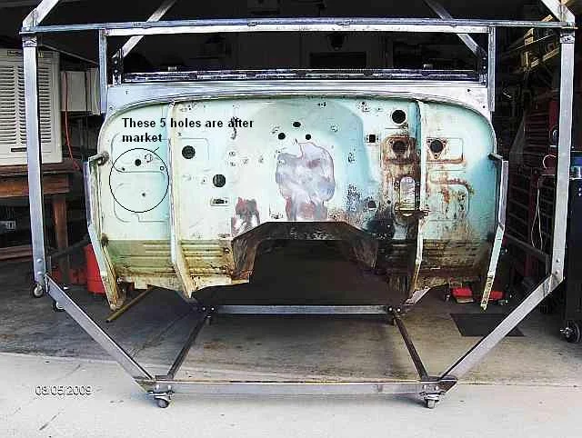

Sorry about the poor photo. I know the five holes on the left are for the heater (aftermarket). The three smaller ones are mounting holes and the other two are for the hoses. All other holes are OE as far as I can tell.

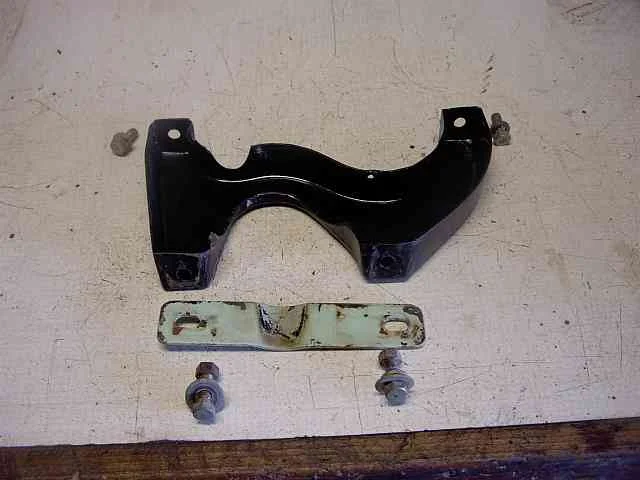

some more phone photos.
letting alot of stuff soak for the time being...

Troublesome indicator/display consul.
parts
tub shots:
Need to figure out a way to best blast and paint these...
Probably should just pull the wiring and rewire

Speedo cable
I removed this part from under the dash and it allowed me just enough room to grab the speedo cable and remove it so that the instrument cluster would fall out.
Rod

Quote:
Rod
Nice
So remove the steering support and It should allow some room?
I think I may want to remove the steering wheel first... need to pick up a steering wheel puller tomorrow
Thanks man

The ends of you speedo unscrew at both ends. Can you get a pliers on it. I've had to start to unloosen them with pliers before and then was able to undo by hand. Lay some thing soft on the floor and lay on your back. Using a flashlight it should be easy to figure out how it unscrews.
Living in the Past is offline   Reply With Quote

Quote:
Thanks
I will bring in the flash light tomorrow and get it sorted.
Excited to get the wiring harness out.
