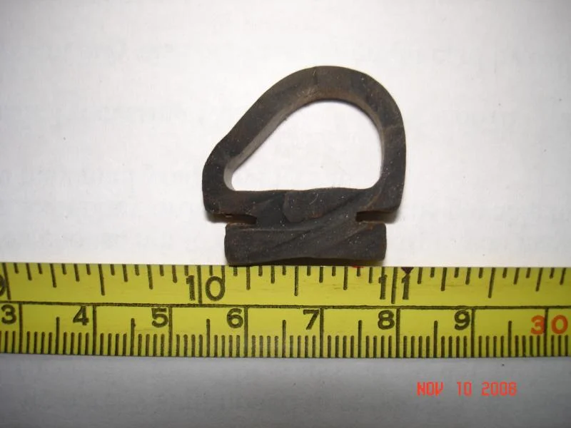

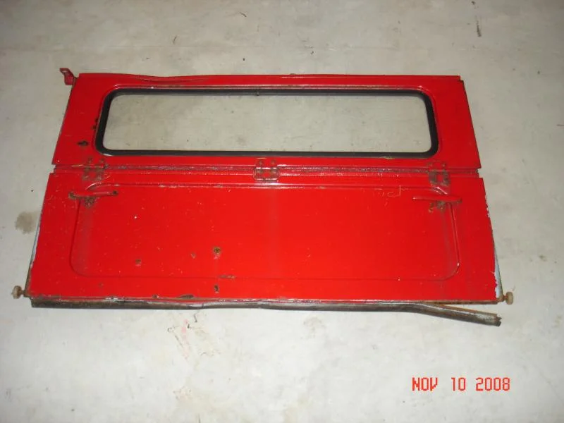

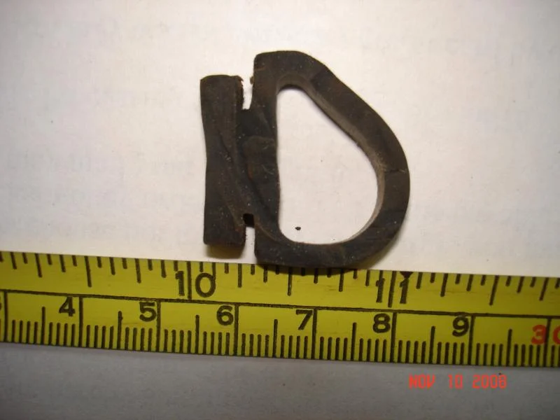

Here are some pics of my door and a x-section of the seal. I am going to send some pics and dimensions to some manufacturers and get some quotes. Looks like I'll need a minimum order of 250 feet. It will take around 10 feet per door. I'd probably take 25 feet to allow for two full replacements plus some extra.
As soon as I hear something back, I'll post some options and costs to see if I can get any commitments to buy.....

I think that piece needs to be half round vs oblong on the one end. I dunno if they can shape that piece or not.

I think the original shape was half-round, but the seal was compressed over the years and became oblonged. I'll try to find a piece that is in better shape for submitting to the manufacturers, if not, i'll explain to them that the equivalent half-round section would be satisfactory.
Also, based on some material selection tables that I found on one of the manufacturer's website, it appears that EPDM would be the appropriate material for this application. I'm not very knowlegeable about the various "rubber" types, so I appreciate any input on EPDM or any other material you guys think would work.
