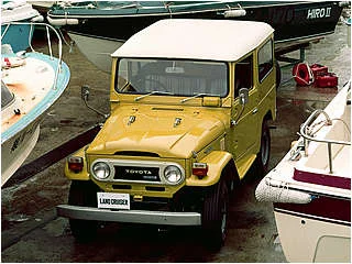

Yeah, if you just like the look I'd just change a few body parts and make a bib.
This is my 40.

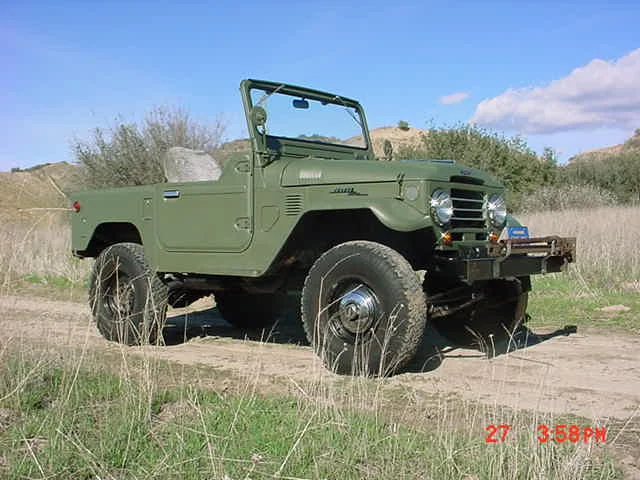

Usta look like this:

If I had an FJ40 I'd most likely leave it alone...But that O.D. green 40 is sweet! My deal is that I may have access to extra running gear for the 40 series, but no body parts. So if somewhere off in the distant future(my 55 will be keeping my hands full for a while and I have another '62 Scout that I would like to do things to) I came across a 25 looking for a new home...
