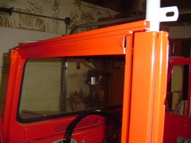

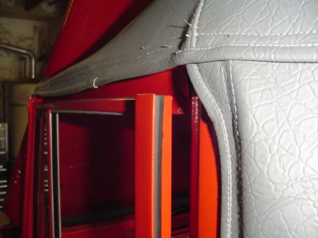

Here's some pictures that show the top of the door frame hitting the lower section of the soft top channel.

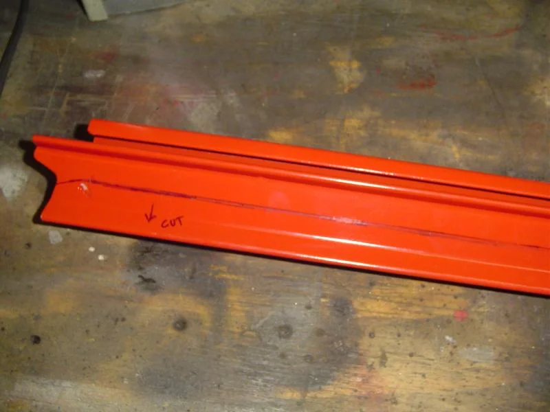

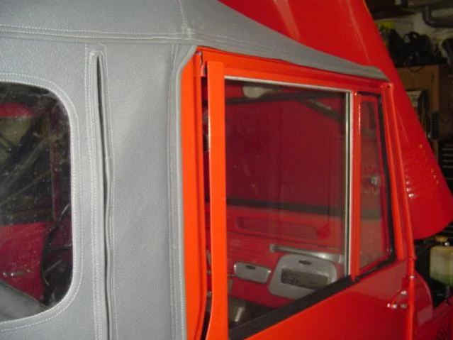

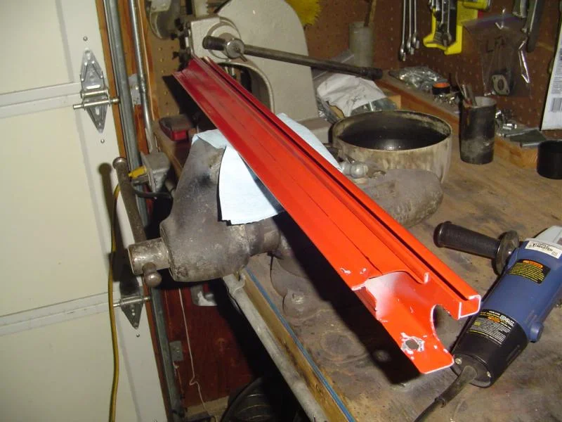

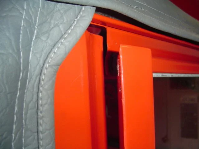

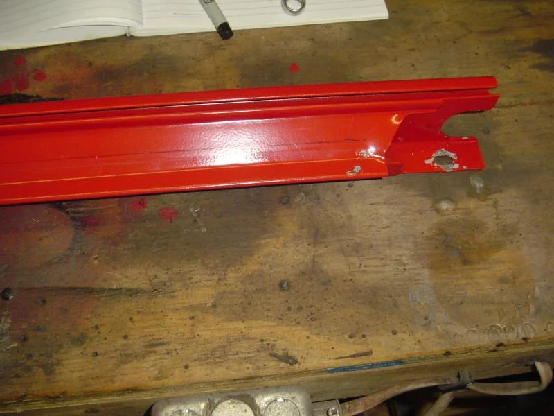

I went ahead and cut the driver door bow tonight and rewelded the cut peice in at a different angle. I ended up cutting a 1" section out of the bow. Now the door shuts and seals good! And it even looks prety OEM! Just need to repaint. I know this is totally the wrong forum for this, but I'll post some pics of the fix. I'm just exited that it turned out for the good!

The cut... For whatever reason, I cannot seem to post the rest of the photos?

since you dont have a star ....you can only post soo many pics...if i had a star ...i would post them up for ya...but...as many here in MUD i'm poor
if you remove the 1st 2 pics you can post a finished piece and an installed finished piece
I would have done the same Glad it worked out for ya.
