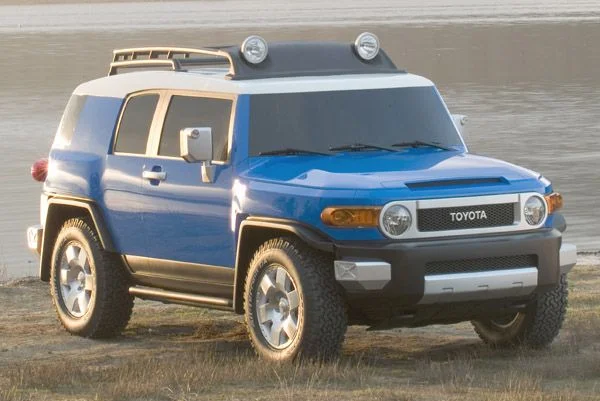

My guess would be yes, but I would bet that it will be somewhat redesigned.
*EDIT* Well, not on the original concept because the roof rack was much more compact and situated on the front of the roof.
*EDIT AGAIN* Here is a photo I dug up online. It will look like this.
