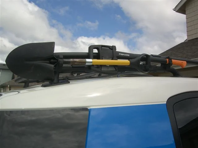

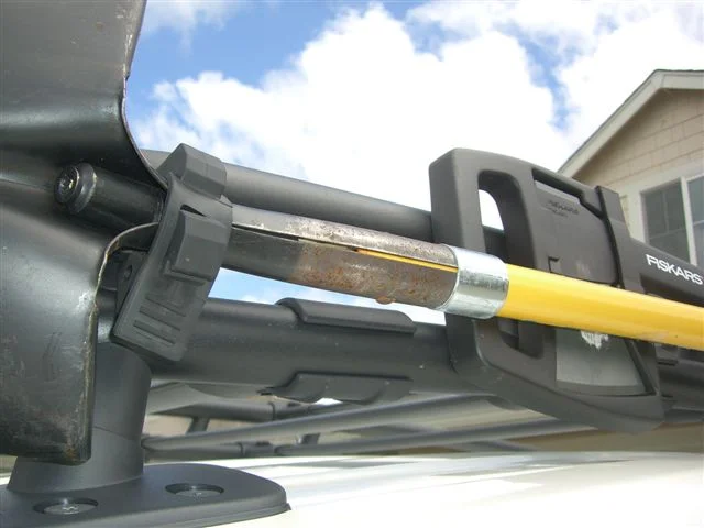

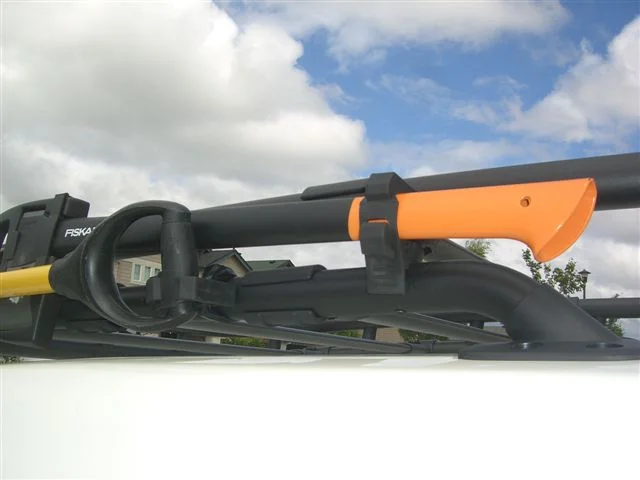

I used a Fiskars axe with the head mount it came with, and three Quick Fist Clamps mounted to the rack with hose clamps. I covered the hose clamps with electrical tape so they match the black rack. So far it's been working great. I used both of them last week in the snow.

BigBlue, thank for the picts. I think that might be the way to go, quick access and secure mounting, gotta love it.
I'm planning on getting the Gerber Extra Long axe, basically the same as the Fiskars you got there. Glad it's a good choice!

I'm happy with the Fiskar axe. It cuts great. I'm also happy with the mount although, I am a little concerned about security up there. It's very easy to remove.

I just got my quick fists today so dad went down to the hardware store. Got a 3ft fiberglass shovel with the grip handle (like BigBlue's but red with a hammer battleship grey blade) and my dad, always thinking, got U bolts and plates instead of pipe clamps. I put up the shovel just now and it doesn't move, period. The u-bolts work GREAT! I'll get some picts of how it works out when my axe gets here on Monday and I put it up. My CB also came in so I gotta get it put in as well. And the best news is my Gobi ladder will be here next week!
I think I tend to prefer the quick grips over anything else because it's a rubber mounting surface which means 1) it won't harm the stock rack and 2) it won't transmit vibrations or rattles.
