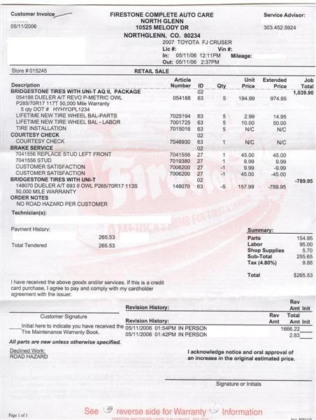

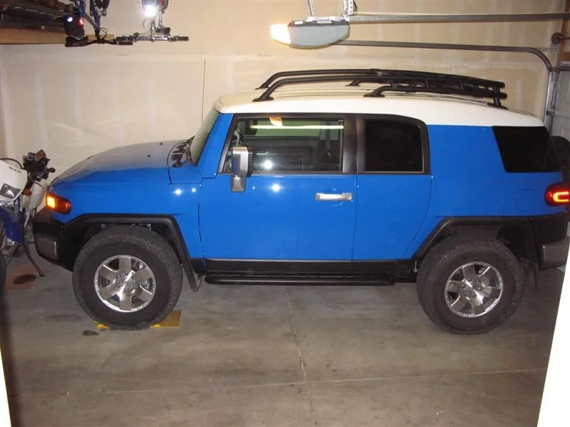

I just got back from the Firestone Complete Auto Care store. I traded in my stock Dueler 265's with 500 miles on them for P285/70R17's Revo's and I only paid $265.53 difference installed for all 5!! They look more burley and clear fine, no rubbing at all. I even tried to stuff them all the way and turned to full lock 1/2" or so of clearance. I also did the A-trac button on my c package only FJ (with rear locker) and it worked fine, just used a 3.00 switch from radio shack. here's the invoice and pics.

Oh yeah, the power loss is very minimal since these are passenger tires, non light truck. A little more road noise than stock but still quiet. I notice a little bit of sway around corners when before it was on rails, but way better off road. I will report back with mpg, I was getting around 18.5 before with 60/40 city highway.

It would piss me off that they (apparently) broke a stud on a brand new FJ, no reason for that, except they were probably using a pneumatic impact wrench to tighten the lug nuts , big no no. I would loosen and retighten them using a torque wrench.

Yeah the guy was pretty much an idiot, he also scratched one of my wheels a little bit with the impact wrench. I guess I was just too happy to get a good deal on my trade in to get pissed.

that was a very sweet deal on the trade-in tire price.very nice lookin rig.

FYI there are a number of cases poping up of broken studs on FJs. Many of them from tightening with a torque wrench at 85 ft-lbs...
I broke one just yesterday retorquing the wheels at 1k miles. Did some reading today. I think they have a bad batch of lugs they are using in japan...
Might be a recal or TSB campaing in the near future....
I was using a good quality torque wrench that is designed primarilly for lug nut torquing to be within 3% of dialed in torque. It was set to 85 ft-lbs. Spun the stud right apart before the click.
