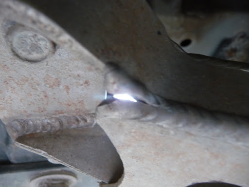

I have a MAF tank and would probably go a different route in the future. The arm which mounts to the tank to the passenger side of the frame is cracking on every weld. I'm not sure if it was due to poor welding or if it couldn't support the loads it experienced the one time it met some rocks (Aluminum skid and tank itself are dented). Only driven it to the northeast twice and the amount of corrosion on the tank is quite surprising as well.
There is no doubt having the additional fuel is a great resource and convenient not having to stop for gas (I don't stop on roadtrips until I'm out of gas). Overall the system works well.
However, I will likely replace the tank with a proper fuel cell that has an internal bladder for improved safety in the future. I think there are some Australian companies that offer alternative tanks as well, but I'll probably go with a JAZ tank or similar in the future and make custom mounts and a proper skid plate (i.e. not thin aluminum).

On every corner of the arm
Driverside of the tank came into contact with a rock once and wasn't that badly loaded. I was surprised how easily the skid and tank deformed. No idea if the welds cracking on the passenger side arm resulted from the driverside coming into contact with a rock or if it was just crappy welding from the get go.

My MAF tank has held up fine for what it is worth. I bang it on rocks all the time. The weld tears on FJNewbs are a concern though. Every time it is on the lift now, I check for damage.

I'm not talking about it sliding over rocks. I'm refering to it supporting any of the vehicle weight whatsoever on rocks. The only time it has had too the tank itself (and skid) came away quite deformed. I'll get photos the next time I'm at the shop.
Like I said its not a bad setup, but far from ideal for rock crawling. Most folks use their FJC's on fireroads and general offroad trails which it is perfectly suited for. Heck Demello took a stock jeep liberty down on the trails at wheeltoberfest that the "heavily modified FJCs" thought were supposed to be difficult (MAF tank would survive fine on those). Puts things into perspective.
MAF tank is sound product for what most folks use the FJC for. That and the ranger tank are hard to beat for bolt on options. Just think that there are some better solutions for cheaper if you are willing try a custom setup.

MAF tank...last photos don't really illustrate how badly it is dented.
