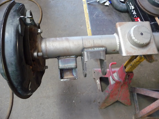

Rear Axle
[IMG][/IMG]

Old link to frame mounts gone.
Trying to keep the link mounts from being too low while still targeting the #s on the calculator
For reference here is how low they normally hang on an OEM/normal currie 4 link setup.

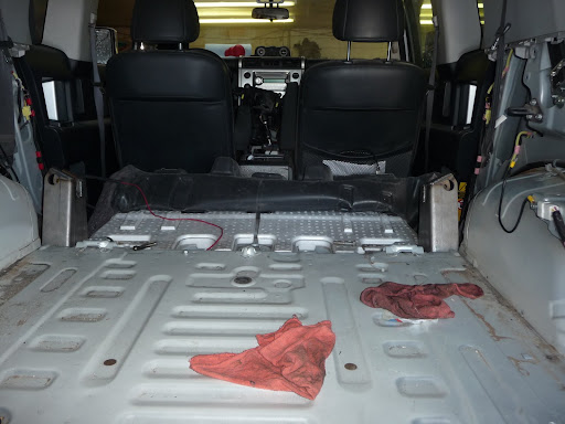

Rear interior and storage system removed in case the fender wells need to be modified a bit.
