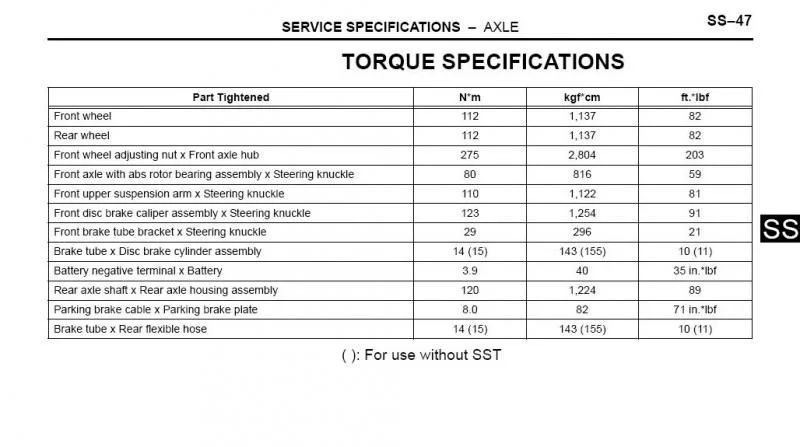

Does anyone know the torque specs on the 35mm nut that goes onto the spindle holding the hub/bearing assembly?
Thanks!

Is this what you need, 3rd one down, from the repair manual?

Thanks Mike, that's actually the exact spread sheet my local mechanic (Network Alignment) gave me. I'm happy to say the truck now steers nice and tight with no 55-60 mph wobble.
