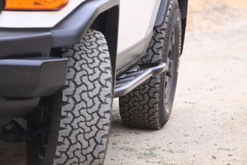

A little hard to tell from some of these pictures. Do these angle up fairly good from the side of the fj? I know the trail gears are straight out, and the all-pro, demello angle up. Curious what group these white knuckle fall into.

They angle up slightly.

Thanks Darby, what do you guys think??? Is that about the same angle as all-pro/demello or a little less. Its kinda hard to tell without seing them side by side.
I want the ones that angle up the most/ just hard to tell. I do like the3 design

I don't have the specs on the Demello sliders but the White Knuckle sliders run at 25 degrees for the FJ40 and 15 degrees for the FJC.

Darby is right on the money 15 degrees. An angle greater than that in relation to the outer rub rail will begin to be a problem for the cab doors ability to clear the slider.

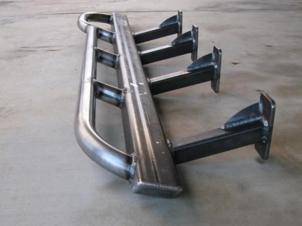

This might be more helpful

Very nice sliders... I've been looking into these. How much "stronger" are the Heavy Duty sliders compared to the Medium Duty sliders? I'm curious to see how much more one design will deflect compared to the other. Is there noticeably less deflection on the HD version when lifting up the side of the truck with a hi-lift?
How about a group buy on these?

Thanks John, Looks like these are the ticket.

Thank you for the compliment. The Heavy Duty sliders main rail and legs are made of steel that is 50% thicker than the Standard Duty sliders making them about 50% stronger and allowing little to no deflection.

The White Knuckle Off Road sliders (heavy duty version) arrived the other day. The sliders were very well packaged and included the bolts, washers, parking brake cable relocation brackets, instructions, as well as stickers. At 110 pounds, the UPS man made a comment about the package being the heaviest of the day. =)
If I had to do it all over again, I'd get the same sliders, except I'd pay john to have his powder coater guy bead blast the sliders to cut out a bunch of manual labor in prepping them for the paint job.
Pics as promised:
Upon opening the box:
Nice welds were staring right at me:
Plastic wrap removed:
Few coats of Duplicolor self etching primer after a thorough cleaning with a wire brush, coarse scotch-brite pad, and a wipe down with acetone:
Another view of the primer coat:
Few coats of VHT Rollbar and Chassis Epoxy paint in semi-gloss black:
Bolted up!

The rock sliders look great, first I've seen from them. Nice kickout, angled and mounted heavy duty with double the mounting brackets.
