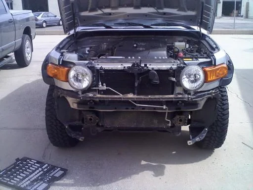

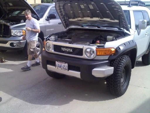

This is my truck prior to stripping off my bumper
Removing the Stock bumper was the most difficult part of the install

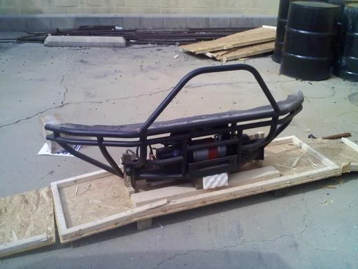

Here is the custom crate that it was shipped in

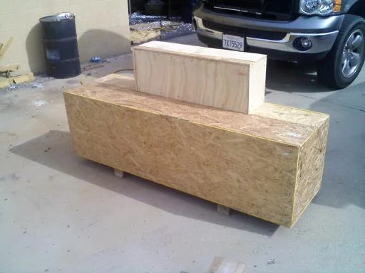

After I pryed the crate open I got the first look at my awesome new bumper, and was almost ready to bolt it on

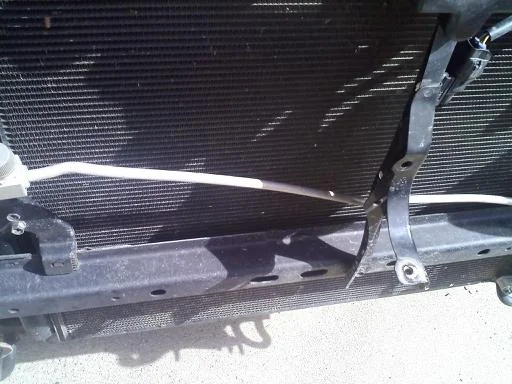

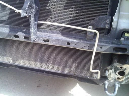

The one last thing that had to be done before the bolt up was move the A/C line back towards the radiator so that the bumper would clear
This was easy enough to do, it just takes a little finess and time, simply remove the center bracket, bend the A/C line back and replace it.

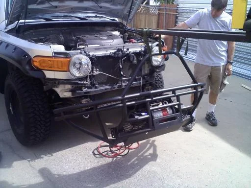

Since this bumper already had the winch installed it was quite heavy so I enlisted the help of a fork lift and a few family members...however a floor jack will serve the same purpose as the fork lift...

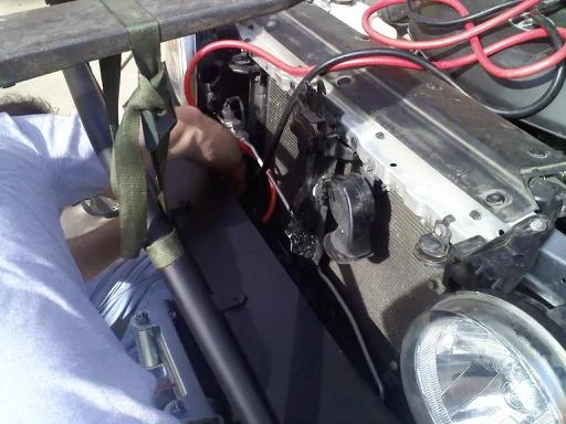

After we go the bumper all lined up we bolted it down to the factory mounting points and wired up the winch

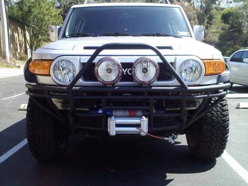

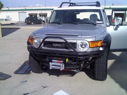

This is the final result...like I said before it was one of the easiest installs I have done, and it is an amazing product...the install took about three hours total. Thanks again Stan for a great product!

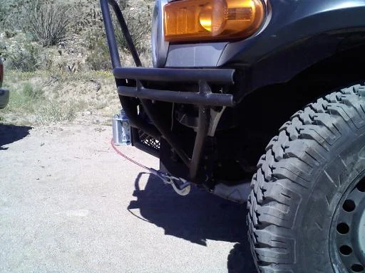

Nice Bumper, looks like you took off the ac line support, did you anchor that line? If its just floating around and rubs on something like the the center bracket or crossmember you may find yourself without ac. It took about 6 months for the guy I got my ARB roof rack from to wear his enough to leak, it didnt touch when it was parked but at highway speeds it rubbed and slowly worked its way through. I cut the middle of the bracket out and welded it back together to support mine closer to the radiator.
It must be the angle of the picture but it looks like your fairlead is 6 inches off the ground?

I like the flat black paint, its nice because when i bang it up I just do a bit of light sanding and re-spray it, and its as good as new...at this moment my a/c line is not anchored, I am making a small clamp for it that has a soft foam around the inside so it wont be able to rub on anything...As far as the fairlead, its the angle of the picture, I am going to take some more pictures in the next few days of the approach angle and an eye level pic so that everyone can see the clearance.

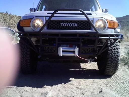

here are two more pics of the different angles of the bumper from ground level so you can see the clerance I have...

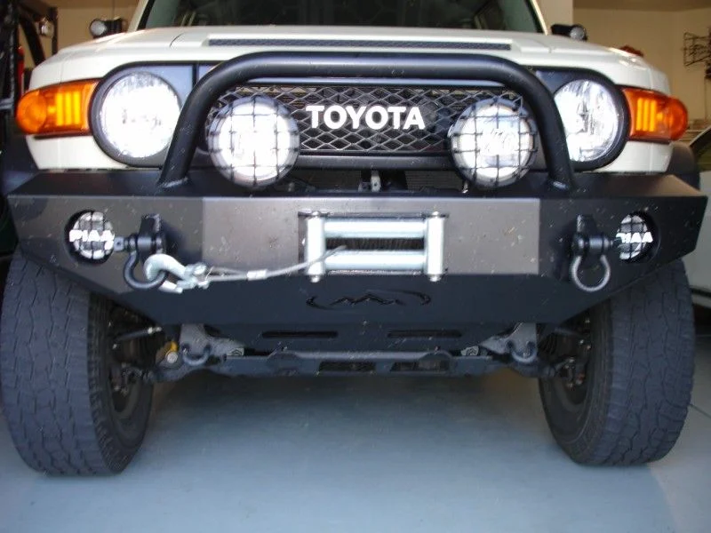

Nice work, Here is my Expedition One ..
