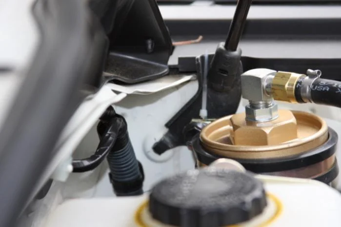

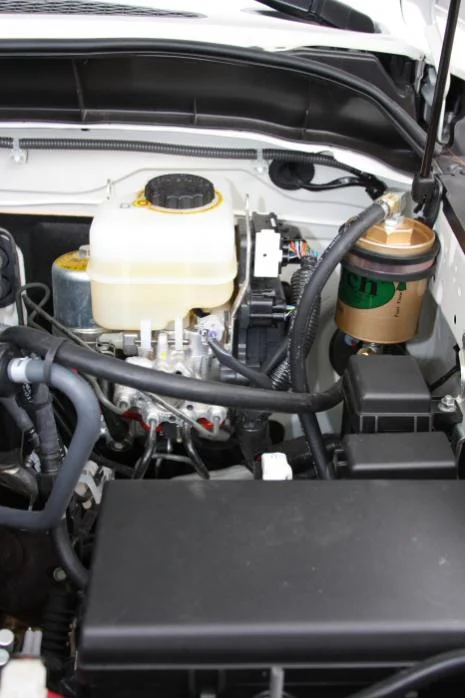

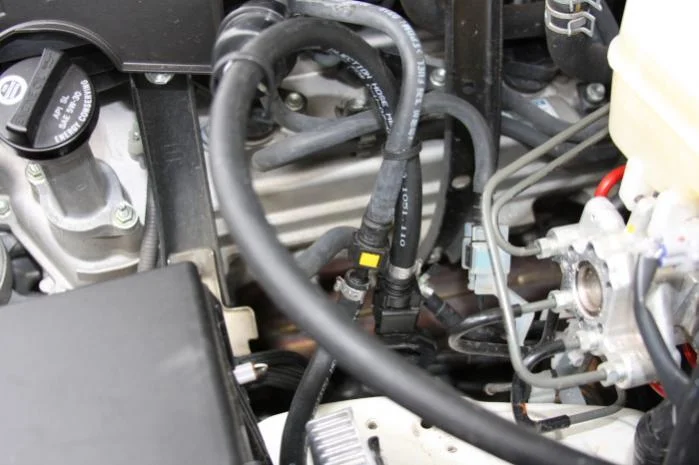

Here are a few pics of installed Fitch fuel catalyst. Whether or not I get good results remains to be seen. I can tell you that I have an 2008 Trail Teams Edit. Stock MPG was roughly 17.5 ( I only drive one way and it isn't easy) I have gotten 20 on long trips. I installed an OME lift (plus 10mm enhancers on front)and Total Chaos UCA's last time I was home. Then I added Swamper SS-M16 (295,75x16) and had some rubbing issues. The only full tank I've run through it with the tires got barely under 16 mpg. My speedo is 3-4mph off so you can do the math. Install was easy with the exception of the mounting band and holding the hood up (I found an old broom for this). I mounted it on the drivers side hood cylinder. You can see in the pics I used a zip tie to keep the band together so I could get bolt started. I could have used another hand but did this by myself. 30 minutes tops probably alot shorter if I didn't have to find the broom.
