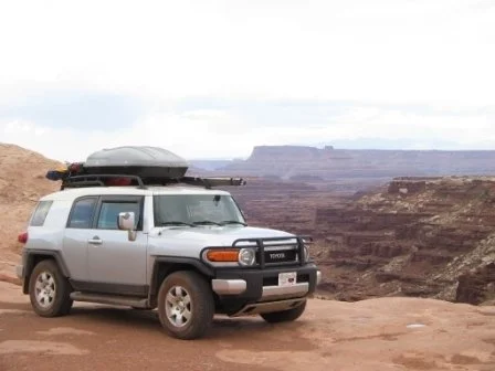

Those look interesting--could I get away with the soft OME springs to preserve ride quality and a set of those in the rear on trips to compensate for the extra weight of all the gear? Would they interfere with the articulation of the rear axle?
In this pic you can see that the rear is sagging a bit--and it is exactly when I don't want it to--during wheeling.
