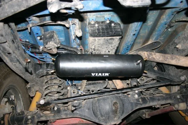

Got my tank in
I'm almost done installing the VIAIR 200PSI OBA system and I decided to mount the tank under the truck on the rear cross member behind the rear axle. I had to cut and grind the bracket from the middle of the bar. After that it mounted up very well with two U Bolts. I like this location because it is less likely to get damaged than if I had mounted in front of the rear bumper.
