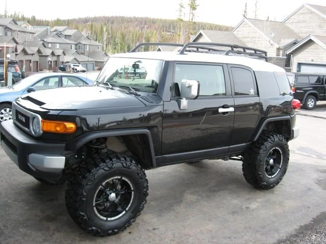

my fj. rough country 6 inch
Here is the new rig. performs great on and offroad.
6 inch Rough Country lift kit
35x12.50x17
Helo 957 wheels
Nitto Mud grappler tires
Spare tire carrier spacer from warrior
new headers
new cold air TRD intake system
