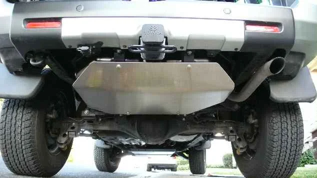

A little while back I approached Troy Hoffer of Superior 4Wheel Drive about a second gas tank modification. He spent considerable amount of time researching the request and came up with a phenomenal solution.
The DOT approved tank is fitted in the big space under the cargo area, next to the exhaust. The filler neck is accessed through a mini door in the bumper and there is a fuel pump that is manually operated to transfer fuel into the main tank upon demand.
A second fuel gauge indicates the fuel level in the aux. tank and an aluminum skid plate spreads the load in the event of impact. Total capacity is 19 gallons, doubling the range!

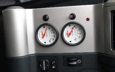

Fuel Gauge
The second fuel gauge indicates the level in the aux. tank. The toggle switch next to it operates the fuel pump and the red light blinks on and off to indicate that the pump is operating.

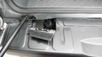

Fuel Door
The filler neck presented some interesting problems. At first it looked like the neck would have to come out in the wheel well, but upon further reflection the bumper cutout became possible. Small details like cutting the door at an angle to maximize step area for the roof ladder.

Quixote is offline   Reply With Quote

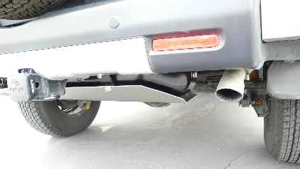

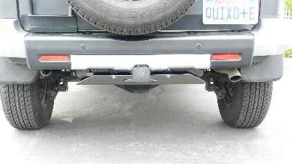

Fit at Exhaust
The aux. tank seems almost purpose made for the FJ! It angles away from the exhaust to
tuck right into the space. Looking at it head-on you barely notice that there is something underneath the bumper. Overall, I'm pretty pleased with the way it all turned out.

That is awesome!!! I would be concerned with coming down on that hard on a trail though, i would probably go with a smaller one on my rig, but none the less that is one impressive modification!!!!
Yep, that is my biggest concern - hence the skid plate that will protect it somewhat. You like to wheel your FJ hard, judging by your posts!
I'm more looking at setting up a long distance expedition rig that a rockcrawler, hence the need for a long range fuel tank.

excellent mod, nice to see an aux tank option for your FJC folks!
Couple of observations:
-excellent fitment and a trick fillup. However, those of you wishing for an oem filler neck, please check out the ones for the 80s. We have a nice dual filler neck that may need to be modified for your aplication. Just a thought. Do a search on OEM Dual filler neck in the 80 for more info.
-rather than add a second gauge, why not feed the sending unit stuff to the main tank gauge? Use a switch (DPDT/DPST)and a relay (if needed) between the two tank sending units. Of course, I'd use the same Ohm value sending unit as the main tank so that your gauge can read the aux tank sending unit accurately.
-one thing to consider when wheeling places like Moab or similar, have the rear tank completely empty. That 19 gallon (@8 lbs/gal) will drag the rear end down and smack on rocks and ledges.
-19 gallons is 152 pounds of dead weight. Do you folks have enough spring rate to accomodate this weight plus the usual camping and recovery gear? Just curious. I know that the 80s have a plethora of springs to choose from. If you don't have a huge selection of springs then I suggest using AirLift poly air bags inside the rear coils to supplement this additional weight.
Cheers!
nice to see someone from the "Scissors" weigh in. As far as spring rate, the OME HD springs 896(?) have sufficient rate to handle the extra weight. These give decent lift, but are so stiff wheeling with out a good load they bounce you horribly. I installed the 896 spring with this mod in mind as well as real rear bumper w/ swing away and have considered swaping out to the med duty 895 until I find the bumper and aux fuel option I want.
