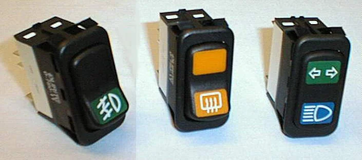

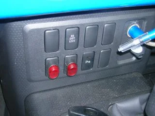

I got these at radio shack for something like $2.50 or so. lighted with 1/4" push-on tabs, and mount in a 1/2" ( I think ) hole.
I popped out the blanks, and the back looks like a rectangular "cup" with some plastic ribbing inside. I used a big drill bit to tear out the ribbing, and then mounted the switch. Low profile, and , like I said, lighted. I use one for the fog lights and one for the big off-road ones.

I did the exact same thing for A-trac switch, great minds think alike.

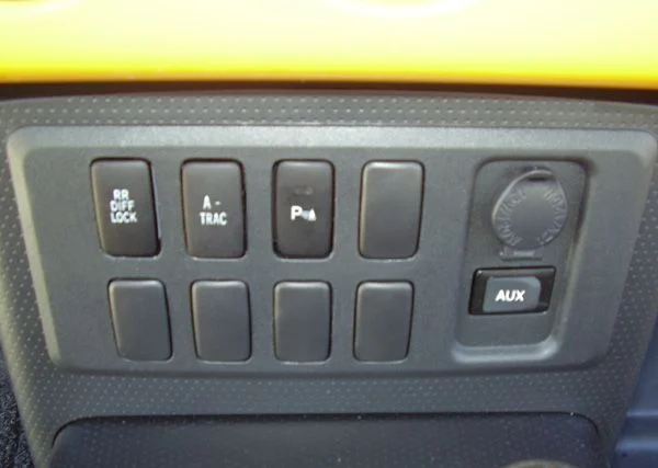

Since the factory layout of the switches looks like an unfinished tic-tac-toe game, I consolidated my exisiting switches to the top row. That way, if I add any aftermarket switches, they'll all match each other in the bottom row.

Looks good Steve.
I have not tried taking off that panel yet, will have to research on it.
I have my foglight switch up by the steering wheel in one of the blanks, the other blank is for my alarm LED.
Had to trim the Tacoma switch to fit.
I wonder if they need to be trimmed to fit down below as well.

Panel removal isn't necessary.
Just (gently) pry the switches out from the front, re-route their respective wiring harness to another hole, and snap the switch back in.
(As I recall, one of the switch holes required some slight orientation notch trimming, but no big deal.)

Not sure what you are looking for. But these might work. You would need to messure and make sure the fit is right. As long as they are not to big they could be modified to fill the space nicely.

I have seen several nice looking switches for around 5.00 to 20.00 depending on how fancy you would like them to be. Some companies will design them for your needs.
http://www.alliedelec.com/Search/Pro...F88C802973617F
http://www.vehicle-wiring-products.c.../switch-2.html
http://www.alliedelec.com/Search/Pro...F88C806462617F
http://www.msfoster.com/psw.html
4x4mods.com is also a great resource.
