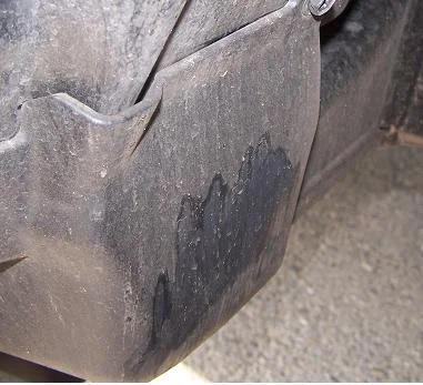

moto metal 17x9

monniepoo,
the reason you are rubbing is the offset and/or width of those wheels. check the wheel well area and you will find clean areas where the tires are rubbing.
Most likely by the mudflap or at the front of the tire (the backside of the front bumper)
also check the upper a-arm to see if there is any rub mark there.
depending on how much rub there is, it could be just an annoyance but if it's too much, you could tear something off while offroading when you really cycle the suspension.

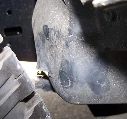

Here's my deal

Based on what has been writen on this thread I would agree your problem is most likely the Backspace on the wheels. They should be able to tell you what the BS is and that might be important to know, also you might want to ask them what those wheel were meant to go on they may know that.
The BS on the FJ is way different than the 40, 55, 60 & 70 series and slightly different than the 80 series. I can not confirm for sure but I think it is differnt than the 4runner and possible the Lexus GX470 (all members of the Prado family).
There is another thread talking about tire sizes and what fits with what lift:
http://forum.ih8mud.com/fj-cruiser/114399-tire-size-question.html
Just curious, what lift do you have installed on your FJ?
One thing you really should keep in mind, the wrong or a different BS is going to change the handling of your FJ. Could make it better or could make it worse.

I do agree w/ others that the offset of the aftermarket wheels is the cause. However, this is not serious.
monniepoo, thanks for posting the pictures of the rubbing. I bet most of the noise is coming from the front plastic, as that 'echos' when hit.
A simple solution is to zip tie it up to slightly push it out of the way. It is a large, unsupported piece of plastic so it can be manipulated very easily.
The rear will probably clear by removing the mudflap- I am going to guess you don't want to loose the mudflaps so I say live with it at the back- I don't think that is making any noise and the surface is smooth enough that you won't rip anything out while wheeling.
removing the mud flap will no solve the problem for the back part of the wheel well, it is sitting right up against the body mount sub frame.
