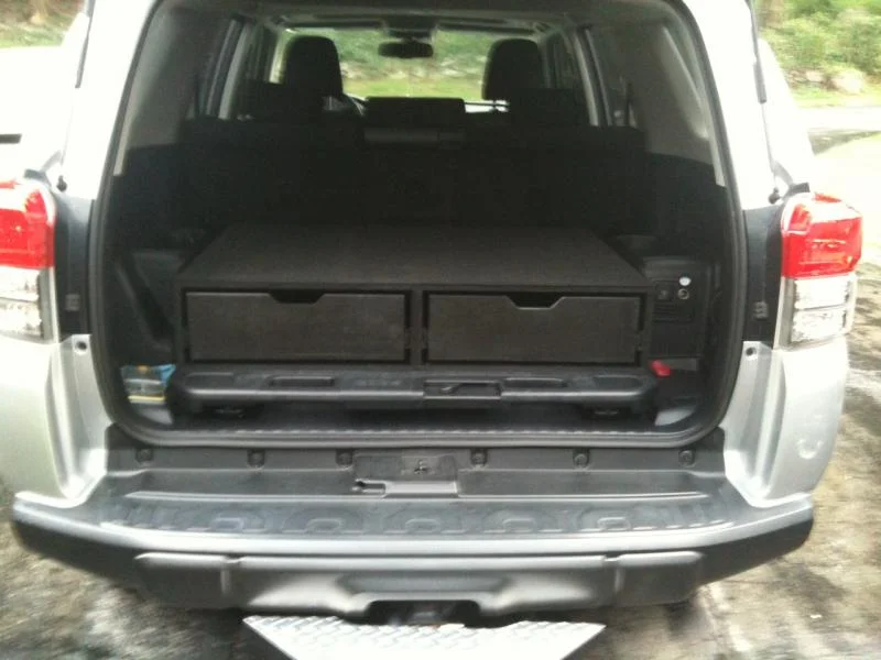

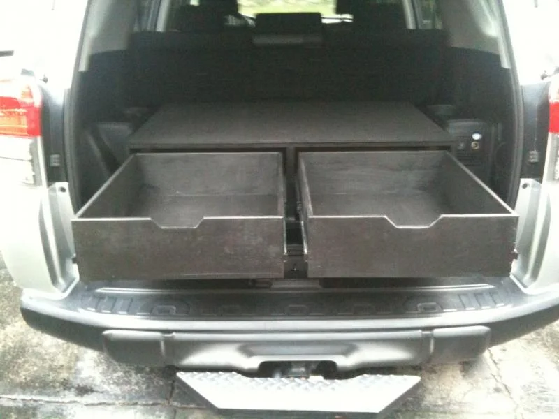

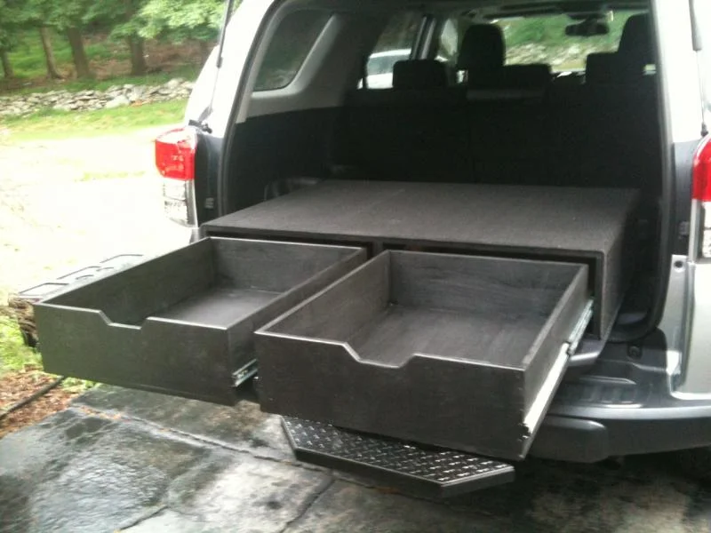

Quote:
Originally Posted by jonharis View Post
My drawers are 50-60lbs. It's pretty insignificant after removing the third row seats.
Consider safety and security too.
Same here...I used 9 ply 1/2" cabinet grade. The 4Runner has a slide out tray, I have the drawer unit bolted in 4 places. With tools, straps, flares, flashlights,etc...it's probably another 60 lbs of crap. I have since built a door to cover for the front 6" space that houses my AK and some clips in case the zombies come, or heading to the range.
I also added small locks in the front to keep them closed and secured.

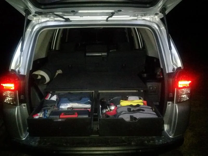

Thought it might help to show it loaded....I've a little bit of a bag/organizer fetish since I put those in...weird...
