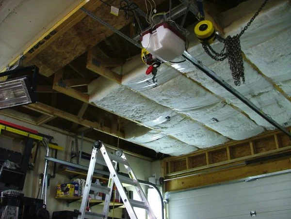

Finishing touches...to garage
Originally Posted by Ratpuke View Post
Did you get the garage done?
Well, after 40 or so hours over 2 weekends and a couple of evenings last week....Er, no....but I'm nearly done.

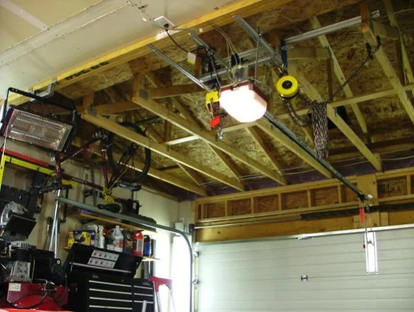

So far, 4 bales of R40 glass fibre insulation, 2 bales of R20 wood fibre insulation, 24 linear feet of 2"x2", 76 lin ft of 2"x4", 16 lin ft of 1"x4" lumber, 180 sq ft of vapour barrier and a few beers have been consumed so far.
I rebuilt my garage door opener hanging system from metal, because it would be excessively in the way when drywalling, to lumber; I figured out how I could still maintain access to my rafter suspended chain hoist and electric winch, which I wasn't about to give up on, whilst maintaining a vapour barrier to prevent paint fumes from getting into the "attic" space; I built two insulated cubby holes for the inverted suspended push bikes (that's bicycles to the rest of you), moved some electrics because they were in the way of the aforementioned; insulated the bonus room wall whilst I was in there because the bonus room is a couple of degrees colder than the rest of the house in winter; framed in the missing rafters to be able to drywall a section; framed in some edging strips for same drywalling reason; framed up and installed some furnace filter boxes for ventilation; finished insulating the rest of the roof and finally laid up 2/3 of the vapour barrier last night.
Oh, and I only fell off a ladder once and fell on my ass onto my tool cart which took the brunt, so to speak...My backside is fine, the cart might need a little TLC with a lump hammer...
The one positive aspect, because I'm not sure yet how much the insulation will keep the heat in, that's TBD, is that the end of the garage now insulated is brighter because the roof now reflects the lights at that end instead of the dark roof absorbing it.
A couple more evenings this week and I'll be done...

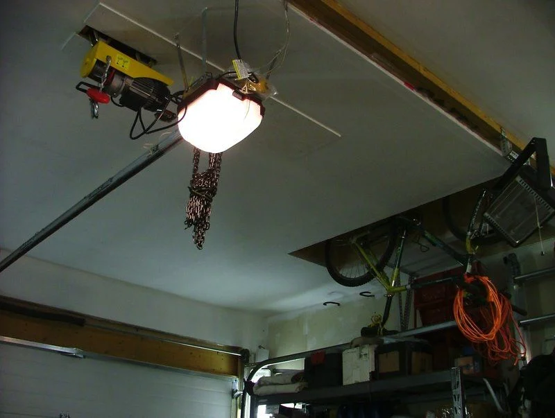

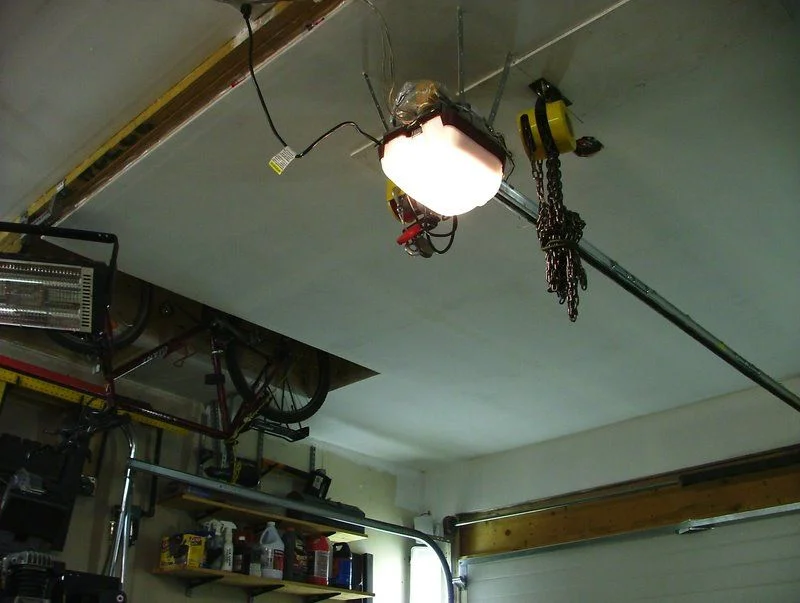

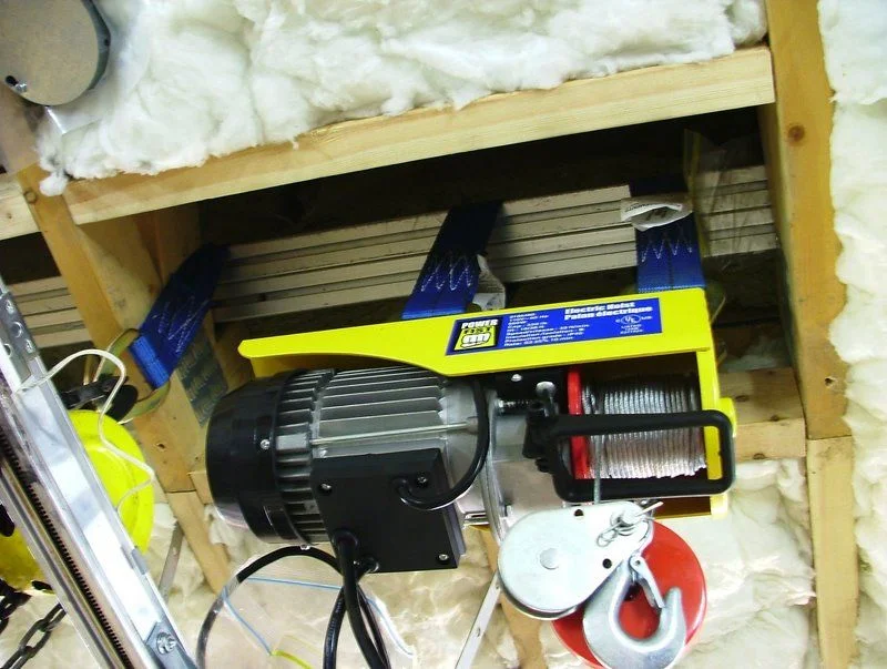

Man, I don't think I would be using that chain lift off that roof joist, the joist is secured by a downward timber which held in place by a truss metal bracket!

It's not as bad as it looks
Yeah, I know it's not the greatest. It looks better in real life as I the hoist is connected to a 10,000lbs axle strap, which is wrapped around both the centre joist and two 1.5" square extruded aluminum bars that span 3 joists and rest above the diagonal in the joist and thus "pushes" the load somewhat into the vertical 2x4. So the load is supported by more than the one picture would lead one to believe. Also, the truss is bracketed both sides and I'd put more faith in those than perhaps some other method of joining.
I ummed and aahed quite a bit when I needed to use it for one particular job and could probably have strengthened the set-up but felt it sufficed for what I needed, and believe me, I was watching VERY closely when I used it the first time. I use my 2 ton folding engine hoist for heavy duty, lowish height work but believe it or not, I have hoisted my 1HZ out of its metal crate and put a 3B in its place and lifted the engine and crate simultaneously. It's good for about 800 lbs I'd say...
Thanks for the concern, it is warranted but for <1000 lbs work where I'm not jumping up and down on it, I should be OK. I wouldn't attempt an engine + tranny + transfer lift. That might be asking a bit much of the set-up and I'd really then have to agree with you.
So, you get first dibs on "I told you so" when I complain I dropped something.
Better look at axle strap wrapped around bars resting on 3 joists.

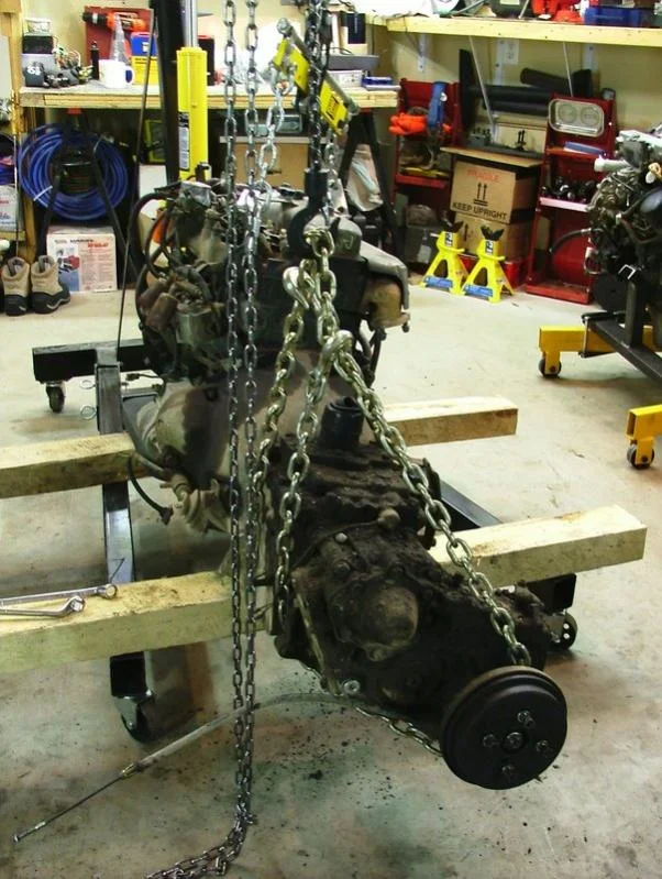

What the chain hoist typically gets used for. In this case to support the transfer & tranny when separating from the 3B that was in the truck. The engine itself is supported by the engine hoist and not the chain hoist in question.
What I really want in the garage is a kick-ass I-beam and trolley set-up. Alas time, space and money have been constraints to date.

P.S. The dodgy set-up is now drywalled so I don't have to look at the potential disaster now. Actually, I could go in at a later date and strengthen the joists, if I so desired, as I have left access.

How do you like your Princess Auto hoist? Would you reccomend it?
I ain't gonna hit ya..........ahhh the hell I ain't! - John Wayne
73fj is offline   Reply With Quote
Old 11-08-09, 12:03 AM   #50 (permalink)
Forum Regular
SabreTooth's Avatar
Join Date: Mar 2006
Location: Calgary, Alberta
TLCA# 17051
Posts: 157
Princess Auto hoists
Originally Posted by 73fj View Post
How do you like your Princess Auto hoist? Would you recommend it?
Er, which one?..They're all from Princess Auto.
The electric hoist is only there because I won it at a club raffle. It has a single line pull of 330 lbs and double line, double that. I personally wouldn't use it on anything expensive and I have it more as a utility hoist and have barely used it.
The 1 Ton chain hoist is as good as any other chain hoist. I doubt there is anything one could screw up building it and I have used it to hoist my expensive 1HZ that I couldn't afford to drop and I trust it.
The folding 2 Ton engine hoist is very good value for money and folds up to take almost no (floor) space in the garage and I can recommend this unit. It is well built and easy enough to take apart (folding legs) and transport single-handedly and has seen a bit of club use. No complaints.
Hope that helps.

One Yak shaved, one to go

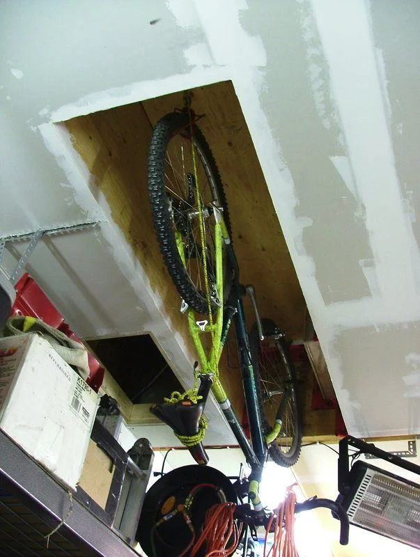

So, three days shy of a month of Sundays (well actually, Saturdays, Sundays and any weekday evening time I could find except a couple of low motivation sick days), the framing, drywall, taping, mudding and primering are complete.
The cubby holes for the bikes to get them the hell out of the way of my precious floor space.
The finished product
Size:  71.7 KB Name:  DSCF2162.JPG
So, you may ask why put so much time into doing drywall etc. I have an attached garage. When I fibreglassed the 40's floors originally, the house stank of Styrene for 2 1/2 days afterwards. I want to be able to paint the truck at home to save money and that requires a paint cell that can be deployed in a short period of time that also keeps paint out of the house. My wife will appreciate that greatly . I also wanted to be able to poaint in winter and that required keeping the heat in so hence the effort. I bothered to tape and paint because I am annoyed with myself for not having done so when I had a lot less clutter in the garage. I was just sick and tired of electricals, insulation and drywall at that point. Now I have clutter and won't get to do the walls justice until the day I move out. Hence the motivation to do the ceiling job right now.
Anyway...TBC

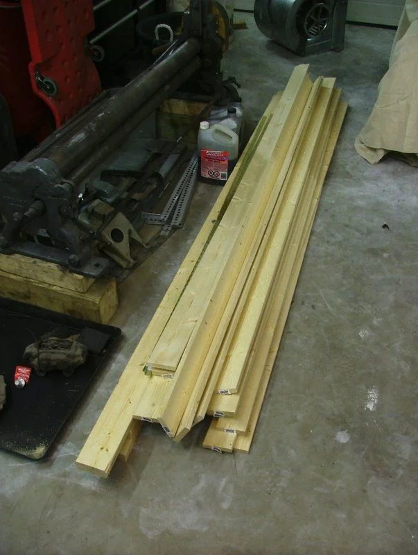

How wide is your roller and is it a slip roll? (comes apart at one end) Is it powered or manual? Very handy tool if somewhat rare in a home garage. We've got a very nice 3' manual slip and a 50" powered slip here at the shop. Let me know if you need any quick (or not so) bends - I'm sure I'll have what you need. If you weren't aware I also have access to a full CNC sheet metal shop with everything from a 2' hand brake to 10' 100 ton press brake or 22 ton turret punch, welding (TIG,MIG) etc. etc. Don't go buying any raw sheet metal, I've got heaps of offcuts for a local club member.
Hi Kevin,
It's a 4 foot hand driven slip roll I just had to have. I was going to use it to make body panels (the rear quarters). It was an eBay rash decision and was in Brooklyn New York. Cost USD 300 to buy and CAD 700 to ship! I am a big fan of old fashioned, well built machinery and this is an old Pexto (or earlier incarnation of same company, I forget the abbreviation letters) machine. Needs a little TLC and a mobile stand at some point but is usable.
Thanks for the offer of assistance should I need it. Likewise, if you need anything machined, I have a 7" swing Myford lathe at home and a new to me Rusnok mill that I'll be commissioning in the next few weeks (need an X-Y table, collets and then deep pockets for the tools). I discovered that owing machine tools is a quick way to spend lots of money. I bought the lathe (incomplete) for CAD 500 locally (same guy as Rusnok this week) and then proceeded to buy parts to complete it, accessories and tooling. I won't say how much I spent but needless to say it was many factors above what I forked out originally. I just had to have it AT work, I have access to a large lathe, Bridgeport mill, 4 ft finger brake and 4 ft shear as well as lots of welding machine types (except I cannot do thermite welding ...pity).
The next must-have-tool is either a dividing head for gear cutting on the lathe or an English Wheel (my "secret" interest). I might build a larger English Wheel but start out with a Justin Baker benchtop for learning.
Hope to see you truck sometime soon. If you need a physical hand doiing something, I'm always available to lend a hand. Just ask my RMLCA colleagues how quickly I sign up to assit anyone except myself...
