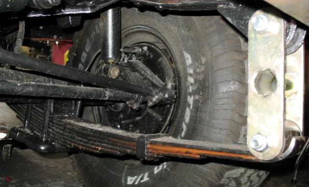

today we decided to put a 3" shackles in the front and 4" in the rear. i will be driving once again to Specter off Road first thing in the morning. this will help to accommodate my 35" diameter tires. the other option was to get a 1.5" negative offset wheels, to widen the tracks as suggested by soenke. i still want to this, however when i called around it will take up to 4 to 5 weeks to make the the wheesl. we will do that further down the road. thanks

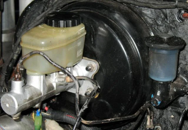

we changed the brake booster with a booster that came out of a 1 ton toyota dullies, we also found out that the Nulla has a vacuum tank connected to the brake, we will see how this all works together.

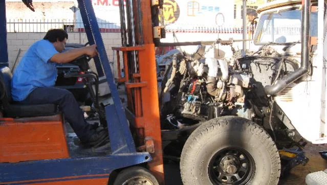

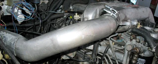

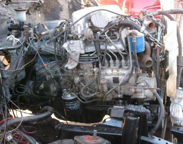

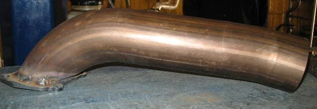

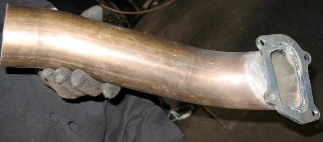

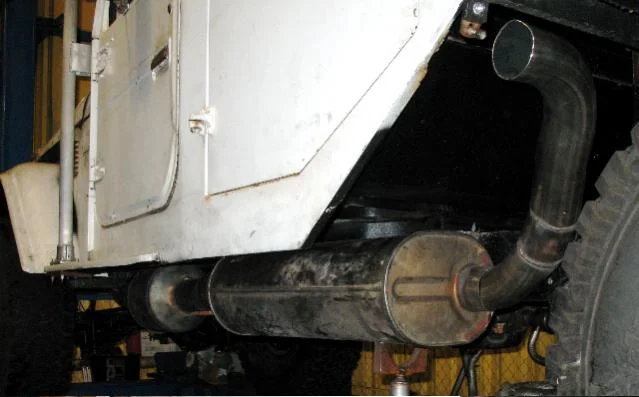

pictures 1 & 2 the fabrication of the dump pipe, it is 3 1/2" inches in diameter, the whole tail pipe is 3 1/2" we did not install the catalytic converter at this time. i would say it is a little loud. our plan is to install a catalytic converter in the future.

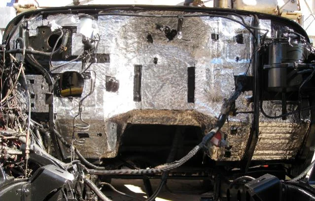

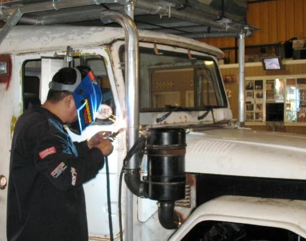

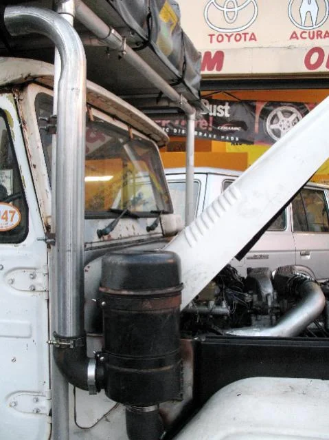

picture # 3 the snorkel

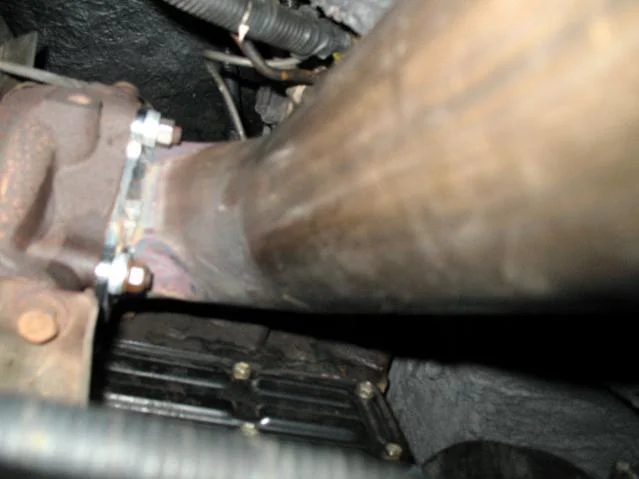

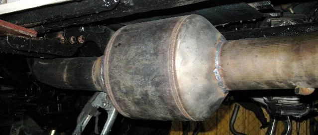

picture # 1 the dump pipe connected

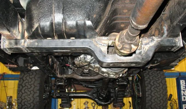

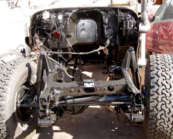

picture # 2 the cross main frame for the center drive shaft bearing

why a catalitic converter on a old style diesel?
not sure why enlighten me, it is loud. any suggestion on how to quiet it down, what about a muffler? i can also put a longer pipe but i may have some restriction to go all the way to the back.

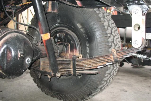

i lifted the the cruiser with a 3" shackles as i mention earlier, now i have decided to change the shocks, our cruiser will be about 8000 to 9000 pounds when done. i have very heavy duty leaf spring (11 of them in the rear). i know it would be hard to smooth out such a heavy vehicle.
i have been thinking Old man Emu, but i search the 1h8mud, there is a lot of suggestion for Bilstein shocks. i am going to SOR this morning i do not have much time to do my research and i am trying to get out of town asap. what shocks should i use Old Man Emu or Bilstein.

catalitic converter, not needed and very expensive.
muffler, STEEL construction, not tin. get a long round that is for a truck application, not a car or light duty truck, 2 ton or bigger and the mufflers are made to last.
shocks,
lift the wheel to max compression- measure.
drop the wheel to full droop - measure
now go to someone that sells rancho 5000 shocks and give him the following measurments
max compression +1"
max droop + 1"
this will make sure the shock is not your limiting strap as well as giving you FULL travel of your lift.
BTW, Monro and Gabriel make 90% of all the shocks in the world, OME, Dakar, Belton, all the different shock sellers are just rebadging the original. you can do the same idea for the above measurments for a HD Monro or Gabriel shock supplier.
what kind of air filter housing is that? a donaldson? are you sure it will do it's job when mounted like that? some models spin the dust and particles to the "bottom" of the unit which would be the opposite side of the intake inlet. because yours is mounted vertical like that, i'd make sure nothing slips past the filter seal and shoots down your outlet tube going to the engine.

Now, that's what a dumppipe is supposed to look like!
Driving just like this would get annoying very quick. I used a magnaflow muffler, i suppose those are pretty easy to come by in the US. Or look around and find an old muffler from a Dodge CTD. I believe those are 3.5" factory. Others will chime in i'm sure.

it is a donaldson
Quote:
i am checking on it. i can always lay it on it's side. we are happy to get it outside the engine bay, it seems to work fine. here are some pictures...

Quote:
thanks crusher, here are some more picture of the build, we re did the exhaust today to include a catalyctic converter (we got a great deal from Edy's Auto repair) and a muffler, a big difference. that straight pipe was too loud. the muffler and the catalytic converter came out of a ford diesel truck. took it for a short drive it seems to work fine.
also here is the picture of the 1 ton toyota dully brake booster, it made a big difference in the breaking.
we are still looking for a suggestion on the shocks, thanks
enjoy.....

Forum Regular
Join Date: Sep 2008
Posts: 18
Mileage will suffer with that catalytic converter.
No reason to run it in my opinion.
__________________
Jon D. Holder
2001 Excursion 4x4, 7.3l PSD, 4.56 LSD, Auto, AFE Intake, SCMT, AIC, IssPro Trans/EGT/Boost Gauges, Onboard, Rockram Hydraulic Assist Steering, 40" Goodyear MTR's, Deaver Lift, Glassworks Unlimited Fenders, Custom Front Bumper, Rock Sliders, Road Armor Rear Bumper with Remounted Hitch
jdholder is offline   Reply With Quote
Old 12-16-08, 12:08 AM   #138 (permalink)
Forum Lifer
crushers's Avatar
Join Date: Feb 2004
Posts: 11,934
suggestion:
a bit more flezable hose from the intake tube to the crossover, you need to allow for vibration of the big 6, it is smooth but with such a tight coupling you will get cracking down the road of the aluminum...

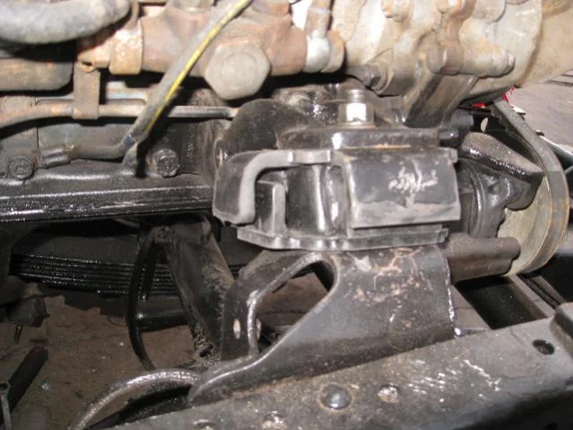

thanks gil and crusher, i will do more research. the other thing i realize from your post is to take a more comprehensive approach in our decision on the suspension. i have a lot of research to do and other opinion from the ih8mud community are welcome. here are some of our current initial thinking.
1. we want to keep our leaf springs, pictured below.
2. widen the tracks with 1.5 negative off set on all four wheels.
3. we have already installed 3" shackles, which solved the steering issue.
4. in the future go to 315/75 R16 all terrain
5. we are leaning toward the Bilstein shocks
6. firestone air bags
7. replace steering damper
your ideas are greatly appreciated you ideas.

agree with you but, global warming got me to install the catalytic converter, i like the sound and almost no smoke after start .......

a preburner will work the same...
you will need some caster shims in the front leaf setup, that thing must be like herding cattle.
after chatting with someone about the airbag idea, he mentioned he got rid of the airbags due to the constant failure, he said proper leafs is the way to go with air bags for temperary over loading. i believe he was from africa...

more on airbags!
On my troopy build up thread Wayne asked why I was going HD leafs if I was running airbags - I answered that IMHO airbags are a palliative measure but are not the 'ideal' solution to a leaf spring that cannot deal with the load. I also mentioned that a lot of our logging trucks ran them and we had so many bursts that we swapped them out for leafs. So I think this is what Wayne is referring to.... However I must stress that I have gone HD leafs AND kept the airbags. On tarmac you can pump up the bags and reduce body roll, you can also 'tune' the spring rate so easily with 'em. I know people go 0000kms with them with no problem, and I like em a lot - but with a heavily laden expo vehicle I prefer knowing the springs I have can deal with the load/road air bag or no airbag! A few other reasons for them:
- If your rig (like mine) is parked up for long stretches with al lot of 'bolt on' weight on the springs you can pump them up to avoid springs 'memorising' i.e. taking a permanent sag from lack of use.
- It is a third point in spreading your load - in theory with the vehicle load over three points there is less likelihood of main leaf failure.
- they are very good for towing as you can easily level off the rear to deal with the hitch load.
In short if your leafs can reasonably deal with the weight then the bags are an extra help, but I would not see them as a cure for springs that are shot or just no where near able to deal with the loads. In the Firestone kit there is a t-piece that would allow both bags (assuming they are both on the rear) to share one line... Now this I would not do! I can easily imagine that in a corner the outside bag would compress and the t-piece would allow air to be pushed to the inner bag thereby making the car lean even more: kind of like the opposite of a sway bar... Not my idea of fun on a laden top heavy vehicle. Bilstein's have a very good rep. Maybe if you speak to a real good shock shop about your vehicle and weight and set up you could get the Bilsteins set up for your vehicle if they are not adjustable on compression/rebound. I believe that for most rebuildable shocks changing valving is not a big deal.

I think the airbags work better with coil springs where you cant have an extra load carrying leaf.
