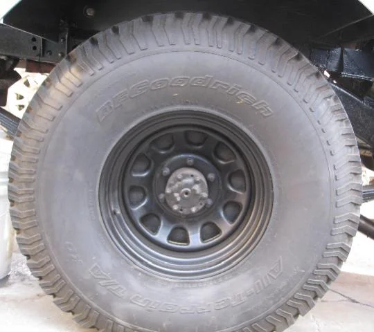

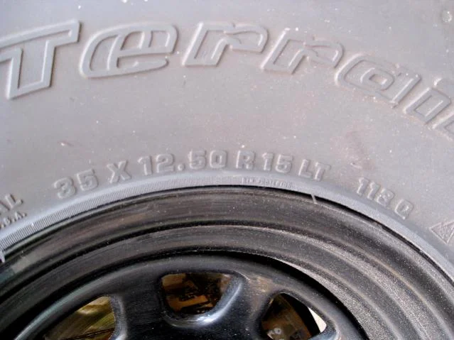

Talking 35" diameter tire
is there a tire that is 35" in diameter and 10" wide on a 15" or a 16" diameter wheels (prefer 16") either All terrain or Mud terrain?
my other option is to replace my tires. i currently have goodyear 35" diameter and 12" wide. i like the 35" diameter but narrower tires.... happy thankgiving....

If you are going to remote areas,anything but a light truck tyre maybe difficult to replace

Hey rideglobally,
nice truck! J4 with 12-HT is a very nice set up!
How big you plan the accsess from cab to cabin? If you want to use the whole width between the round corner windows of the cab, you will need some kind of rubber awning, working like a concertinia to seal the accsess and to provide sufficient space for the walls to move offroad.
If you plan a smaller accsess, you have to close the window in the cabs back, weld a frame around the opening wich needs to be matching and parallel with the opening in the cabin in order to use the rubber-seal and profil as shown in the other thread.
A friend uses this rubberprofil for his HDJ79 cabin, works fine...
Depending where you go, 35" or 315/75R16 is common. 7.5R16 even more of course, but I think they don´t perform sufficiently on a heavy truck...
Alternativley go for 255/100, they are fantastic on dirt road, rocks etc but lack performence in the dunes...You will get them in most third world contries easier then 315, even though for easy replacement 7.5 would be the best choice

thanks soenke, i plan to open the back to the point where that panel that is part of the window is welded, that is much bigger than the window (will post pictures of that later).
your ideas about the tire are very useful, i currently have a 35" diameter tire on 15" wheels. however they are about 1.5" too wide, this limits my turn ratios. i want to stay with 35" but narrower about 10" wide. the 315x75R16 is available in the US, the 255/100R16 may not be available in the US. the other possibility is a 285/75R16 they are 33" in diameter.
my last option (not preffered) will be 1.25' spacers on the front wheels, .
what about different rims, getting the track wider and the wheels futher out? It´s the same for the bearings but one part less to fail and cause breakdowns.
what Diffs are inside FJ or BJ ?
(With the shorter BJ ratio the 255/100 would be perfect...and you should be able to get them in the US too. They are quite expensive, though longlasting)
Everthing has advantages ...I think I would go with 35" R16 or the Michelins with different rims or if you dont get any with steal spacers

I can only speak from a EU/African perspective, but I have found that for tyres the most available is a good choice. 265/75R16 is pretty darn common here, 7.50 sure is available but mostly LT rag tyres for small trucks. IMHO wide rims and tyres can be expensive down the line. I was sorely tempted by Soenke's 255/100s but reality bit! For this reason my touring 78 is running 265 on 6.5 rims. I would like to go larger but availability and drive train considerations take priority.
BTW the aluminuim fabrication stuff is great and this road test and more pictures would be great! Super build up,

Rideglobaly is lucky because the 255/100 will fit without to much hassel and the drivetrain (especially with the shorter BJ Diffs) should be able to cope with it (not like the modern stuff )
it realy depends where they are going. Southern africa 35" shouldn´t be a problem to buy.
cheapest, safest and fastest to replace will be 7.5 -no doubt ... but would you like to drive them on such a big and heavy rig?

Fully agree Soenke! 7.50 are not for me... tough though - we run MRF M77 (Indian cross ply) on some of our working vehicles but the side walls are about 1cm thick, and they ride like . Still dream about these 255/100s though, so if I was rideglobaly I would be very tempted.

thanks all! our hope for the first test drive is mid December about 3,000 miles to Auburn, Washington. we will be going back to Laser Cutting Northwest LCNW.COM to install the 60 gallon diesel tank and other fabrication. we are looking forward to the trip. we live in sunny los angeles... so the snow should be a lot of fun.
on the tires i will continue to look for the 255/100. my initial research is that they are not available.
thanks all this is all very helpful, pls keep it coming.......

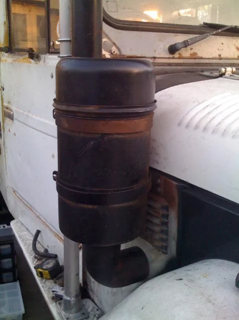

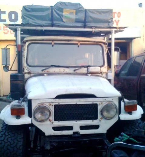

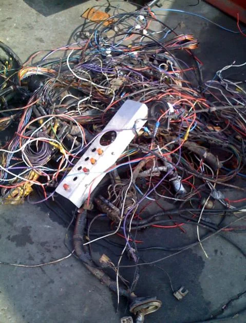

we did two things since we got back;
1. we decided to change all the wiring of the Nulla. thanks to Specter Off Road SOR.COM they had the wiring harness. the irony is this, one of the reasons we bought the Nulla is because it came with about 4 radios, wired for lights and many low voltage plugs. in short many wires. well it turns out that making all the wires work is much too complicated, so we decided to take it all out and start over again. tomorrow we install the factory harness we got from SOR.
2. we decided to install the air cleaner outside to create more room in the engine bay. see picture below.

thanks sancruiser and soenke, been busy trying to get it together for the 3000 mile (round trip) trip to Auburn, Washington. made progress today connecting the "new harness" radiator had to be taken to the shop for modification, etc. i am sure you all can relate. tomorrow our goal is to fire up the 12ht. we will see when the key turns. so many loose ends still. the other thing i did was to cut down the roo bar. see the picture and know this is first draft. i am trying to lose some weight and my plan is to cut the bumper about 6" from the frame.
input on the tires and wheels has been very helpful. i am considering the 315/75 R16 with a negative off set of 1.25 to 1.50 inches. i like the idea of widening the track with all it's positives and negatives. i made a call to a tire company and their initial response is yes on the negative off set and stay away from spacers. when i get the cruiser up and running again i will take it to a wheel and tire shop.
this will mean that my wheels and tires will be up for sale, pictured below, i will place them on the classified when i am ready to sell .... thanks

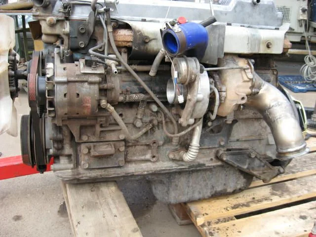

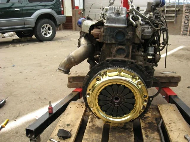

Looks like a very nice and capable Cruiser. One thing is that you're going to love that engine as soon as you learn how to use the touchy throttle. It does take a few days to get the feel. But it's not as bad as some people say.
When you're at it, i would fab up a 3.5 inch turbo dumppipe followed with a 3 inch exhaust. I did this 3.5 years after i did the swap and regred that i didn't take the time to do it right away. It lowers the EGT's and you get some extra power to boot.
Here is a picture of the dumppipe i fabbed up. It's mounted in this picture.
Another angle. Don't look at how dirty the engine is. Mud will do that. I did paint it after the rebuild...
Can't wait to see the finished project.

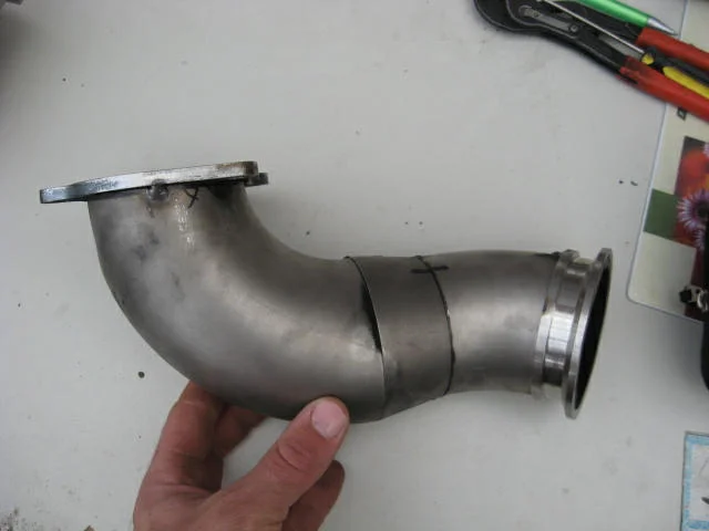

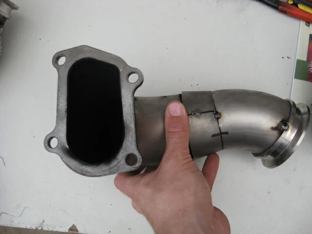

The dumppipe is the cast elbow on the back of the turbo on which the exhaust bolts. It only has a 2.25 inch outlet, so it restricts the outgoing flow, which results in less power and higher than necessery EGT's.
I ordered the needed flange from suprasport. And worked from there.
LIPP Turbo outlet flange
Don't be tempted to buy the complete dumppipe for the supra. It will bolt up, but puts the exhaust thru the hood.
It takes a little more time to fab up than just bolting an exhaust to the OE dumppipe, but it's worth it.
The blue silicon hose is for the intercooler. I'm not sure if it's possible to fit one on your Cruiser since you have A/C installed. You probably don't have enough space to fit one.
I think i have some more pictures of the downpipe when i was building it. I'll look for them tomorrow, the pics are not on this computer.
HTH
Mark

Found two pictures, i hope these make sence.
Mark
