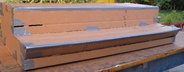

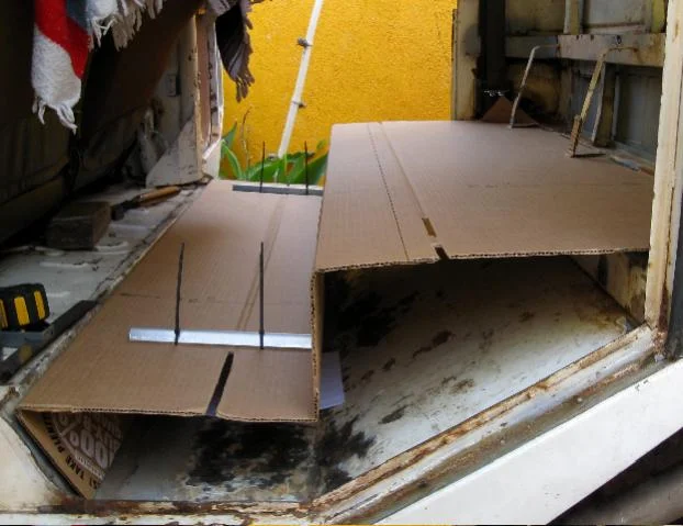

Talking fuel tank mock up

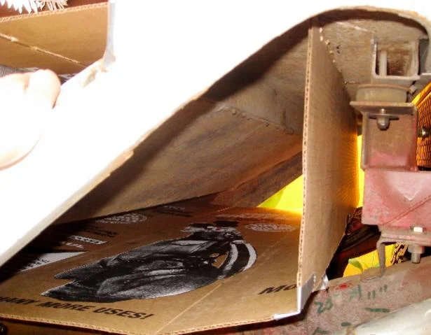

in preparation for our our second trip to Laser Cutting Northwest we are now building the mock up for the second fuel tank (pictured below). the card board pattern will be mailed to LCNW. this process will save us some time on the design.
the aluminum tank will have over 60 gallon capacity, it will be located "below" the rear passenger seat. as you can see by the drawing the rear floor will be cut out to accommodate the fuel tank. we will then build a sealed "floor" over the tank. the rear bench seat will lay over the tank on the "floor". i believe a gallon of diesel weight 8 lbs, so that the tank when full will be 480 lbs. i think the factory fuel tank hold 17 gallons, therefore, our total fuel capacity will be about 80 gallons. the factory fuel tank is located about 8" forward of the second tank we are installing. this will greatly lower the center of gravity of the cruiser.

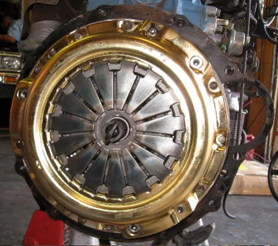

does anyone know the ohm resistance on the factory sending unit on a 1981 hj 47?
we are looking forward to our drive, and of course exited to arrive at LCNW in Auburn, Washington.
thank

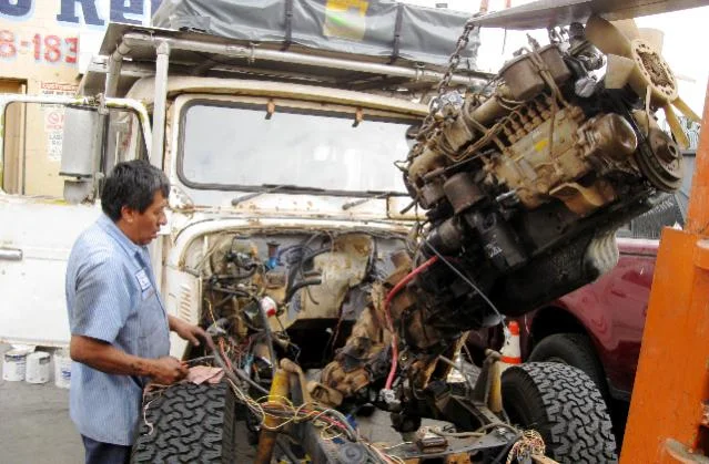

Talking engine conversion Day 1
Today we turned another chapter of the Nulla cruiser’s build. We began the day by picking up the 12 HT engine from the distribution warehouse in Compton, California. Edy’s Auto Repair & Auto Body will do the conversion. Nulla’s power plant will be replaced from the current 2H to a 12HT. Edy’s Auto Repair is located at 949 W. 66th Ave, Los Angeles, CA 90044 (corner of 66th Ave and Vermont) Phone # 323 758 1833 or IH8MUD Banner Advertising. Other conversion will include:
• 5 speed transmission
• Air condition
• Power steering
• Rear differential lockers from vacuum powered to manual
• Heavy duty clutch
The 2H engine, 4 speed transmission, transfer case and other accessories that we are removing from the Nullacruiser are for sale for 2,000 dollars. I have also posted on ih8mud classified here is the link http://forum.ih8mud.com/diesel-jdm-p...-etc-sale.html.
We will do our best to keep you posted on our daily progress. We look forward to working with Edy’s Auto Repair here in our hometown the City of Angels.

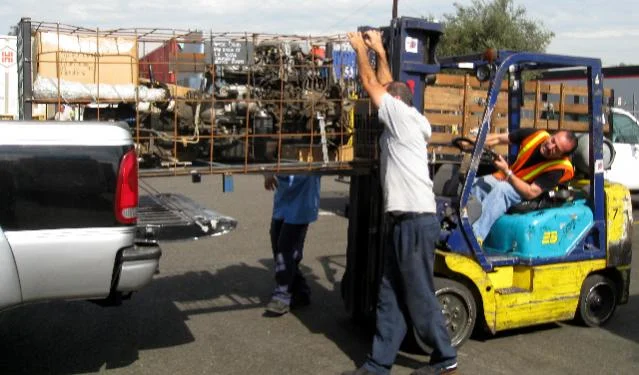

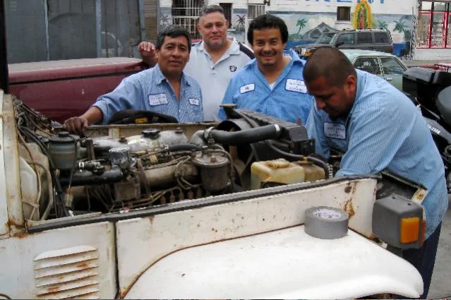

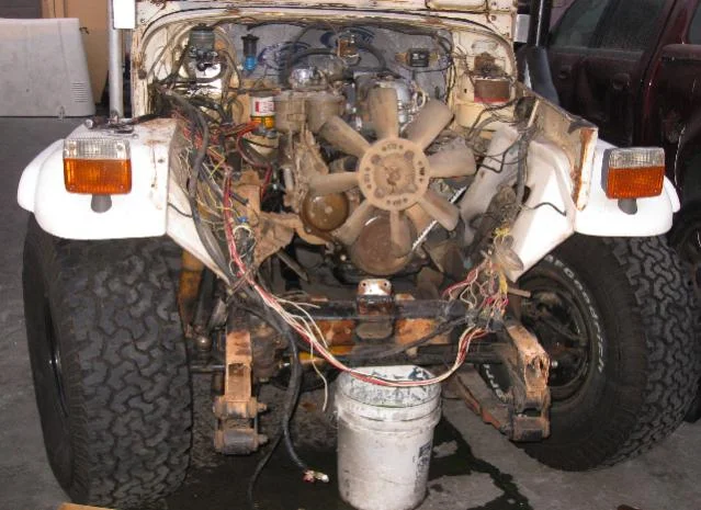

Talking engine conversion Day 2

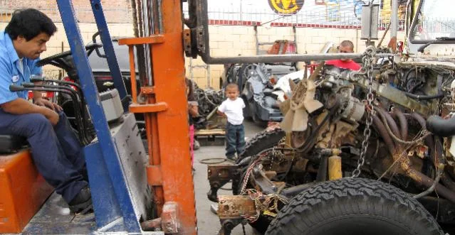

Today we started to break down and take Nullacruiser apart. Take a look at the pictures. Tomorrow we should finish and be able to take the engine out. We will begin to prep the engine bay for painting. Enjoy....

Talking Engine conversion day 3
The conversion of the Nullacruiser engine is now at the point of no return. It reminded us of last August when we took the rear cab off at Laser Cutting Northwest.
By the way if you like pupusas, tamales, champorado and meeting the Los Angeles natives you will like the corner where Edy’s Auto Repair is located. The corner is Vermont and 66th Ave in Los Angeles. 8 AM on a Saturday has it all. This morning I was there to start day 3 of the conversion and had the Pupusas. They were the best! The tamales are next.
Monday we will get the engine bay rust free and ready for painting

Today we installed the heavy-duty clutch, cleaned and sanded the engine compartment for painting.
The 2H has been sold.
Tomorrow we vote for Obama!!!!
thanks

Talking heavy duty clutch
Quote:
Originally Posted by roscoFJ73 View Post
What kind of clutch did you fit?
Bought it from Australia, here is the picture of the clutch you maybe familiar with it.
also because of yours and other suggestions i am not installing the intercooler at this time. i don't remember anyone on this forum that have done it on a 12ht, i am still interested on other experience about this, pls send me your comments, links and pictures, thanks.

Quote:
I think it is the same Exedy Sports Tuff clutch as I have but they have changed the color of the box from pink to yellow .
Im sure you will be impressed once your leg muscle get bigger
How many passengers are you taking?

Talking
i know i am probably overbuilding, but i do have a heavy rig, beside i need a bigger leg muscle
You are not overbuilding it with a good clutch like that. The last thing you want in a tight spot is a burning clutch.
__________________

We painted the firewall with marine grade paint, then after much research we decided on Second Skin for sound proofing and insulation. Thanks to Don Sambrook from Sound Deadener showdown Sound Deadener Showdown for leading us to Second Skin after reading Sound Deadener. Here is the product that we used Damplifier Pro then four coats of Firewall over Damplifier Pro. Here is the link to Second Skin Damplifier Pro - Acoustic Vibration Dampening Mat we want to give a shout out to Anthony from Second Skin for all his help and advices.
Tomorrow we begin the installation of the 12ht engine, enjoy .

Talking Day 7 of engine conversion
Day 7
We are excited to have set the 12 HT in the engine bay. All the engine mounts seems to bolt in except the right front mount. I am told by Edy that it is an easy fix. We are having fun here at Edy’s Auto. Below are pictures of Edy and Luis the “Los Abuelitos” (two old man).
Tomorrow we continue on the engine installation

Talking Day 8 of the build
The two front mounts are on, here is how we level the engine in Los Angeles, on 66 Ave and Vermont, see pictures.
