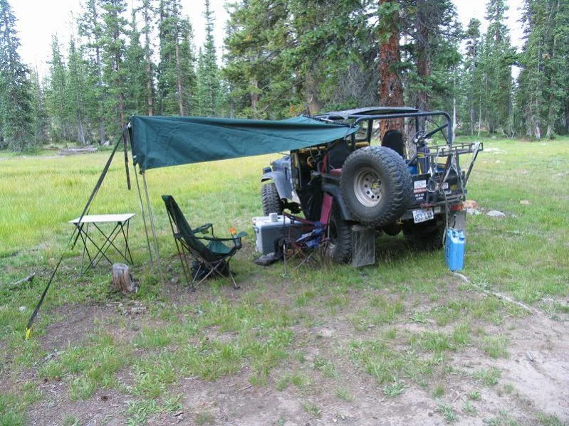

This one is inexpensive and does the trick:
I have a pic of one somewhere on my HD I'll try to find it and post later.

Not the best picture...

Here's what I built on my Sammi. Alum. foldout rafters that attach to the roof rack and then cover with a tarp. I ran out of time when heading to Moab so I just used cord to tie it to the frame. I'll add snaps to make it faster to install and tear down. Good luck!

Goofy shot, but a closer look at awning folded up.

this is my attempt. it removes completly when not in use and fixes to each end and the centre of my rear roof bar. mines used as a shelter from the rain more than anything. i've found in the past that flat sloping designs collect pools of rain water. of course you may not have this problem

The Sami's is essentially how Hannibal works, except the canvas ends in a sewn hoop the rod (Sami's angle iron) passes through, and is the exact length for a tight fit. Velcro straps sewn onto the canvas edges that wrap around the side arms tension things tight for wind. A cover is sewn onto the canvas with additional velcro and compression straps to roll everything up for travel.
Has zippers sewn onto edges for walls. Very good design.

Esh is correct....that was the base of the design, except I built it out of alum. Here's some pictures of the mounts and hinges. The first one is the front. The second is the rear and is pinned so the front out rigger can be tucked under the outrigger. I did t his because of the length of the outriggers. If they're both short then you won't have to do it this way. The blue bag on the RR holds the canvas top . Good luck!

would have to be really sturdy to withstand serious winds if cantilevered like the last pic above....

Awning
ARB, only had two plastic replacement parts, so I made one from hickory until it arrives. But these awnings look identical.

Very similar construction to ARB. Hear are pic's of Campinglab
attachments.

I saw a design this weekend that was really interesting...I don't have a pic but will try to describe it:
The frame consisted of a large hoop mounted to the rear of the rig. At the bottom of each "leg" was a pivot/hinge, so that the top of the "hoop" (think upside down U) could pivot away from the rig. Canvas was attached at the rear of the truck roof, and around the top of the hoop.
When the hoop was slanted away from the rig, the canvas "awning" extended and supported the hoop itself, providing a small awning over the rear of the truck.
Clear as mud, right....
