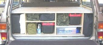

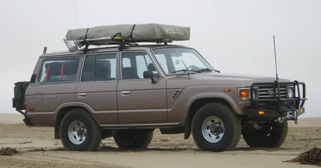

Hi Folks:
For those of you who did not get to see my rig at Surf-N-Turf, I thought I would post a few photos to share of my rig with a tuffy center console with a Dual Band Ham Radio and CB and the cabinets in the back I built out of birch plywood. The back has my camping supplies and stove plus my tool kit, spares and a fold-up toilet.

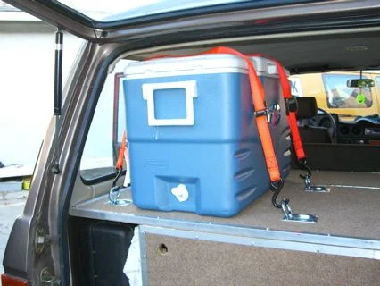

My Expedition Style '85 FJ60 Part 2

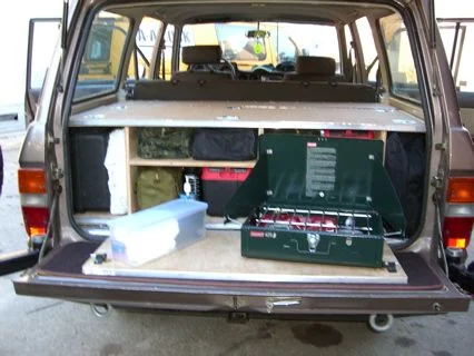

Here is the rear cargo area with my cooler strapped to the top so it won't visit me in front seat, and the behind the seat storage area for larger items with a latching hinged lid.
Enjoy, and if you have any questions about the build please let me know.

I saw it at SnT. Nice FJ60. I did not see the cabinet work inside-That's very nice. How did you anchor it to the floor/sides? Is there enough room to put a fridge on top of the false floor? Nice job all around.
The cabinet floor is bolted to the FJ body/floor with 3/8" Carriage bolts and large fender washers. The rest of the build is secured to the cabinet floor. A fridge might fit but I do not see myself owning one so I made it to fit the average 5-10 day Coleman cooler. Otherwise you can make it any height you want.
Mark

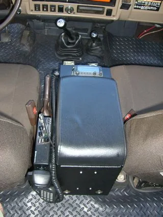

#1 how do you like the Tuffy Console? Is it worth the price they charge?
#2 Take some better pictures. I saw this first hand at Surf n Truf and your pictures are not doing it justice.

Old 11-19-07, 07:45 AM   #8 (permalink)
250+ Club
mrlocksmith's Avatar
Join Date: Sep 2007
Location: Redwood City, CA
Posts: 366
Close up of Cargo Area
Dan:

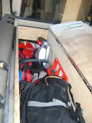

Here ya go. I hope this is better. Here is a shot with the back lid off and all the stuff stowed away. No fancy drawers to worry about just shelves about 22" deep so you can reach in and get what you need.
In my mind the Tuffy Console is worth it. My time would cost me more if I went though the trouble to make it. It was not easy getting a power dist box installed in there along with the remote mounted radio and two aux. power outlets. There just is not that much space to work in.

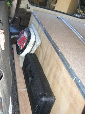

Here is the bumper. The photos are taken before the cabinet build and beforeI mounted the Hy-Lift jack to it.

I think I can put a keg on 4+ Rear Bumper, and run the tap though the cooler
Does that qualify as an "open container in the vehicle" HHMMM..........
My point about sliding drawers, especially those on ball bearings sliders should be repeated here for those who were not at SNT. Let me preface this by saying that my locksmith truck (Ford E350 Diesel) is built with 5 large rear sliding drawers on super heavy (300 lb capacity) duty ball bearing drawer slides. When parked with the nose of the truck going uphill the drawers really want to slide out quickly when you open them and they are hard to push back in. On level ground they are great. Granted I am not gong to load up my FJ with 200+ LBS of lock hardware, I still I did not want to deal with expense and hassle of drawer slides.
I have seen some builds with wood on wood or wood on nylon slides which would not be so bad, but then again, It is an added expense too.
Mark
If two drawers had identical weights in them and the angle of the vehicle was the same wouldn't the one with the higher friction slides (ie; the one without ball bearings) be harder to push back in?
Yes, the BB slides do roll out quickly when on a uphill slope but mine has a lockout feature so if on a downhill slope they can lock in the out position so they don't keep wanting to slide shut when you don't want them to.
I think the advantages outweigh the disadvantages after having used both styles.

Thanks on the truck comment. I might have gone with BB slides if I did not need a long locking compartment behind the back seat for my electronic prospecting gear. If I was just out wheeling and camping one long drawer would be fine.
Mark

My work vehicle (I really needa get some pics of this beast) has a set of draws that run all the way from the rear (hard up against the door) to the front (hard against the glove box and no front passenger seat)
The draws are on ball bearing sliders, and are great, but I echo your comments about parking on hills. I keep meaning to put latches on them to stop them slideing out.

that is really sweet. Although, it looks like your springs in the back could use some new friends to handle the extra weight...

I'm thinking airbags ?
