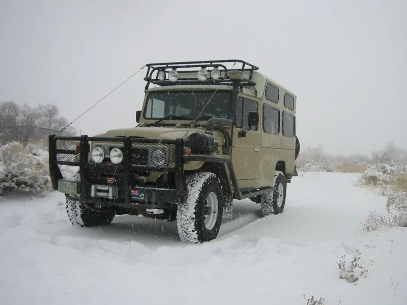

Here is a picture of my roof rack, mounting bracets I made and a link in my sig to more plus a plan (I think)

Great idea on the RR clamps! Looks solid!

Here are a couple pictures from this thread. I like the design and wish I could figure out what type of mounting brakets were used. Any ideas?

That whole rack is one-off, even the clamps. You'd have to duplicate them from scratch, or make long-distance friends with a certain fellow from Bolivia, hehe.

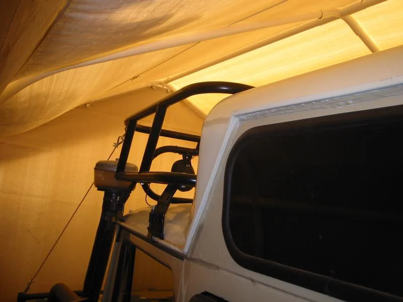

And sometimes you have no choice but to go custom. I wanted the rack to reflect the grille somewhat as well. My rack has 4 gutter mounts, but if I re-did it, I would use rails to distribute the weight more evenly. I've not had any problems yet, but I have carried alot of weight up there, and I think it would be better to spread the load.
