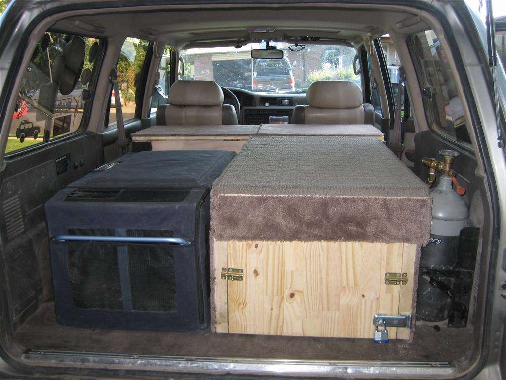

storage
I spent the weekend working on new storage for my truck. i sold my old drawers to a local guy a few weeks ago. i took a bit of a different approach to this build and had a few goals in mind when i started building.
1- simple. my wood skills and tool availability is limited
2- deck height. make it level with the fridge so in a pinch i would have no problems sleeping in the truck
3- save weight (my truck will be rather heavy once loaded)
4- i wanted to have enough storage to have everything locked up, nothing out and visible
So with those goals in mind I decided it was okay to lose a bit of storage space in lieu of weight savings. Because a set of drawers 18 inches tall would have been extremely heavy i decided to build shells for containing lighter weight containers. i know i'll be gone for almost 10 months but i'm still only one guy. i shouldn't need that much space.
i started with the box to run parallel to my fridge. underneath i'll be able to place 3 small action packers, or one small and one medium sized depending on how parts and tools shake out. these will contain emergency materials for the most part, alternator, waterpump, start contacts, birfield etc. the rear most action packer will probably hold my 'kitchen.' stove, dishes, spices, utensiles etc. above this i built a 6in deep box that should be able to hold longer items as well as more readily access items, pry bar, ax, camp chair, tow strap, d rings etc.
so...
The blank canvas...
the build...
in place...
i need to attach the gate latches but you can see the cover over the actionpacker area.
more to come.

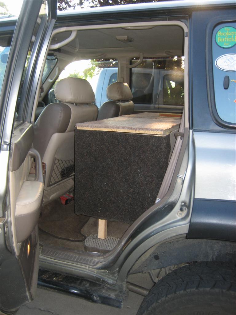

so as part of my goal to save weight and stay organized the box behind my fronts seats will again be little more than a shell for holding containers. after researching at Outdoor Retailers Show here in SLC i settled on these bags.
two of them (and thus 6 individual pods) will fit inside the box. this will allow me to keep my stuff organized and not buried inside huge duffle bags and still remain very light. clothing, camera gear, laptop etc will go into these bags or on top of them. i don't have pics but should in the morning of the brackets i used to secure this box using the rear seat mounting bolts.
the stucture...
with the bags installed...
now in the truck...
view from the front...
all loaded up...
i need to finish up the trim around the edges, add some handles, and carpet the rear box. then find a way to attach the 2 together for stablity purposes. luckily i have some nice washboard and potted roads nearby so after final assembly i can load up and go rally a few hundred miles and see how they do.
any comments would be appreciated. i felt like i was reinventing the wheel when it came to strengthening the structures. i'm clueless. i have a bunch of steel 90s i am going to screw into the corners to add some rigidity. right now the whole thing feels very stout.

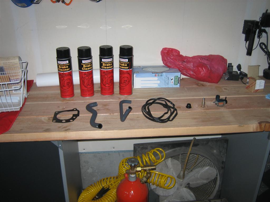

Quote:
Nice work table. What the knob for? Boxes look good dude.

Quote:
well you know, why would i want a flat work surface when i can use an old warped door?

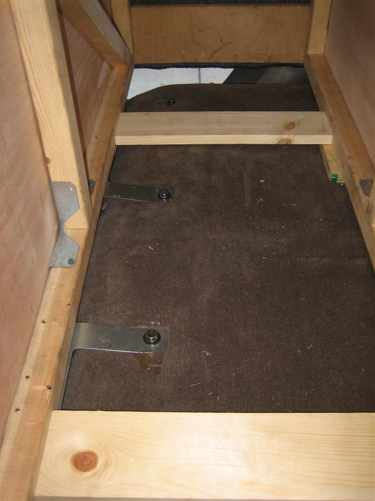

well i'm pretty much done. i need to add some rope handles to each lid but for the most part time to move on to my oil leaks and 4:88s.
carpeted and locked at the back...
the brackets i used to bolt the front box to the floor. i think they are thin enough that they will flex but rigid enough to keep the box secure...
and finally i added some legs for a bit more stability.
if time allows i will be adding a book shelf to the front of the box for my guide books and 'escaping from central american guerilla camps for dummies'

i've added one last item to the boxes. designed around my huge stack of lonely planet guides but will work great for recreational reading too...
just a little bookshelf to fill in what i thought was wasted space behind the front seats.
dmc
dmc is offline   Reply With Quote

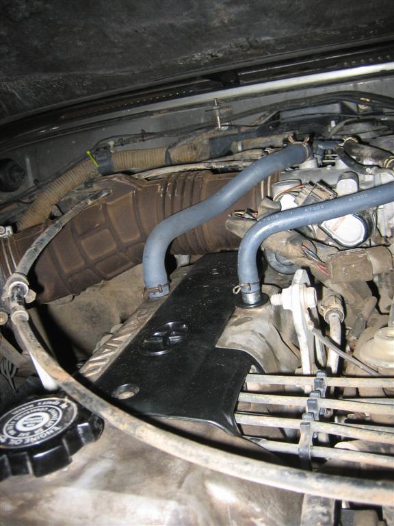

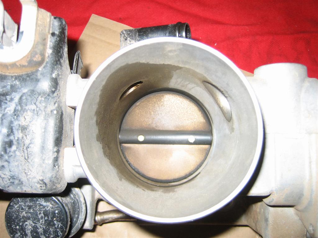

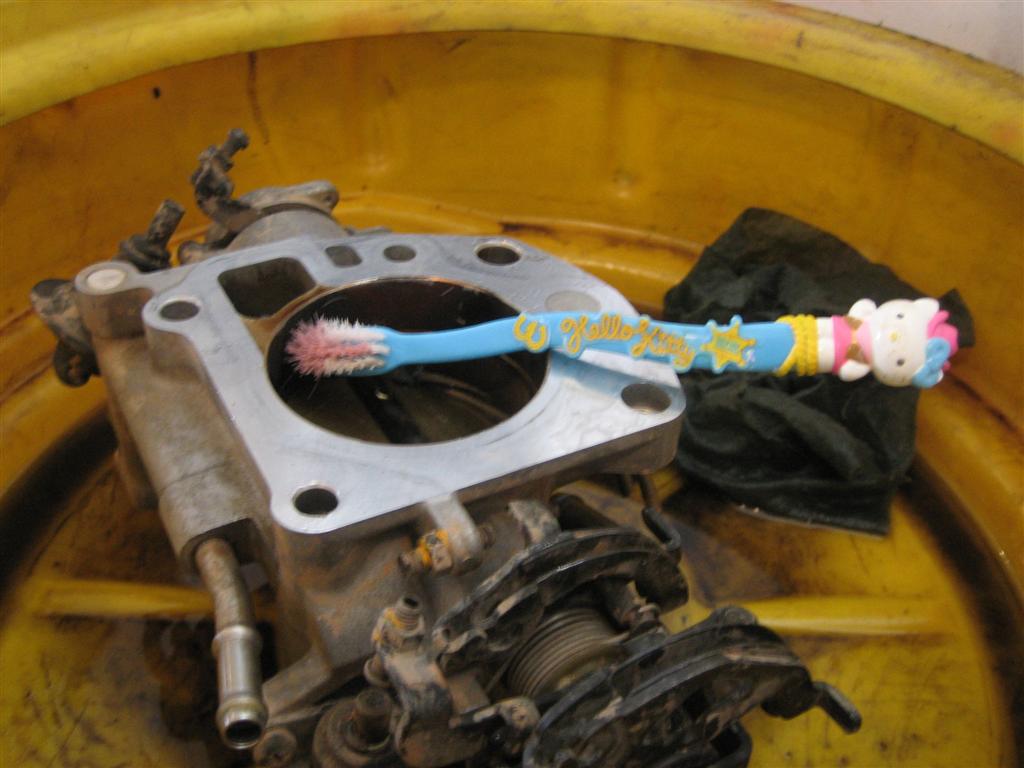

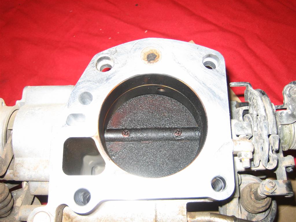

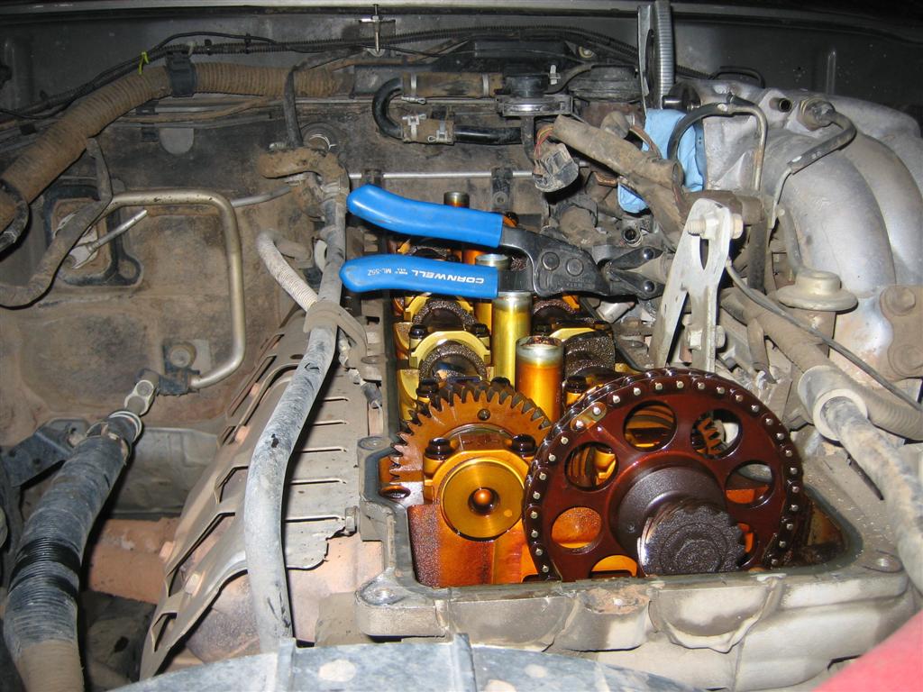

another solid weekend
did some more PM on the truck this weekend...
valve adjustment, actually just checked the valve tolerances. all were within spec...
next came the throttle body. it was filthy. before and after with brake cleaner then the hello kitty brush to finish up...
not pictured but also done was the EGR VSV and new valve breather hoses...
5 weeks from tomorrrow i hit the road. oilpan gasket, fan clutch, 4:88s and all fluids is all i have left on the plate mechanically.
dmc
